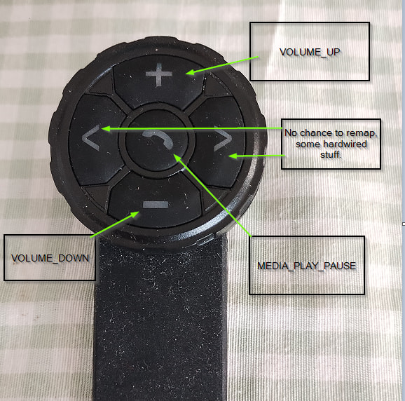

I have bought this for the bicycle. In combination with the app ButtonMapper I could figure out the keys, this remote sends. The volume buttons must be remapped, as you and Robin already said.

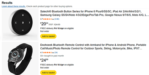

I have seen such remotes just for media (not phone as this remote). I did not bought or tried, but my expectation would be, that you have more buttons, which can be remapped.
Something like this:
But yes - if activated the media buttons in Kurviger, the map zooms with plus and minus.
When you remap in ButtonMapper the MEDIA_PLAY_PAUSE, then you can even reset the zoom (this 20 seconds button).
