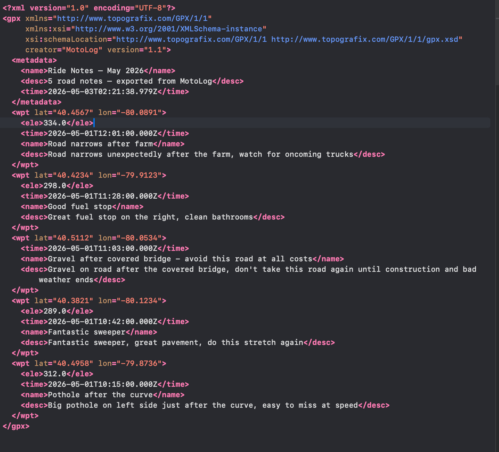

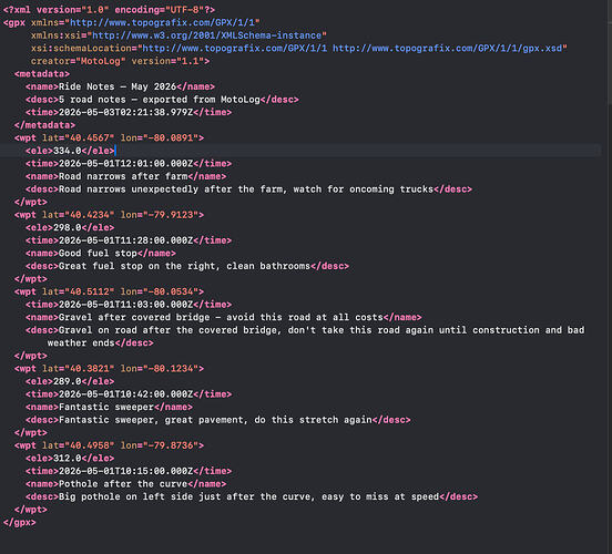

I’ve been iterating on the GPX output and attached an example file. Notes are editable after capture so I can clean up transcription and keep titles short enough to display cleanly — but the full description lives in the <desc> field.

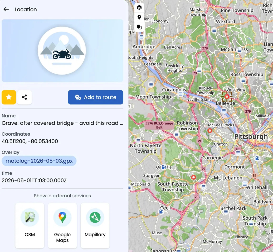

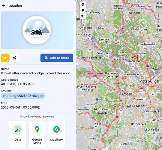

Which brings me to my question. When I load the overlay into Kurviger web, I can see Name, Coordinates, time, and the overlay source — but <desc> doesn’t appear to be surfaced. If I’m generating the GPX incorrectly please let me know and I’ll fix it — but if <desc> simply isn’t displayed, surfacing that field would make a significant difference. Even just as a scrollable text block in the location popup would give riders the full context of what they captured.

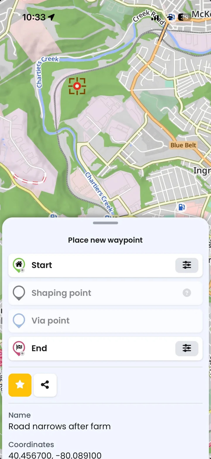

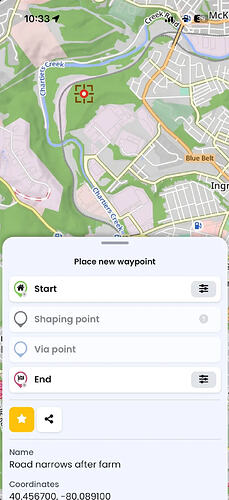

  • On mobile, tapping an overlay pin seems to trigger the “place new waypoint” flow rather than showing the location detail — unlike native Kurviger POIs which do load a detail view. Is that expected behavior or a known issue?

It worked in the past - I had a similar issue, description was displayed, but links were not clickable.
And I am quite sure, after a modification (of Kurviger, not of GPX) done by @boldtrn links were clickable.
Edit: Please see also answer #5 in thread linked below.
I just checked the old, uploaded GPX: Links are even not displayed any more :unamused_face:
Ah ok, it seems that this feature was lost when we introduced the new importer or the new overlay manager, bot where not available several years back when we added the clickable links. We will have a look at this.
Hi Abe.
New comments in the thread you linked.
My proposal for now is to fill field cmt as description as comment is shown in overlay.
Possible links must be in this format to be clickable.
<link>https://wikipedia.de</link>
