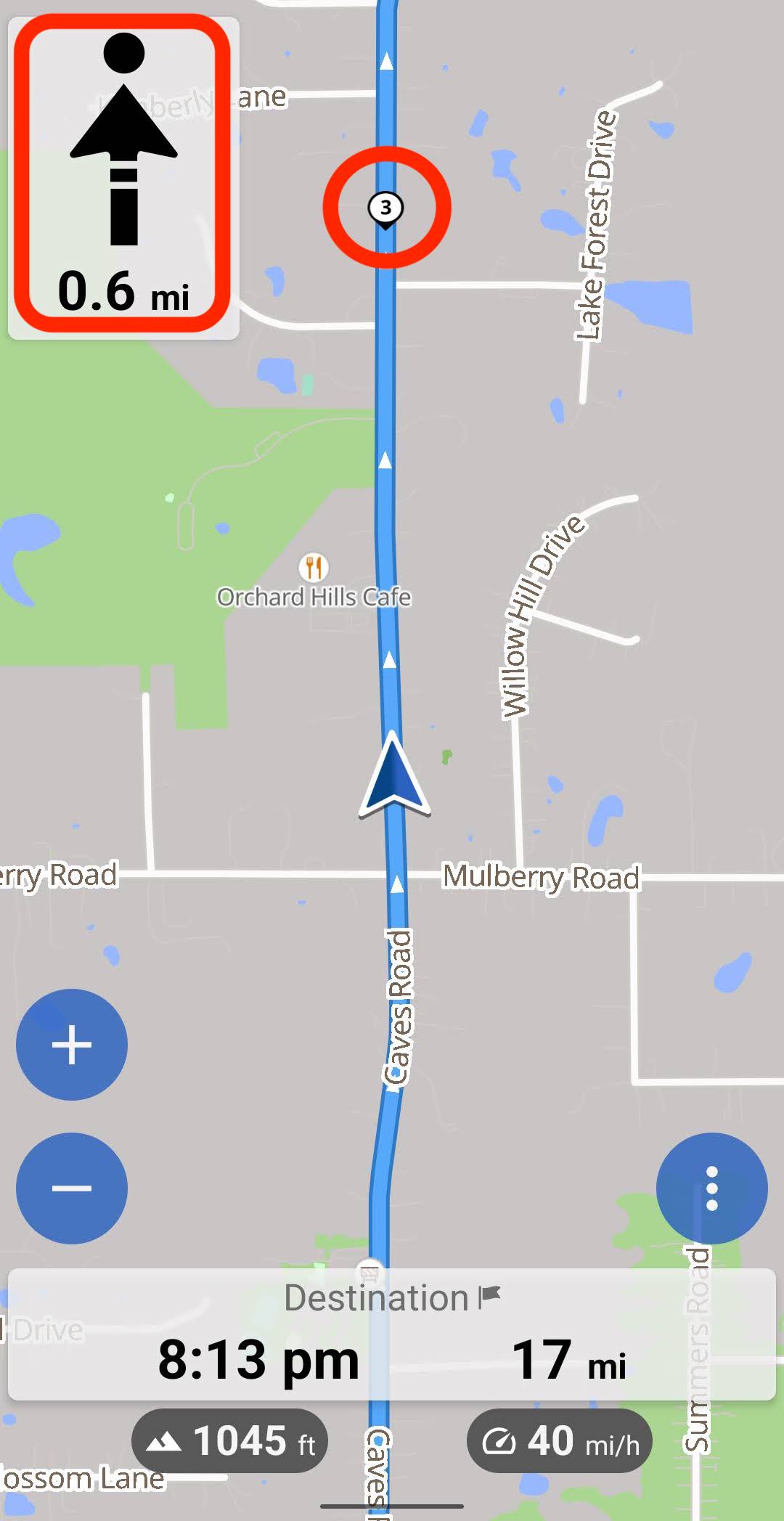

On the new K3 app, I see distance updates relative to shaping points. I would like it if I only saw distance updates for the next turn or action (not shaping points). Is that possible? If not, I would request that the team considers this option in a future release. When I’m leading a group and giving updates, I like to be able to look down and quickly see how far it is to the next turn (or action), and the Shaping points interfere with that.

I do not think, that this interferes. In your case it is easy. You reach the next waypoint/destination at 8:13pm in 17 miles. In case you would have more via-points the lower bar would change to time and distance to the next via-point. The upper left box would not show you the distance to the next via-point or destination, but to the next event like next crossing for example.

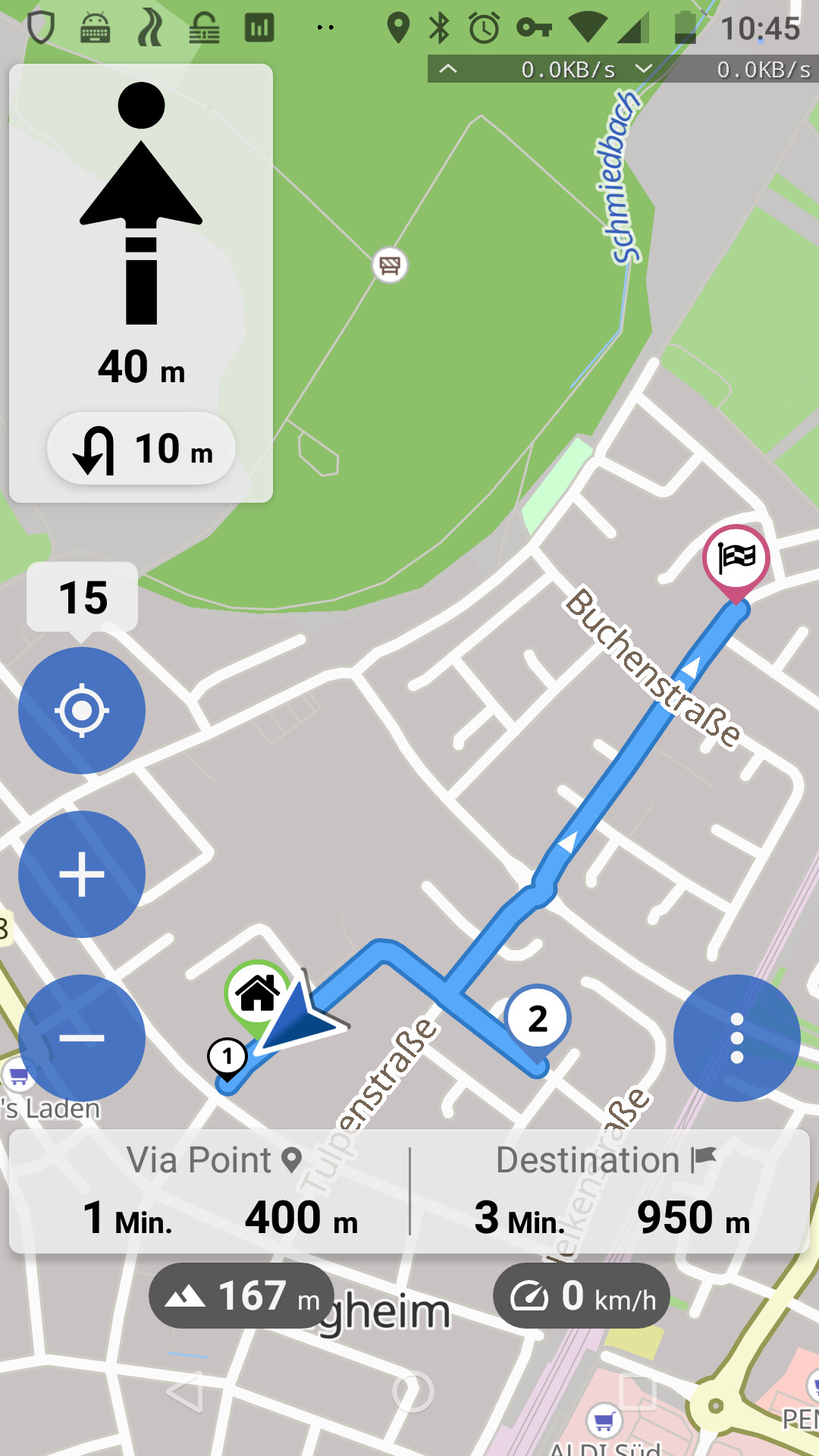

Here you see the shaping point is in 40m, but next waypoint in 400m.
If the shaping point should be announced or shown at all is a general question. For me it is fine.

@Toffel and @Motobylette - Thank you for jogging my memory. I was mistaken when I worded my post. I knew there was a reason the Shaping points interfered, but forgot that it was with the “next turn” distance. (I edited my first post to more clearly communicate this.)
When I am with a group on a specific route that has off road sections, the creation of that route sometimes requires a lot of Shaping points. When we are riding, we often want to know how far it is to the next turn, because that is likely where the section of road will change again. But when the app is giving updates for every Shaping point, it interferes with knowing how far until the next turn or “real” action.
