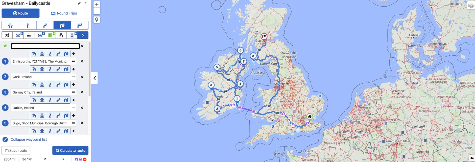

Sure. This is what I mean –

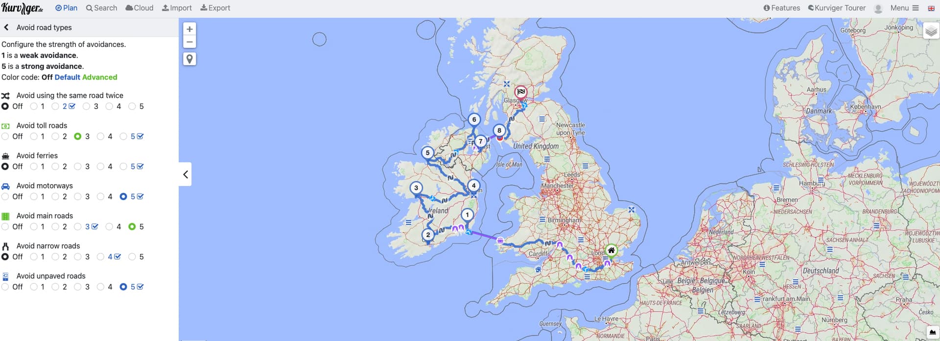

You have activated all avoid options besides “avoid ferries” - this leads to the large detour.

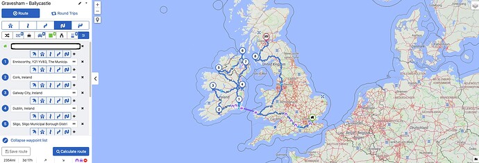

Switching of all avoid option improves the route:

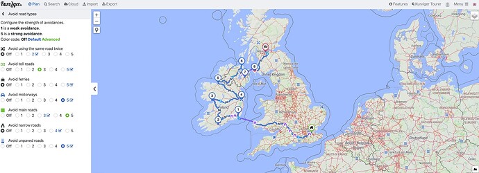

Yeah, that works. I can untick those options, and the ferry crossing will appear, as I want it to.
But I want to avoid highways, major roads etc., so at some point, I need to reactivate those options, and when I do, the route is automatically recalculated, and the ferry crossing vanishes.
Please see screenshot.
These are the options that I had to select, to get what I needed. Leaving ‘avoid motorways’ unticked wasn’t an option.
