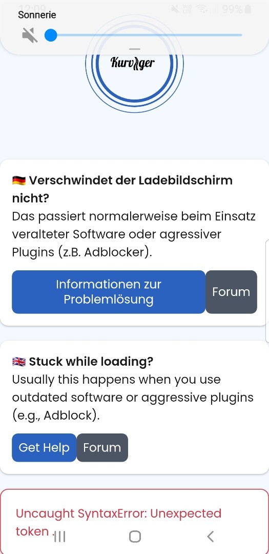

Hello
Sorry for my first post, it was a test and was published too quickly from my smartphone.
Here is my problem:
Kurviger was installed on my daughter’s Galaxy s8 to see how it worked and it worked very well.
My daughter reset the smartphone to 0 before giving it to me because it will only be used for kurviger
And then, problem, impossible to open kurviger after installation
I should point out that the Galaxy S8 is in standard configuration and nothing has been done other than to download kurviger.
thank you for your feedback
Gil
As your screenshot suggests - you are probably dealing with the outdated software (not Kurviger app, but supporting software).
If the phone was reset to the factory settings, that probably teleports you some 7-8 years in the past, when the S8 was released.
So, first thing to do would be to apply all system updates and updates to all preinstalled apps. I would focus on updating Google Apps and Services, but maybe developers could tell you what else may be essential.
Yes, that’s it, it’s most probably either Google Chrome or “Samsung Internet”. As one of these will provider the Android Webview that is required to launch the Kurviger app.
Hello
thank you very much, in fact an update of the google apps has solved the problem
