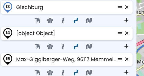

Function Transaction.set() called with invalid data. Unsupported field value: undefined (found in field waypoints.14.name.key in document paths/nUgNKlkyzH4LJpfpyP9w) - Code:invalid-argument
Device: samsung - SM-G970F - Android: 12 - WebView: 135.0.7049.111
Screen: 360 x 760 px - 3dppx
What about the 14th waypoint?

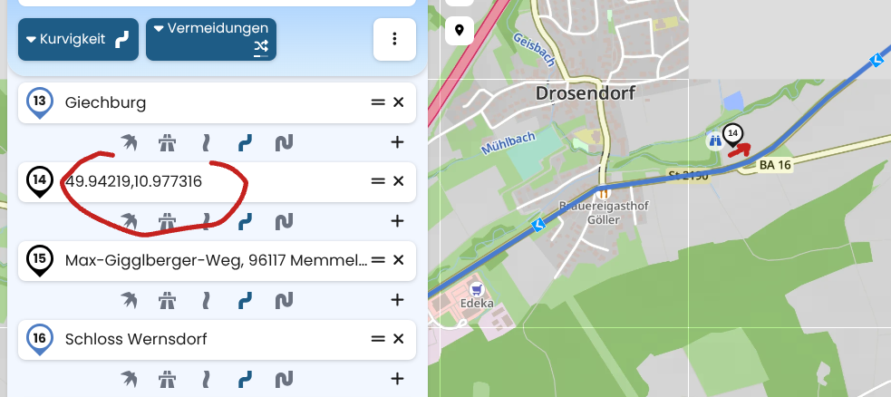

If I see this correctly, you have turned a favourite into a waypoint, right?
Please place the waypoint next to the favourite. Maybe then it will work.

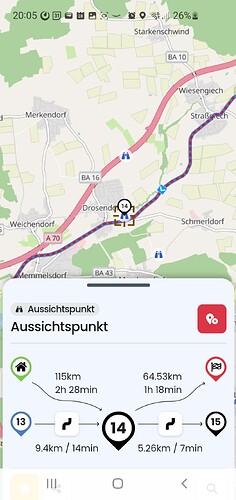

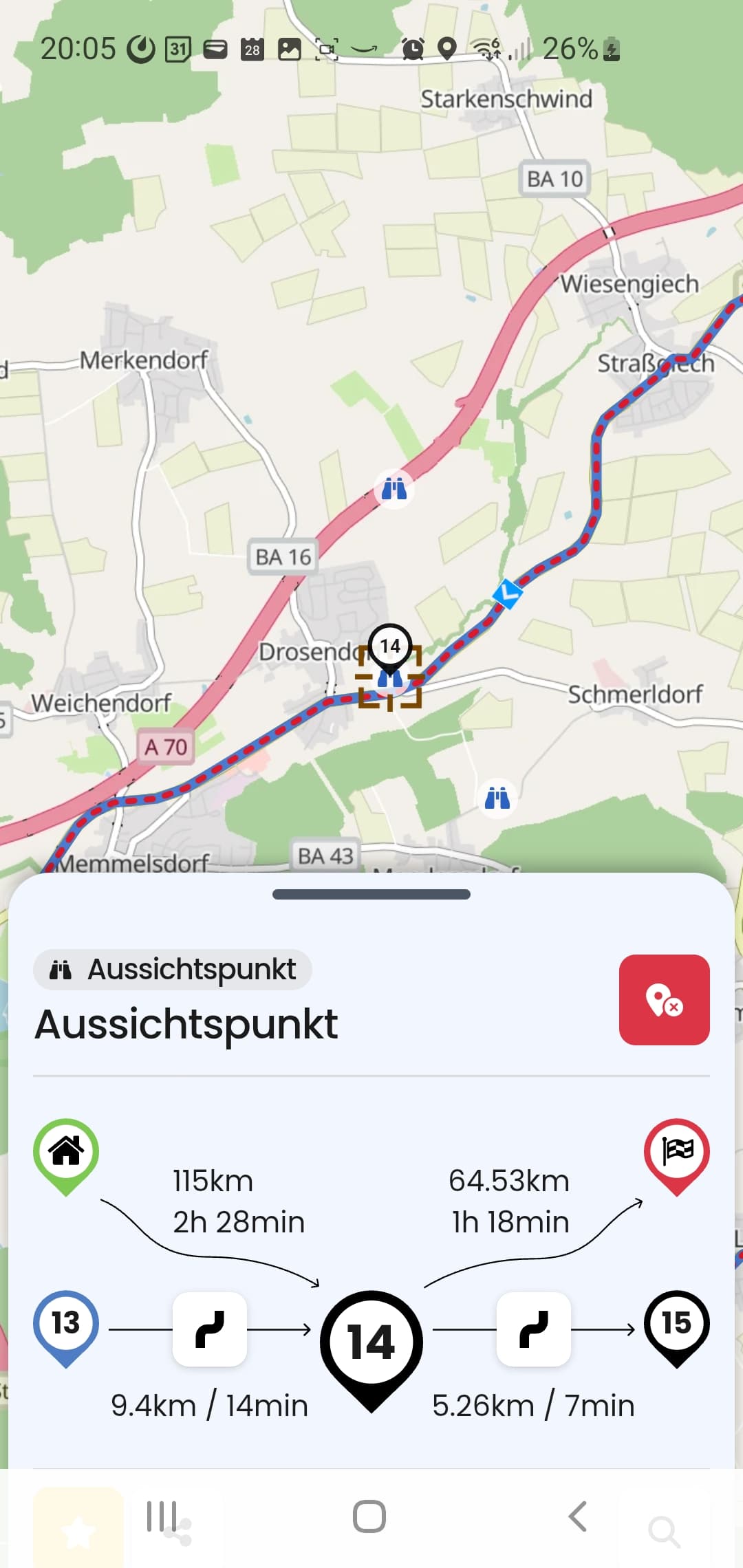

No. I picked all the WP by tapping directly on the map. WP14 was a Lookout POI, as shown in my screenshot. I did not assign or change any of the WPs names manually. Most of the WPs are POIs, some of the SPs I put on the street to enforce a specific road.
Please place the waypoint next to the Lookout.

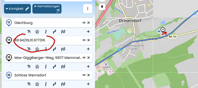

the Waypoint list has an error at WP 14 (see above), so I think, you have to move thist point. Just a try… :wink:
NOW you can save your route! :slight_smile:

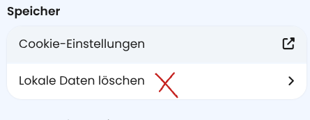

Did you also do this here?
That apparently helped to prevent the problem from reappearing.
