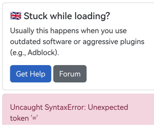

I have been a loyal user of your services for some time, and recently, I made the decision to support you by subscribing to the Tourer+ plan. After completing the subscription payment, I downloaded the new app version 3.2.1. However, I am encountering an issue. Upon opening the application, I receive the following error message: “Uncaught SyntaxError: Unexpected token =”. You will find a screenshot attached.
I followed your advice by updating my Google Chrome browser, checking for updates on Google Play, and ensuring that my smartphone is up to date. I do not use a VPN or ad-blockers, yet the problem persists. I even tried uninstalling and reinstalling the application, but the result remains the same.

Hi Alizee, this is indeed a bit weird :thinking:
Unfortunately I cannot find your error in our bug reporting tool, so we’re poking a bit in the dark, but ok, we’ll manage.
First of all, could you please find also your so called “WebView” version for me?
For that, you go to Settings → Apps → All apps → Find “Android System WebView” in the list or search with the search icon at the top right
The version number will be at the very bottom

Hi Patrick,
I followed your instructions and realized that “Android System WebView” was not available on my smartphone. I don’t understand why…
So, I downloaded the latest version of Android System WebView and restarted Kurviger App 3.2.1.
This was a success. I can now enjoy using it! I’ll be able to explore the roads of the French Alps through the app’s navigation. Hooray!
