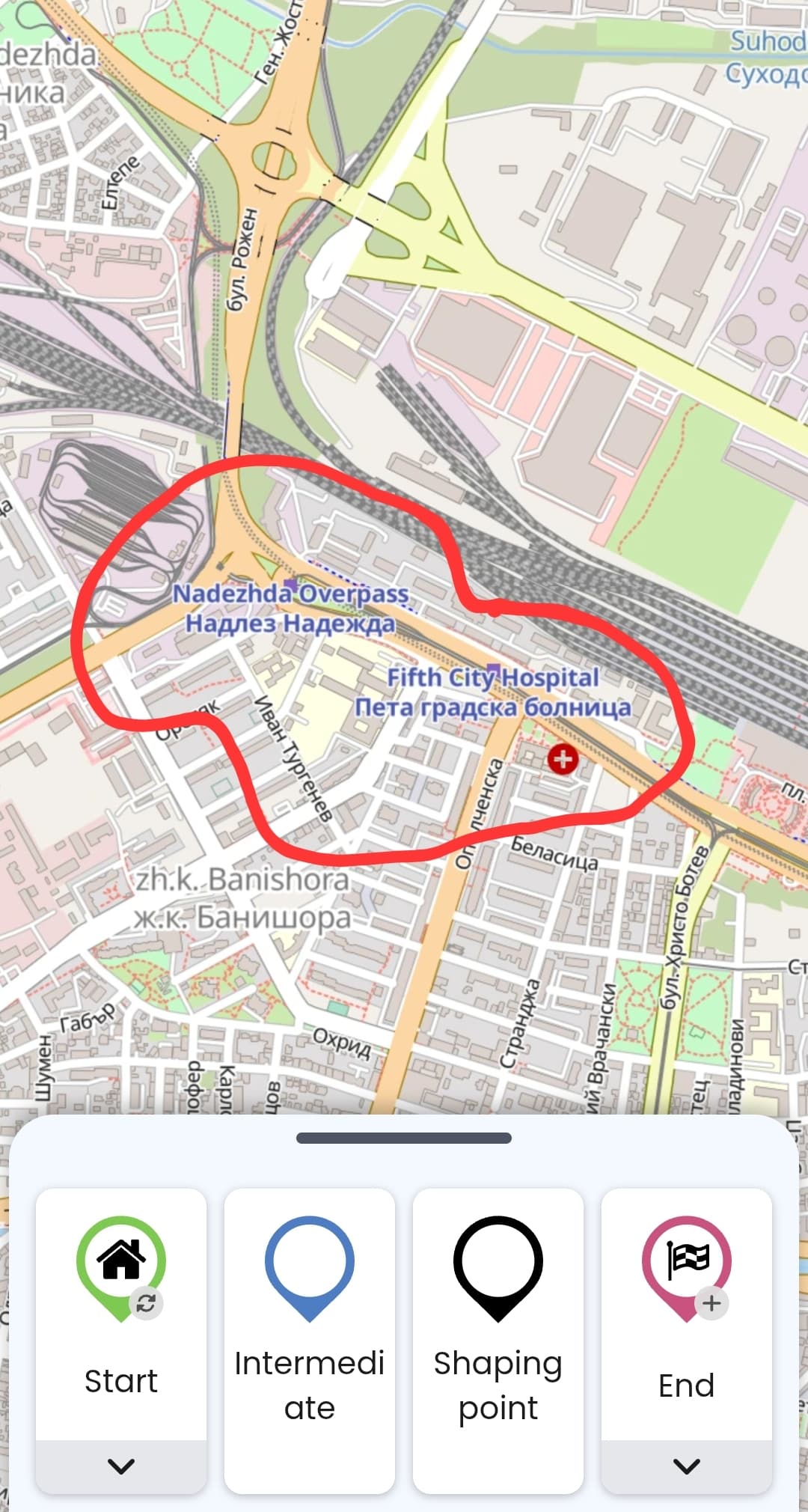

You mean something like these names:
For this, you have to use the maps that have both languages on your Garmin device and/or app. Is your device and/or app set to English or German? If it is in German, try setting it to english.
