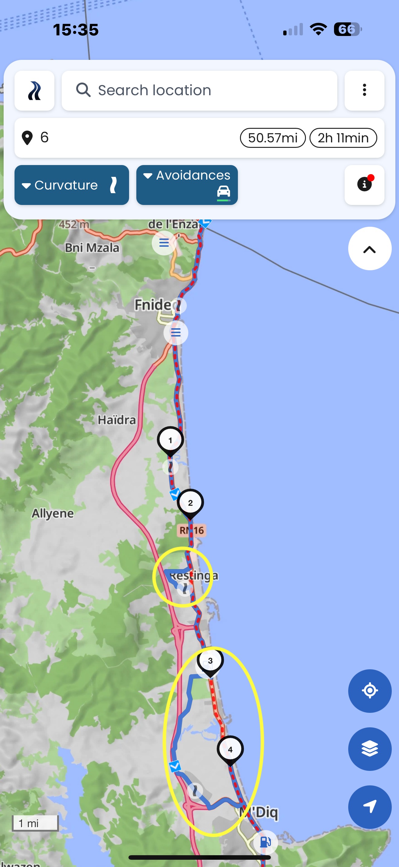

Can I ask why the application behaves so confusedly and tries to avoid the usual nothing special road at all costs. And sometimes the application takes you offroad even though you have set the fastest route in the application.
Usually because there is an inconsistency in OSM data. It would be helpful to post the links to your routes together with screenshots, if you wish someone to have a look at it.

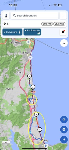

I guess for the first issue (SP 2) is that only bicycles may use it. Perhaps compare pieces before and after.
Second - same (SP 5).
This is what I thought. But why doesn’t it exit this road on the previous roundabout. also before it is tagged as bicycles only.

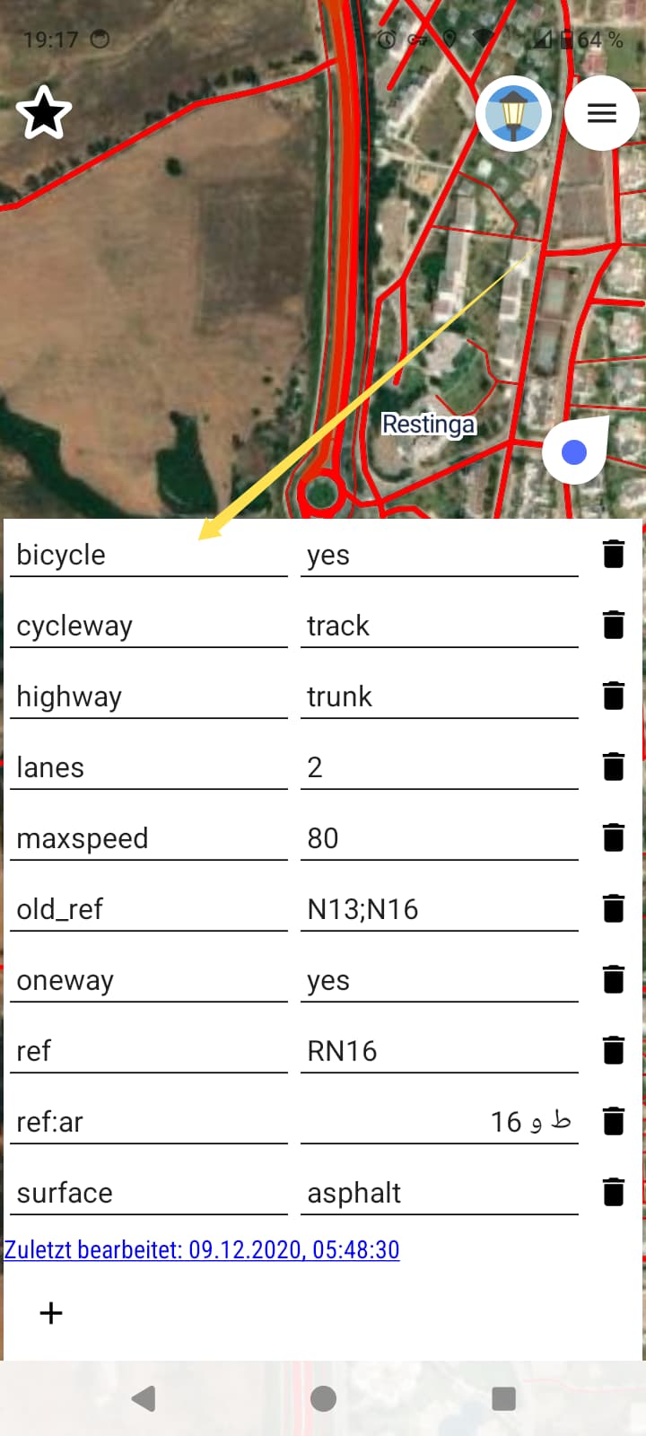

I think the bicyle = yes is not necessary. I guess cycleway=track is expressing this? Found nothing in OSM Wiki saying that additional access tag is required.
motor_vehicle = yes should also work.
@linux-user must decide. :joy:
I don’t think that it is related to the access tags.
Neither cycleway=track nor bicycle=yes should hurt.
I don’t think that motor_vehicle=yes would help either.

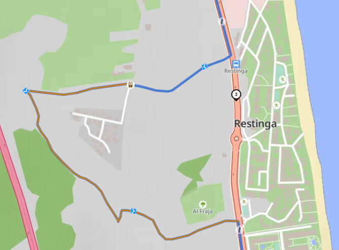

This route works up to the end - but not further :thinking:
There must be something else that is blocking the route.
And here from start onwards it is working again.
And here at the end it is blocked again
This roundabout is completely tagged with motorcycle=no:
And also this road:
I have some doubts, if that is right - but I am not sure …

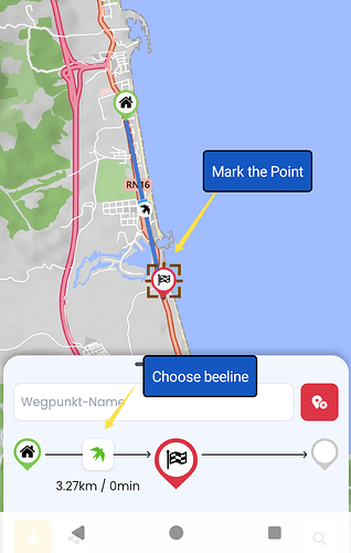

As above it is possibly caused by a data issue in the OpenStreetMap data. You can connect two points with a beeline. Usually used for offroad sections.
An other mapper solved my notes in OSM, but the route still has a suspicious deviation, because there was a further isolated roundabout with implausible tagging “motorcycle=no”:
I removed that tags, I think in a few days the route of @ThinkBike will work properly …
