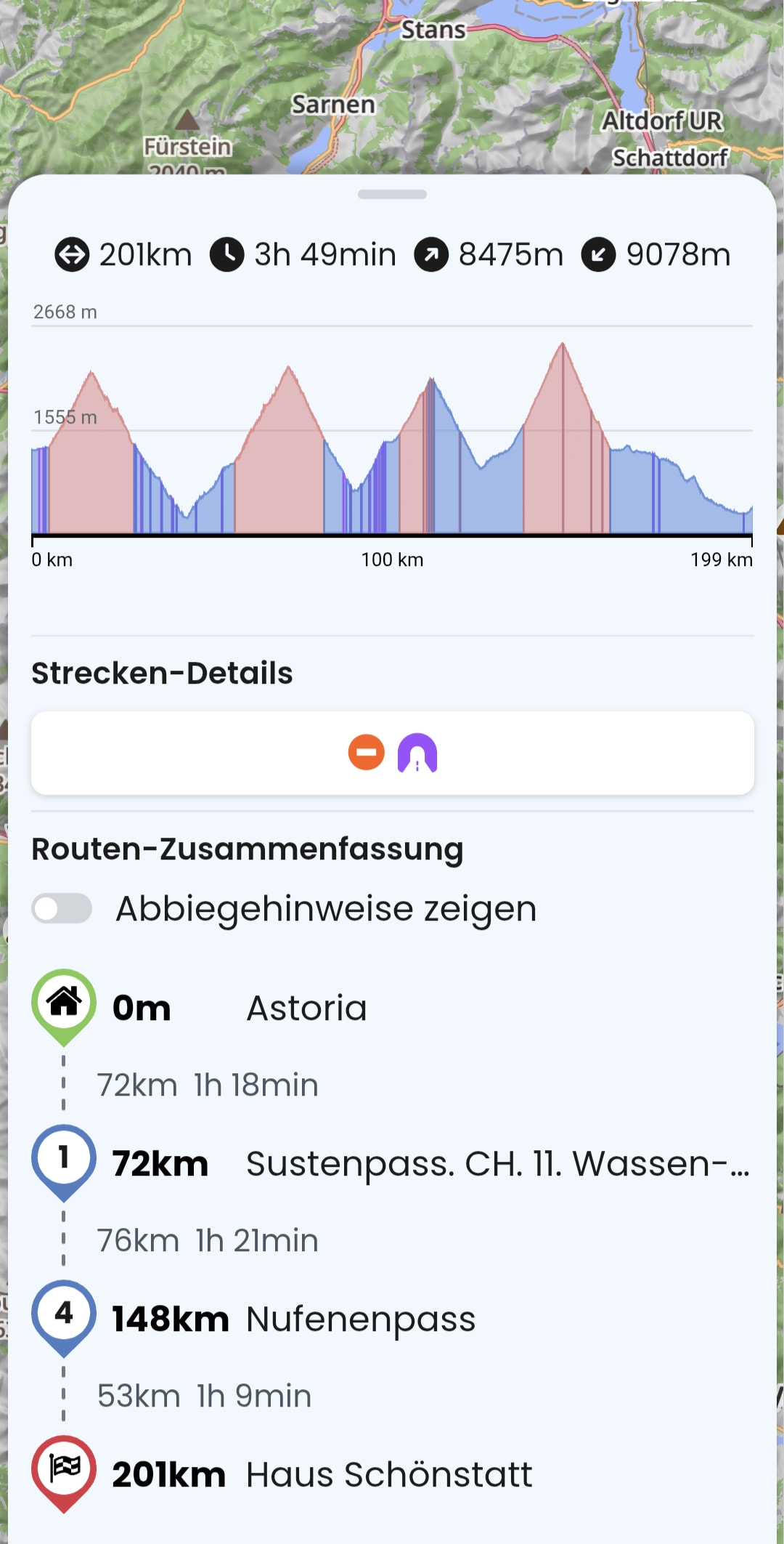

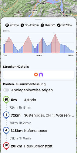

It would be nice to have a route report showing the waypoints, distances, and times.
You can view this information for each waypoint by selecting it, but to get a summary, you have to open them all and note down the data.

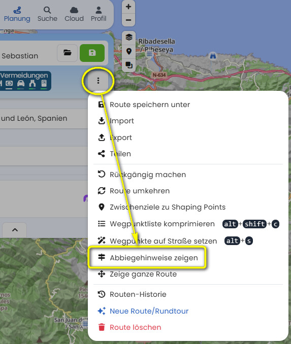

There is a rudimentary way to do this: in planning mode, click the 3 dots, then click “show turn instructions”

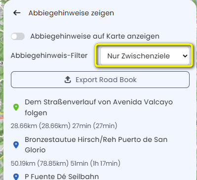

Select “via points only”, and you will get an overview
With “Export Road Book” you can process the data further, for example with Excel.
However, this method only refers to the currently loaded route.
