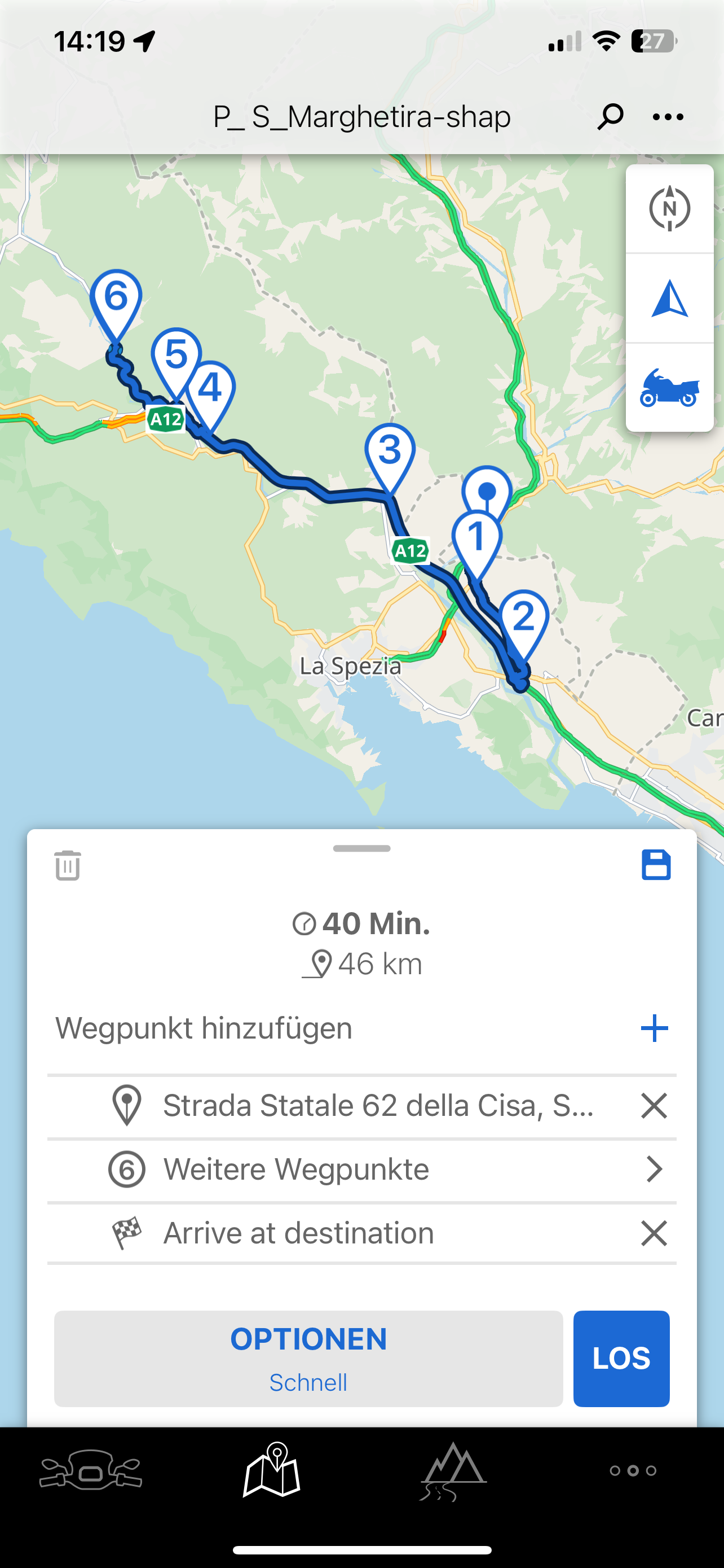

I export the route to be taken with the bmw app like this:
but with the gpx track created with these modes, the bmw app gives me incorrect and often dangerous information (e.g. making U-turns on motorways), the same route created with a different app on the other hand does not give me any navigation problems.

Okay - so you are using the BMW Motorrad Connected App ?
But it couldn’t be the tour from you screenshot

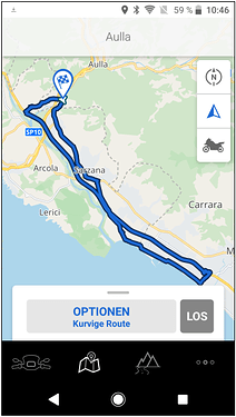

This morning before setting off when uploading the route, I realised that the tracks generated by Kurviger and not processed by basecamp, the bmw app sees them as xml files, whereas if they are processed by Basecamp the bmw app sees them as gpx files:
Where comes this screenshot from? It seems not to be the above mentioned BMW Motorrad Connected …
I’m curious and installed the BMW App (even I can’t connect it to my bikes) and your Aulla.gpx file works fine:

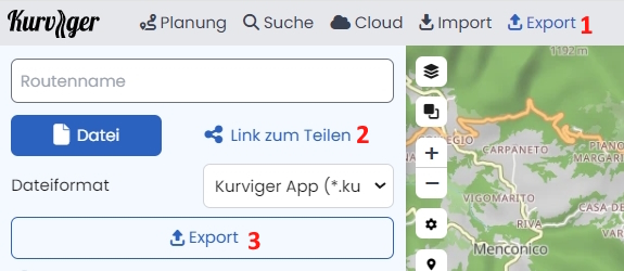

Btw: “A lot” in “Additional Waypoints” doesn’t do anything if you didn’t select Route in “Export of”:

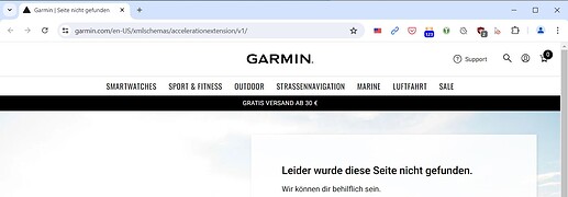

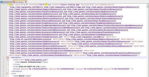

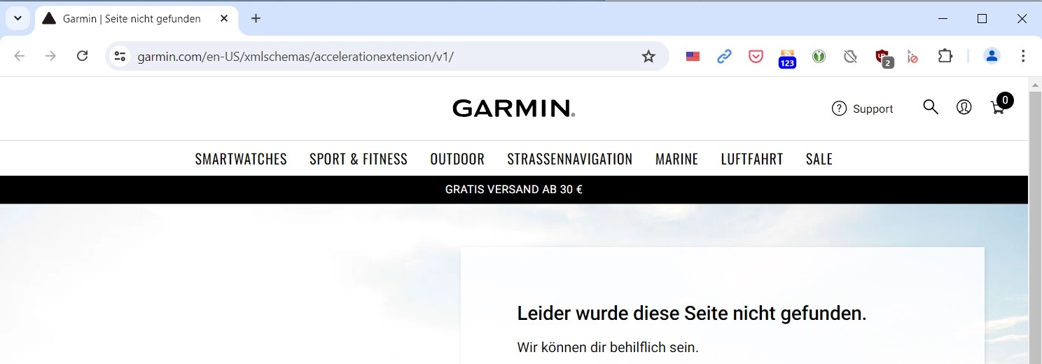

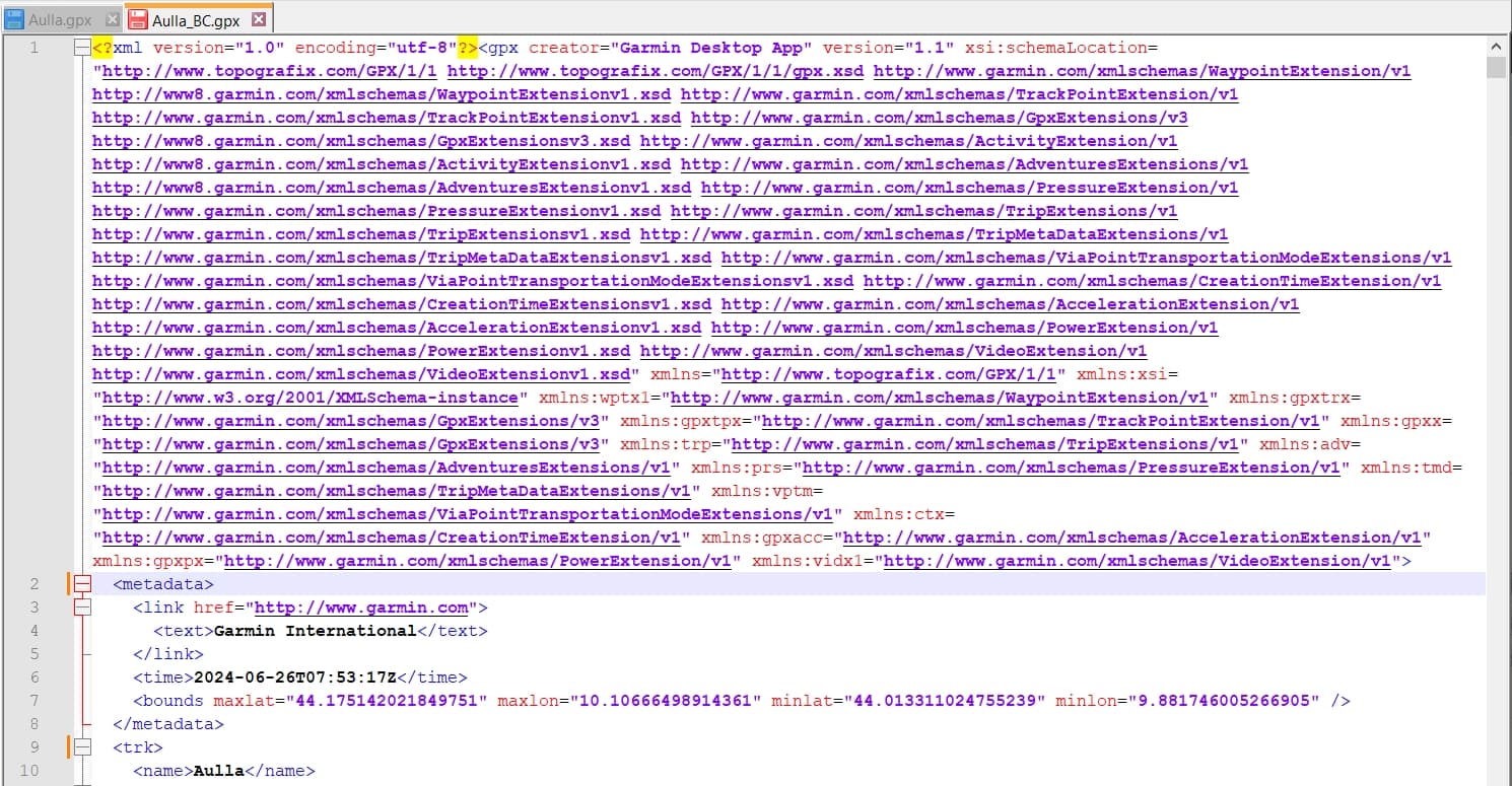

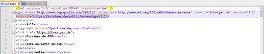

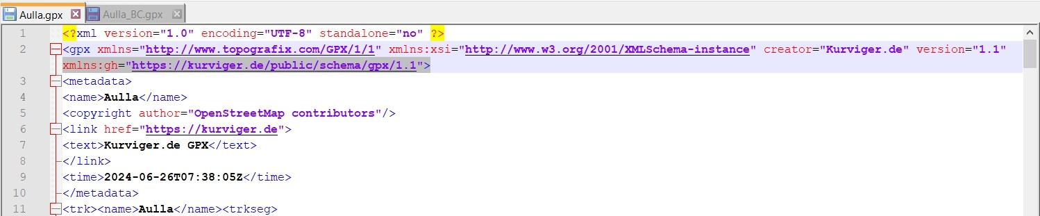

In the course of analyzing this “GPX track problem”, I looked at the header of the files from Kurviger.de and BaseCamp and discovered that the Kurviger file contains an URL that does not exist:
(xmlns:gh … GraphHopper?)
BaseCamp is much more “chatty” and has also defined some wrong internet addresses (I stopped after 3 errors):
But use this for acquisition: :roll_eyes:
Links in XML don’t mean anything other than being “name spaces”. So you could add anything random, as long as it’s unique.
The use of URIs taking the form of URLs in the http scheme (such as XHTML namespace) is common, despite the absence of any formal relationship with the HTTP protocol. The Namespaces specification does not say what should happen if such a URL is dereferenced (that is, if software attempts to retrieve a document from this location). One convention adopted by some users is to place an RDDL document at the location.[5] In general, however, users should assume that the namespace URI is simply a name, not the address of a document on the Web.
