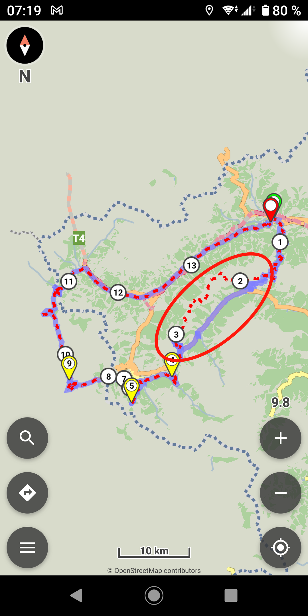

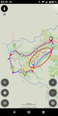

i created in Kurviger pro on the Handy a route over Assietta. When i import the route in Windows, the overlay goes over Assietta, but not the route.

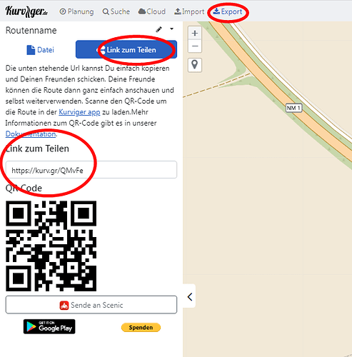

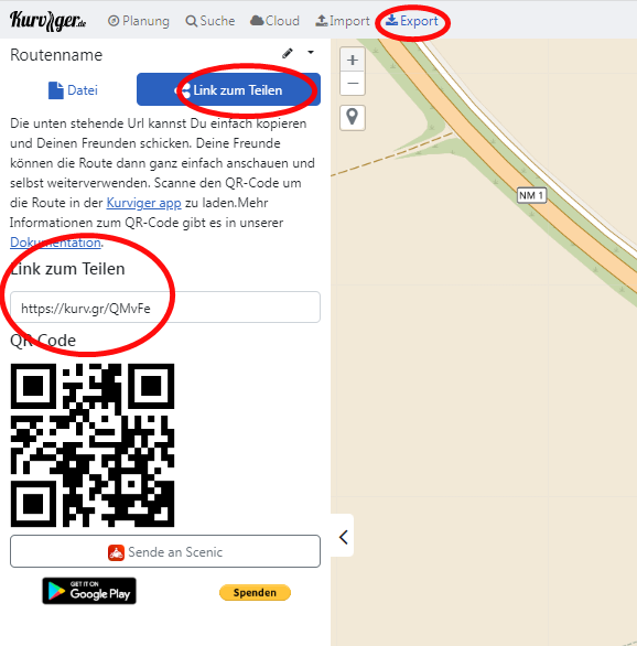

Documentation about export / share routes:
At first i exported the route in the apps with the function “Export”

The .kurviger file is imported “correctly”, that means without recalculation of the route. But if you move e.g. only the waypoint 11 a little bit and initiate a recalculation you get the same route as in kurviger.de:

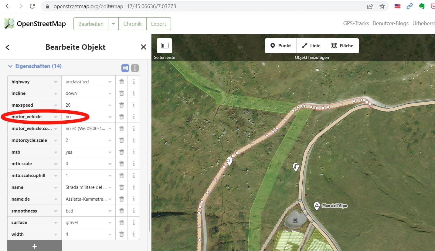

Probably the export was done some time ago, under “old” parameters in OSM. There, it seems that “motor vehicle=no” has been added recently - which is definitely wrong:
I just took the liberty to correct this …
  • App imports kurviger files offline without route calculation
    → no route changes
  • Website imports kurviger files online with route calculation
    → possible route changes
