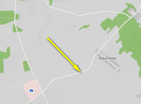

I’m not sure if I’ve got this right, but here’s what comes to mind:

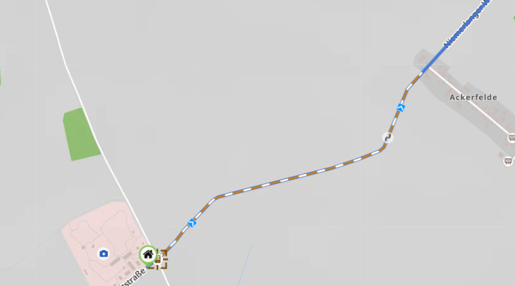

I once looked for a route that met the same criteria, partly off-road, partly paved. It looks like this on the map:

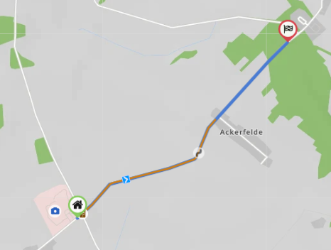

When I plan a route along this road, it looks like this:

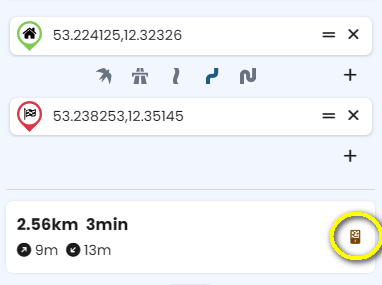

The off-road icon in the waypoint list indicates that there is an off-road section on the route:

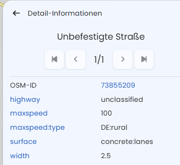

When you click on it, it is highlighted as follows:
and the detailed information appears on the left-hand side of the window:

Unfortunately, the maps do not show whether the road is partly paved and partly unpaved.

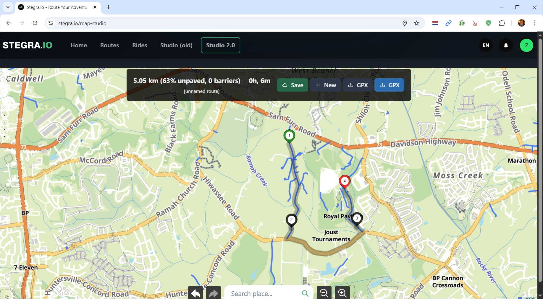

Here two different websites with the same area in North Carolina:
Rather inconvenient for route planning - better suited for checking the condition of a road in detail.

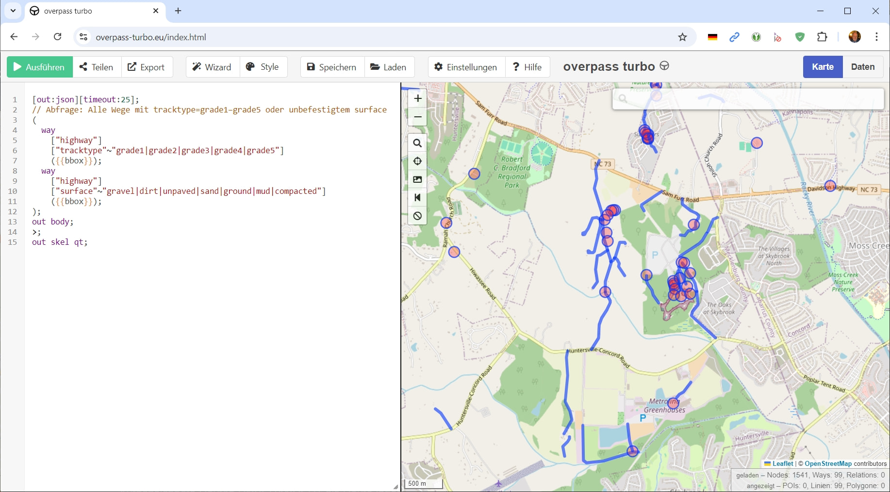

You could use overpass Turbo, here are some explanations:
Maybe @rumbrummer could help you with a query.
Thanks. That looks like quite a learning curve.
