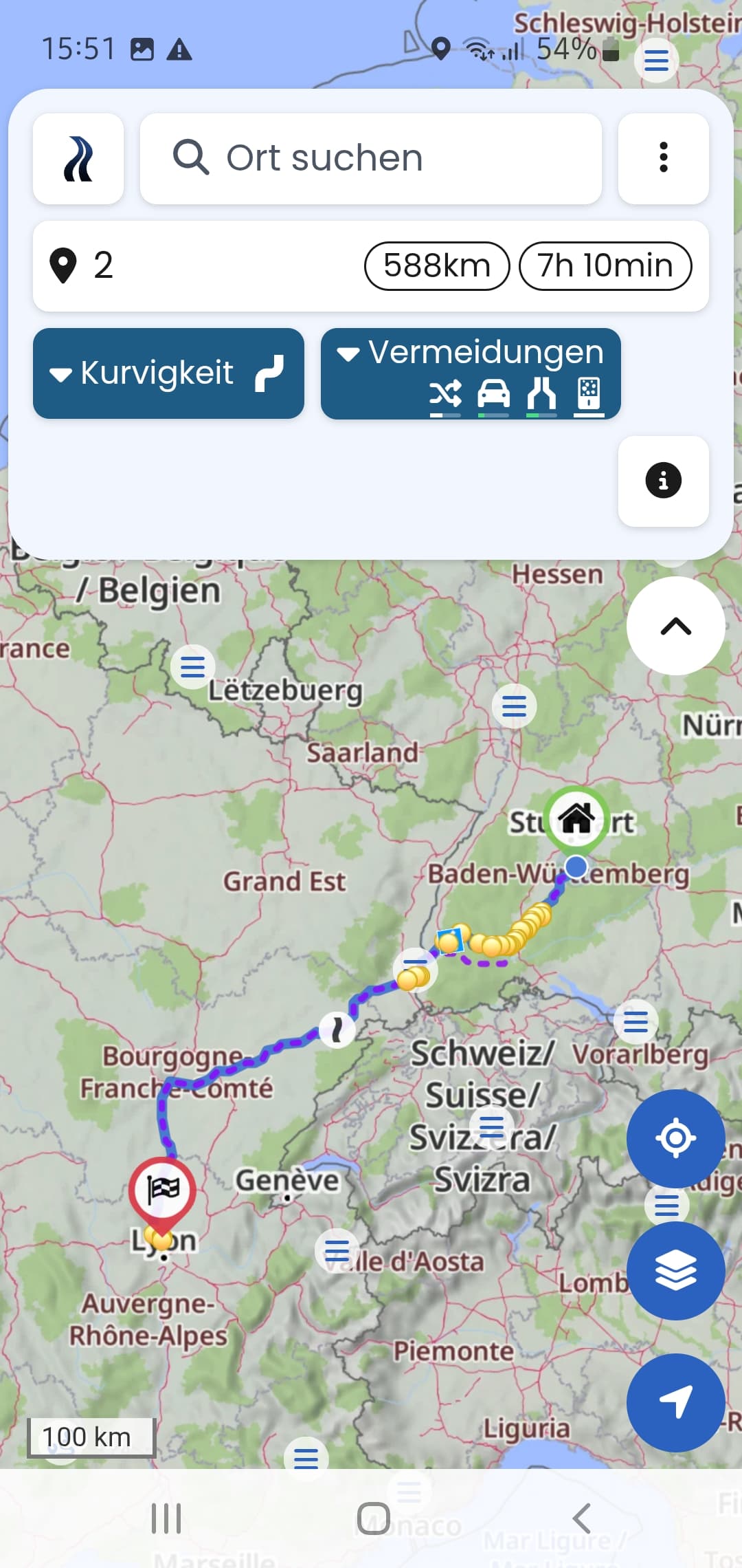

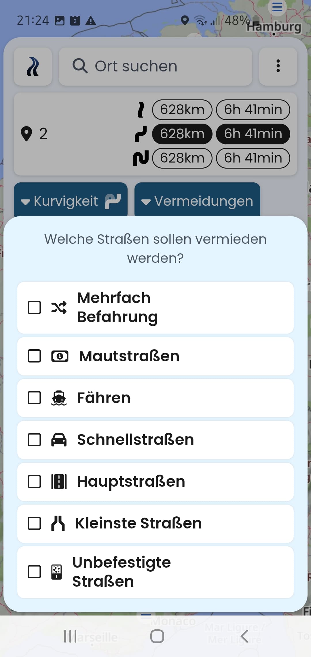

If I enter a value in the avoidances on expressways, the route does not change for different curve options.
But ist is not every Time. I play along with different settings and at a point, it shows always the same distance.

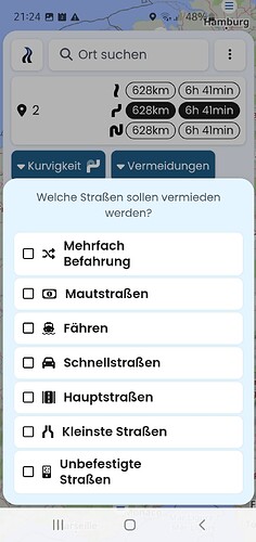

Try without using any avoidances. If there are too many constraints, you end up with the same route.
As the video says around 2:20 - “avoid excluding motorways, main roads and narrow roads all at once, to ensure you don’t overly limit the selection”

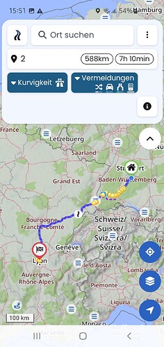

I delete all avoidances and try again. It calculate an other route over the highway, but still in all curve-options equal.
Then I delete the route, and set the destination new, it works properly.
I tried differend settings of avoidances and it works proper with all settings.
If I reload the saved route from the cloud, then I have the same problem again.
It looks like, that configurations are stored in the cloud, that you can’t change any more.

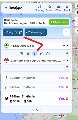

Can you post a short link to this route that is troubling you? Use the “share” option in the menu to generate a short link.
When you load the route from the cloud, it is not recalculated immediately - you need to change something to trigger the recalculation.

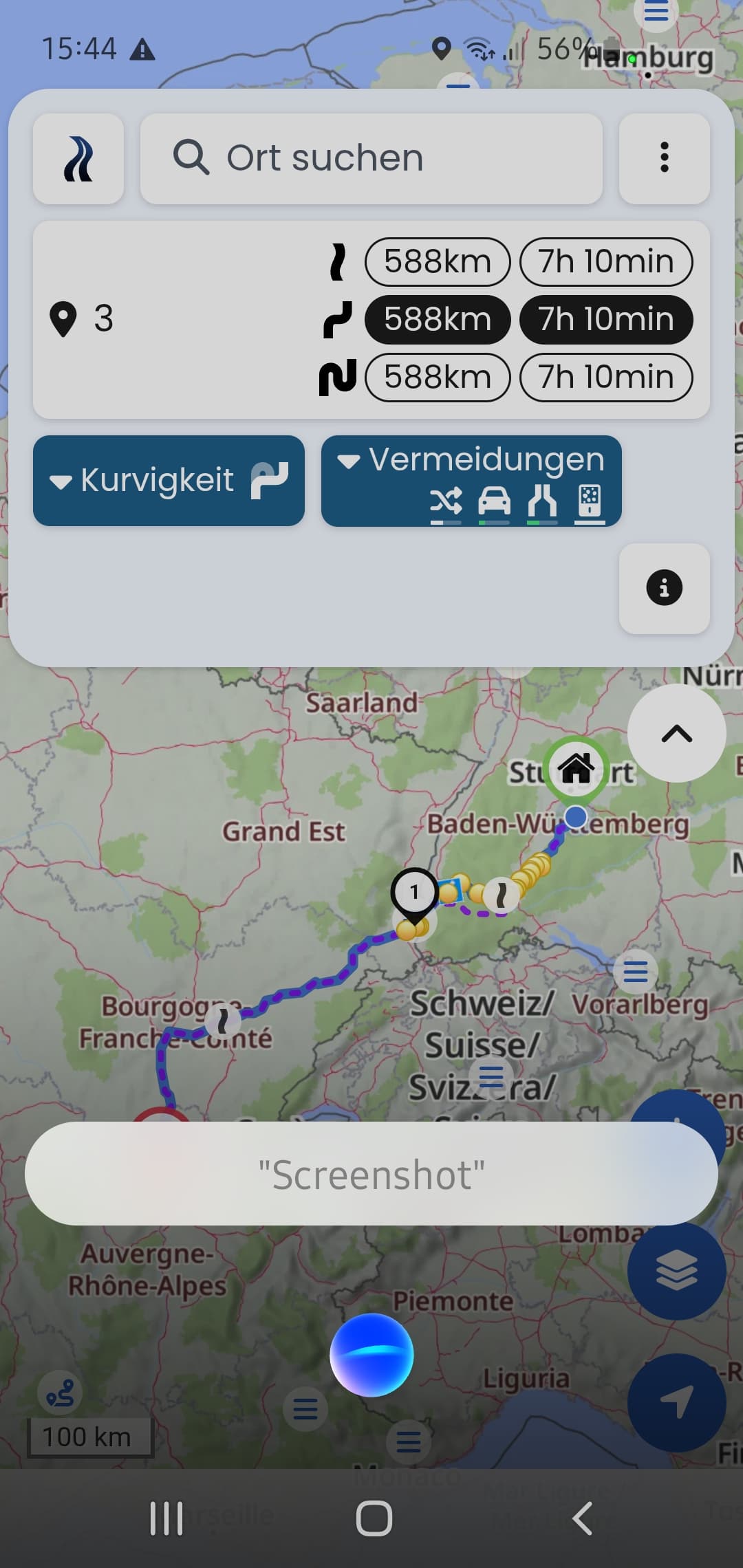

I tried with different avoidances and it looks like recalculating, but with the same result
This somehow does not seem right, it appears to be a bug.

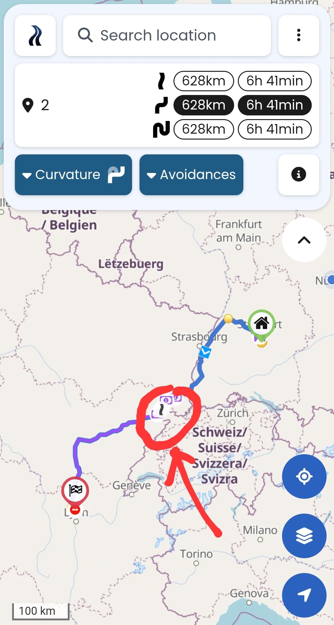

@boldtrn could you check why all three curvatures are doing perfect “synchroneus swimming” in the above route and deliver the same result without any avoidances?

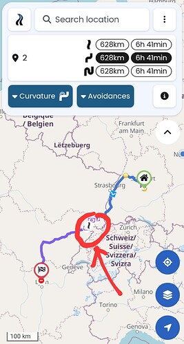

UPDATE: ok, I found the problem - you have (probably unintentionally) set the curvature for the route segment to “Fast and curvy”. This has a higher priority than the curvature for the whole route. Since your route has only one segment, the segment curvature “Fast and curvy” is fixed for the whole route and prevents further variations.
Tap on the small circle and remove this constraint, then you will begin to see the variations and can play with avoidances as well.
Exactly
On the website you can remove the (fast and curvy) setting between Start and End by clicking again on that icon. This setting only makes sense if you have more than one route segment, i.e. if you have at least one extra waypoint.
