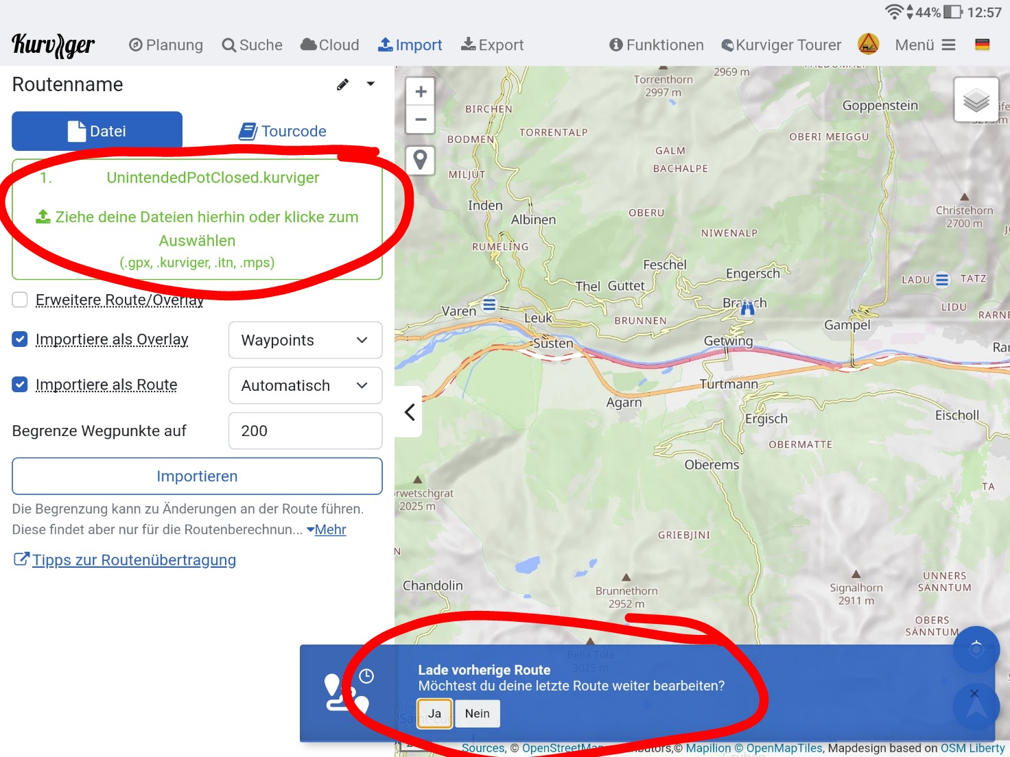

Don't ask for previous route, if opened by tap on file
If I tap on .kurviger file in Total Commander, Kurviger opens and selects the tapped file in import dialog :+1:
Nevertheless Kurviger asks if I want to load the previous route (of course not - I tapped the file to load that file):
Proposal: Do not show that dialog in this case.

I really do not like the Android built in method to browse through the directory tree, therefore when planning routes for vacation (I use the app on a tablet for that) I always use Total Commander and tap on files which I want to open in kurviger, this concerns route files, overlay files and also POI files.
