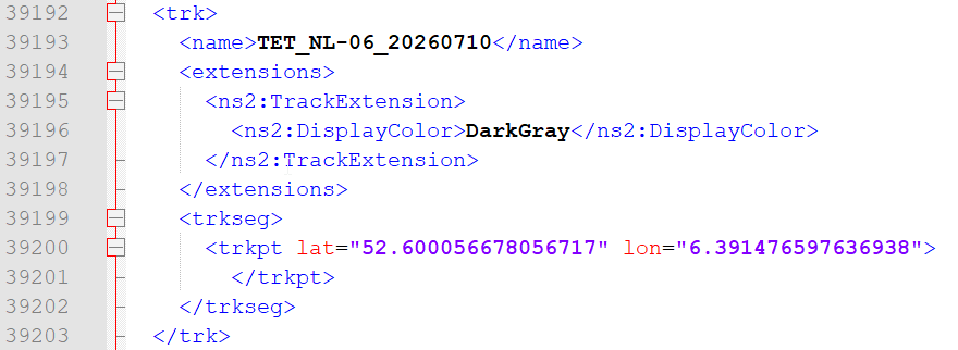

TET_NL-06 has only one <trkpt>:
Kurviger doesn’t know what to make of it …

This a file from Garmin. Garmin or Basecamp have the possibility (as far as I know) to place POI independant from the Route or track. Kurviger cannot use these extra points this way. As in this file there is such an extra point - and only one - this error appears.
When importing Kurviger tries always to create a route. As there is only one waypoint (the rest are track segments) it is impossible to create s route from waypoints, you need at least two points.

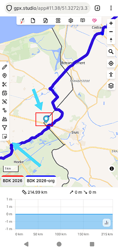

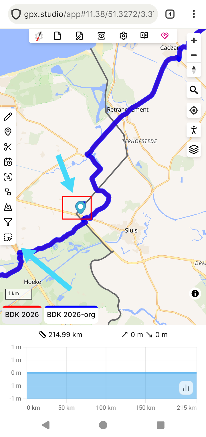

Another easy and great tool is gpx.studio — app.
Open your file, check, modify, export again. Here: identify this waypoint, activate function for deletion, make a rectangle, delete the gas station.

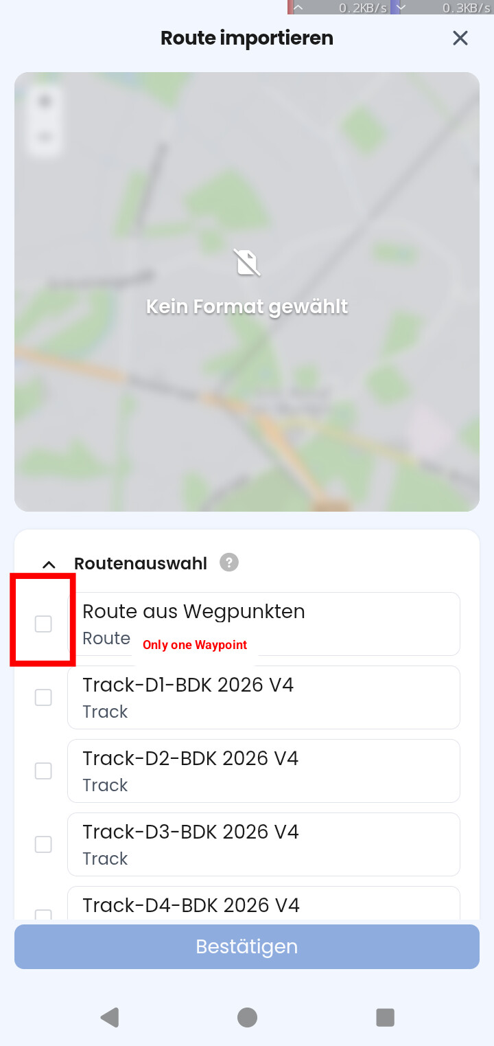

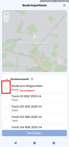

Another option could be to still display the data, but remove the checkbox, as not possible to import. The user has the hint, that some data of the gpx cannot be used. The user can open the gpx file, copy the coordinate and check.
The single point could be shown in the preview.
Another option could be, that in this special case with such a single point, that the route / tracks are imported first. Then this single point is added in the last step as waypoint as best fit. When checking the deviations, the point would cause a big one. But at least it is not lost.
As in the screenshot above, the “Route” would be selectable - but with the hint "Single point will be integrated into the route. I am not sure, how confusing this would be.
