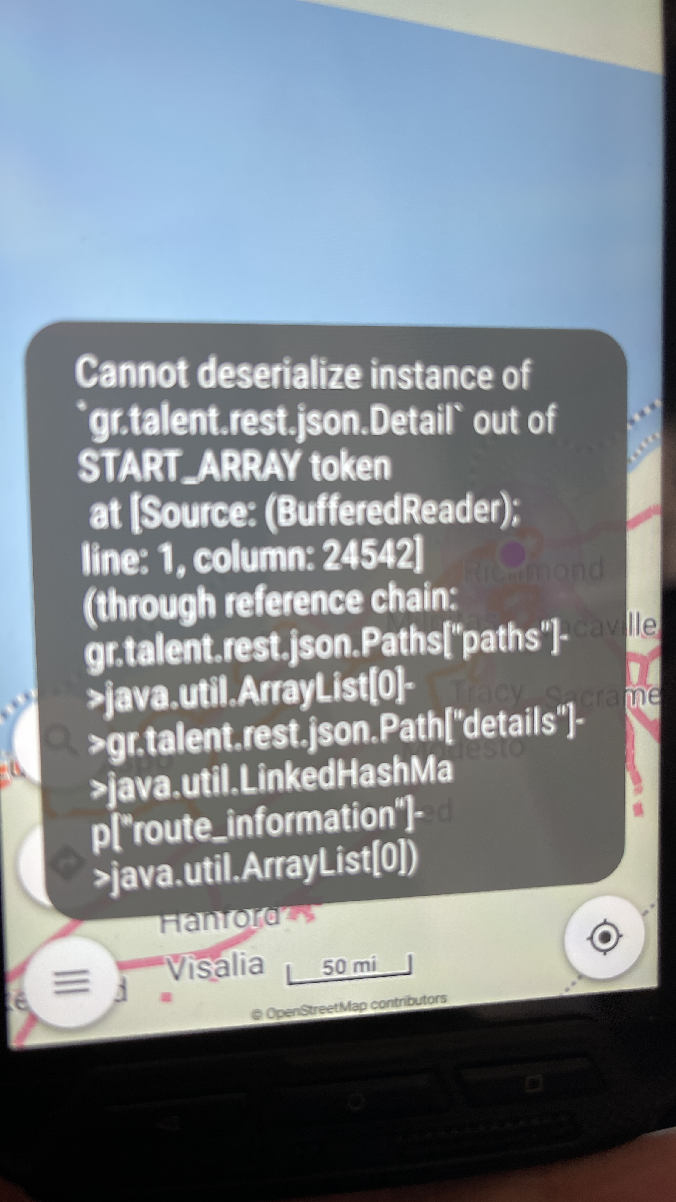

Error message: Cannot deserialize instance
I am trying to load a route created on the Kurviger website and saved as a Kurviger file, but I keep getting the error message shown in the attached image. It gives me no clues as to how to fix it.
Route created in Kurviger Tourer. Saved to Google Drive as Kurviger file. On Android phone, file was moved to SD card. Got error message whether I opened it from File Commander or from within Kurviger app. This is a workflow that I have used many times before. Other navigation apps on the phone work fine. Have tried modifying the route and re-saving it multiple times and can not find anything in documentation or via forum search.
Any suggestions as to what is wrong?
image|281x500
Welche Version benutzt Du? Der Fehler ist mit der Version 1.14.16 aufgetreten, sollte aber mit 1.14.17 behoben sein. Kurviger 1.14.28 - #51 by Tom und Import error with app 1.14.16 from website
Which version do you use? The error occurred with version 1.14.16, but should be fixed with 1.14.17. Kurviger 1.14.28 - #51 by Tom and Import error with app 1.14.16 from website
Yes, updating to 1.14.17 fixed it. Thank you.
