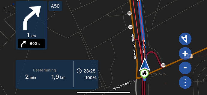

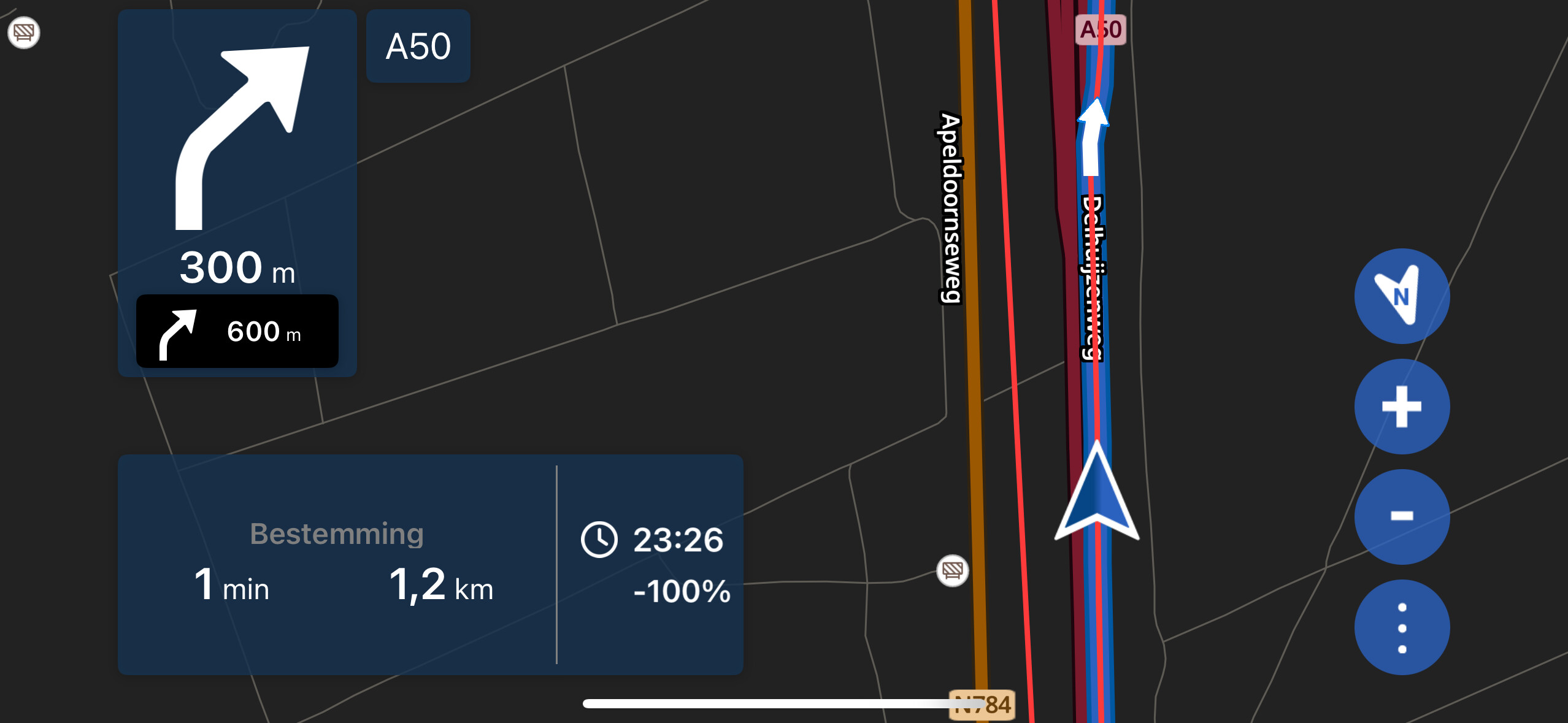

See attached and the picture of the road. If zoom is enabled you can’t see which road you need to have.

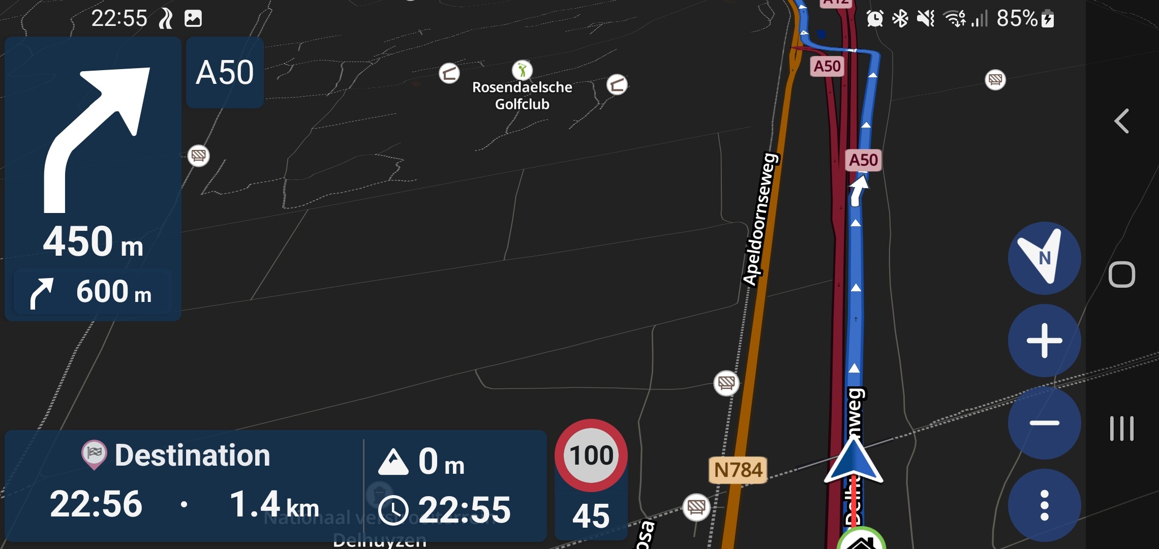

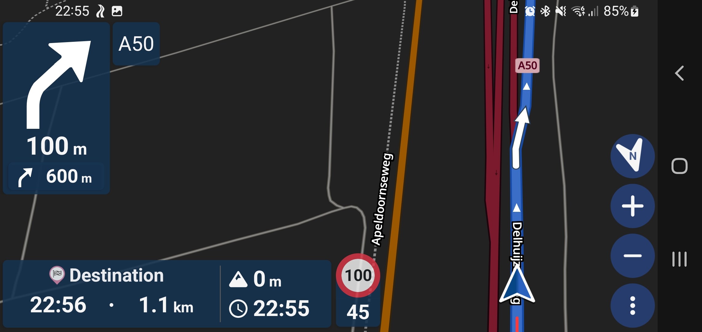

This is how it looks like on my Android phone:
I am still able to distinguish that it is the rightmost lane. Does it look much different on IOS? First version of the carplay used to zoom a bit too much, not sure if this has been fixed already.

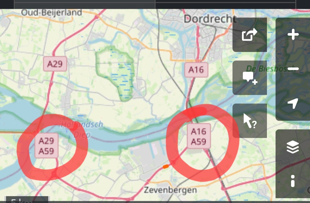

I am a bit confused how the highways are modelled in Netherlands. On some sections, there are even two markings:

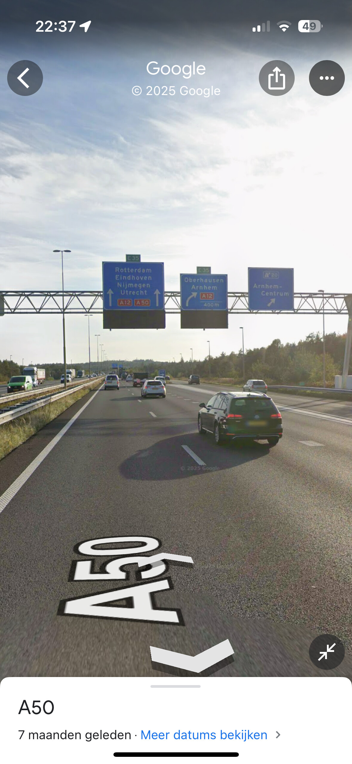

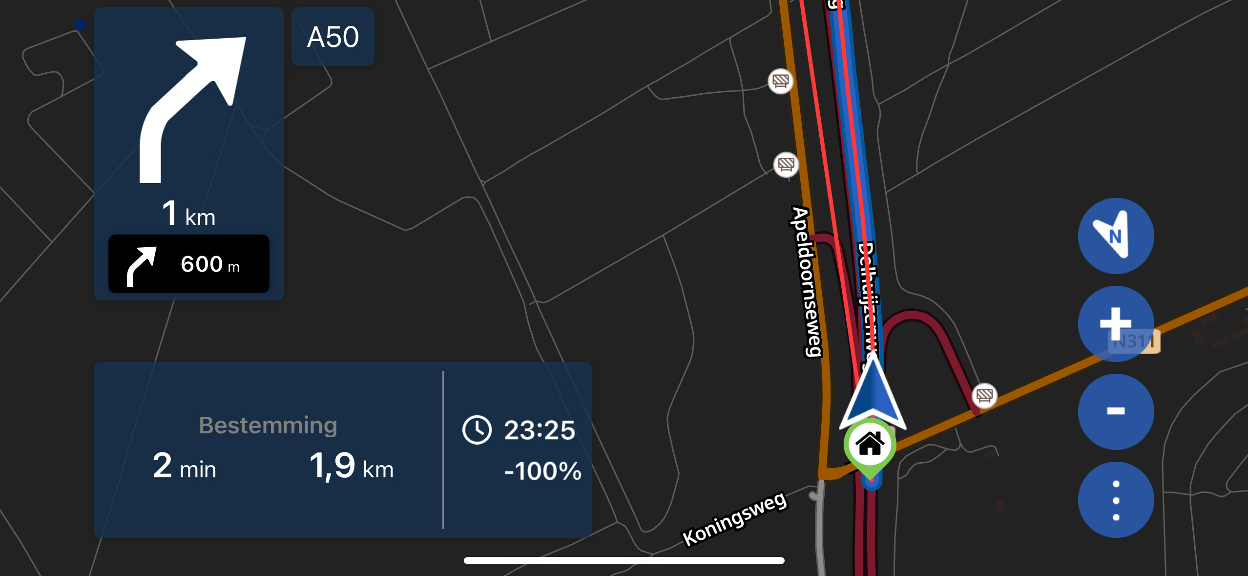

I have attached as on my iPhone. As you can hopefully see from google (earlier post) there are two exits. Since you have no indication of which exit to take and confusing that there is another right turn coming up. You wonder which one of the two you have to be on. Perhaps using 3D makes the view better. Will give that a try.
