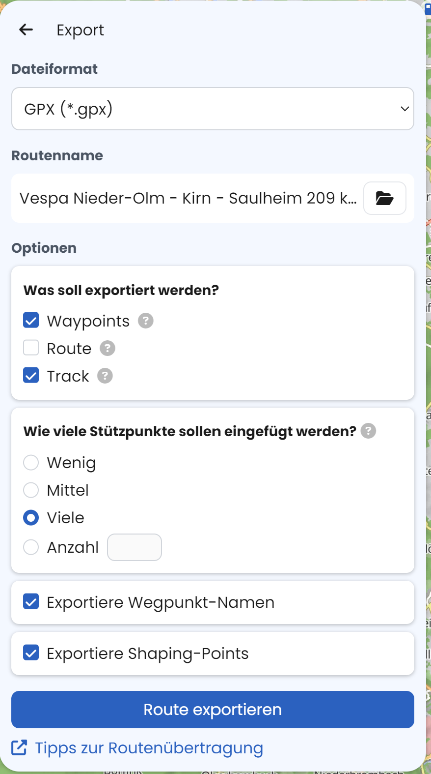

thanks for bringing this up. Yet we cannot offer the same functionality, I can only give you a hint regarding export options. I practised that method with TomTom and Garmin Users and the routes worked quite fine, maybe not always 100% but close to.
When you export a route choose following parameters:
Would be cool if you could give it a try and let me know the outcome :slight_smile:
I think it would be nice if you could share a typical planned route from Kurviger (right menu - share - copy the shortlink https…), and also upload the gpx file from the other app, so we can check, try and learn. Many thanks in advance.
