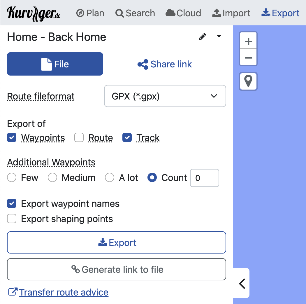

I have been unable to export a track and waypoints, without the shaping points showing up as well in the GPX file. I have unchecked the “Export shaping points” option in the UI dialogue, but the shaping points still appear as waypoints. Is this a known limitation with a GPX export, or am I doing something wrong? This is how I have configured my eport.

the export options look ok, but how about the import options? In which device did you import the route and how are the import options configured?

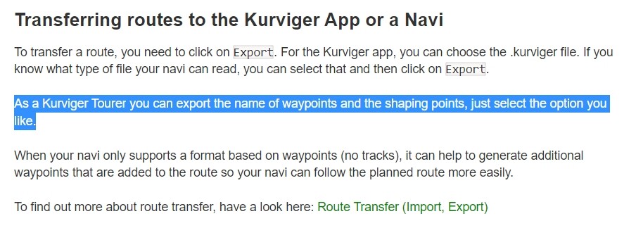

I didn’t find a detailed description of “Export shaping points”, only this:

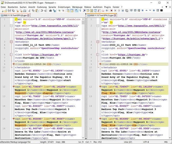

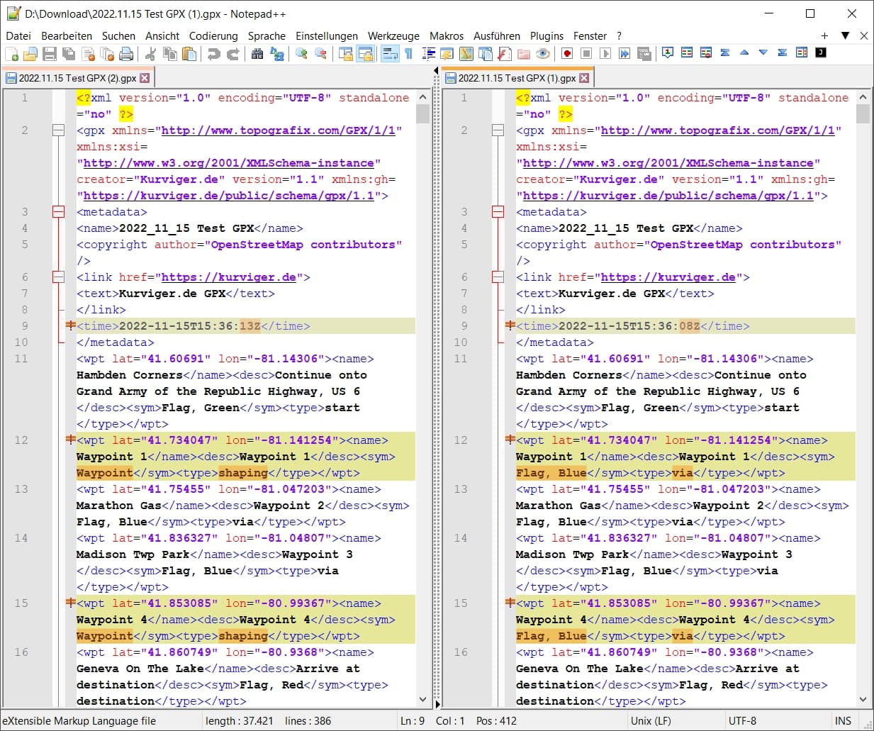

But I tried it: if the checkmark is set at “Export shaping points”, then shaping points remain shaping points, otherwise they are converted to via point. See comparison of two files:
Left with “Export shaping points” set - Right without …
Thank you for your analysis and input. That is helpful information. I hadn’t considered using the “Export shaping points” option to at least categorize those points differently. That allows me to easily change the appearance of those points, or even delete all of the shaping points, after import.
