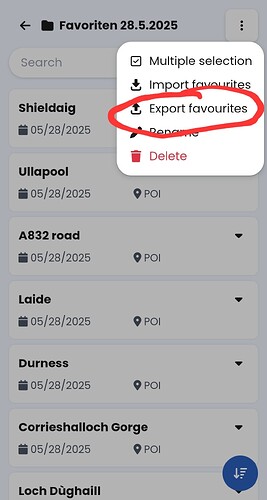

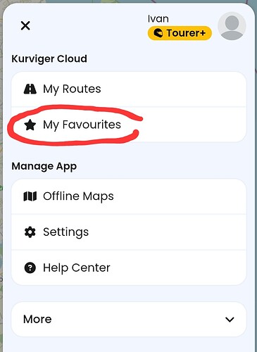

To export your favourites/POIs from Kurviger App, you have to follow these steps:

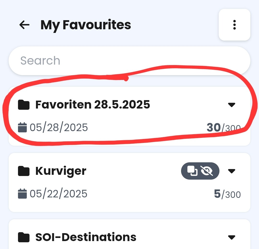

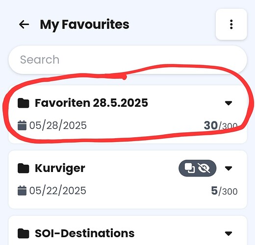

1. Go to “My Favourites”

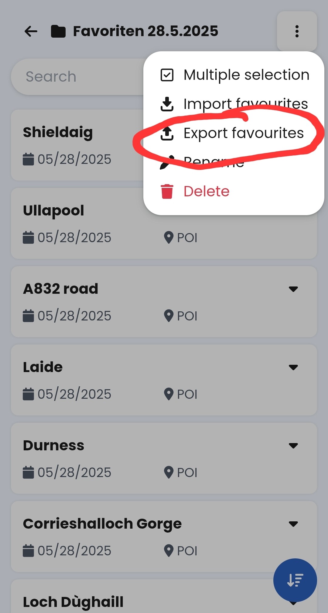

2. Open the folder that you want to export
3. Select “Export favourites” and save it as a GPX file
