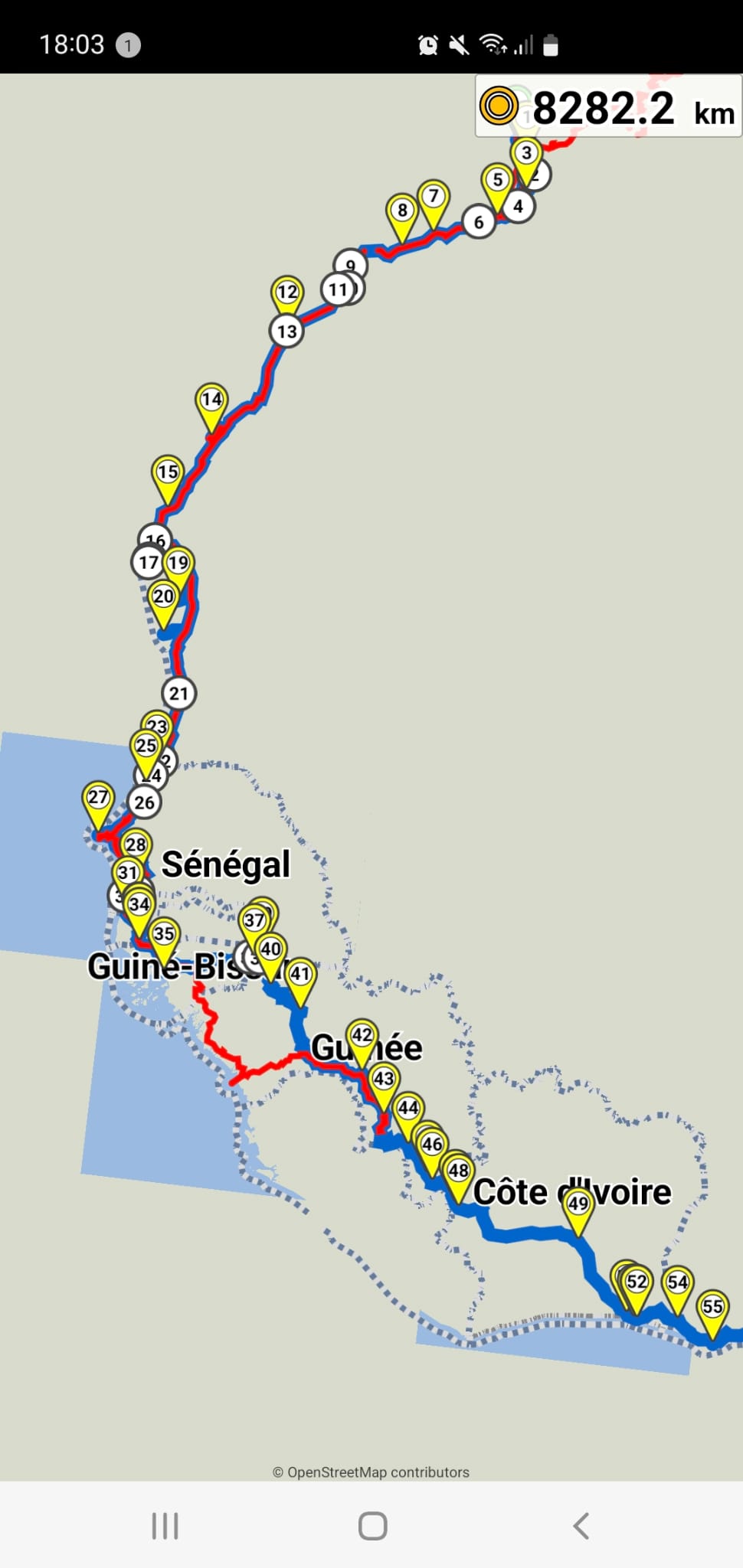

The track I drove trough Africa is marked in red on the App. I want to export the track since this is the real thing, not the planned route.
I still use the 2.2.28. I want to export the track I drove trough Africa which is marked in red in the app. The track is visible in red and must therefore be stored somewhere on the mobile phone. The export file only exports the planned route, not the real thing. I could not find any *.gpx file on the mobile phone.

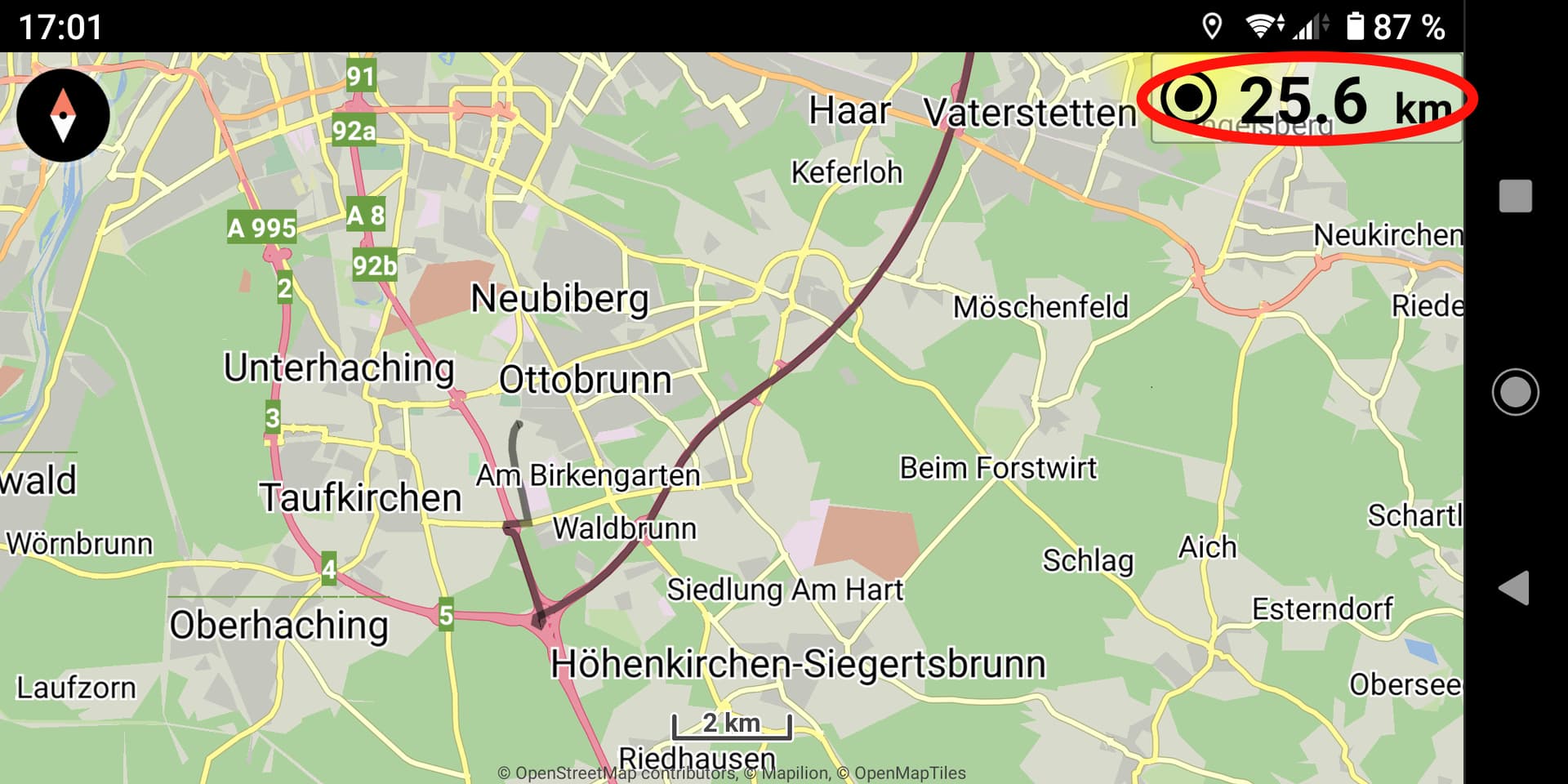

Then you should have a km/mi amount for the recorded track on the screen - like this:
(in my case the track color is black, not red)
Click on the displayed track distance any you’ll get this:
If there is no indication for a recorded track on you display then you should add it with /Settings/GPS recording/Add GPS recording display

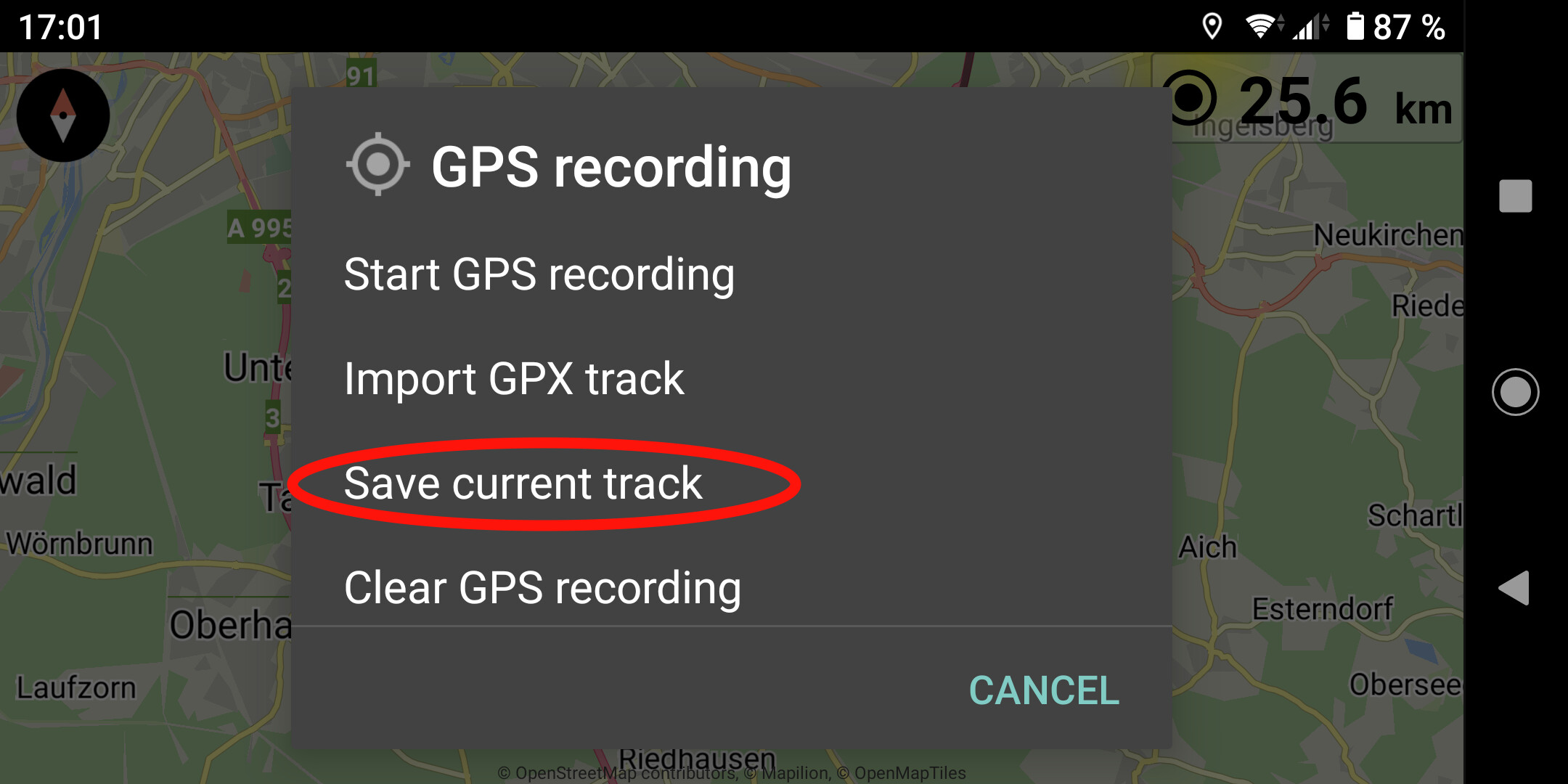

Click on 8282.2 km and you should get this:
Click on Save current track and follow the instructions …
