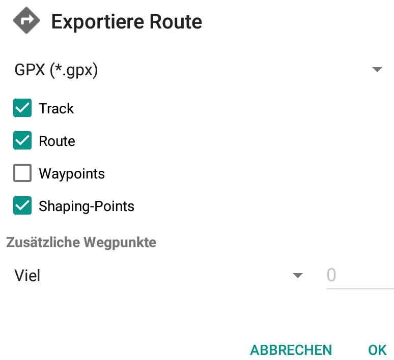

Exporting this route as GPX:

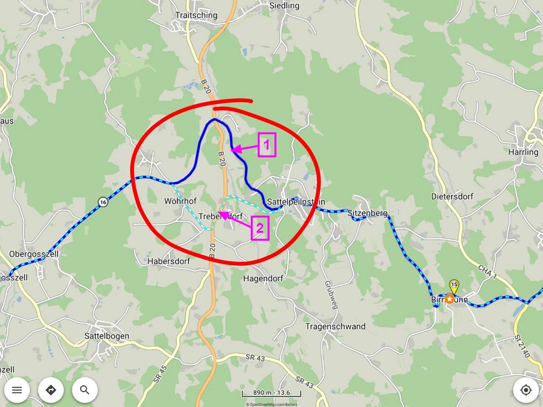

and importing that GPX afterwards as overlay (track) you can see a deviation between waypoint 15+16 (blue: route of .kurviger file, cyan dashed: Overlay track of GPX):
I understand that such deviations can not be avoided, probably because the app transfers only the waypoints to the server during request, so the server has to do a new routing - and if OSM data or algorithm has changed in between this can lead to a different route.
But perhaps the app can check the track returned by server for deviation from track in .kurviger file and give a hint, if the returned track does not match the one in .kurviger file.
(Of course the deviation in this example is small, ~2km, but there were other cases where the GPX route had significant changes).

Moved to website category as this export is online and done on the server.
Exactly and well described, it is the expected behavior.
If you need identical routes / tracks you can use kurviger files.

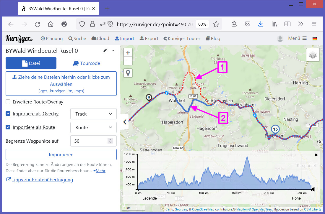

Have imported in the website the *kurviger file of rumbrummer:
Comparing with screenshot of rumbrummer:
There I’m a little bit confused due to the course marked with 1 and 2.
Why there is a change between track and route in the courses marked with 1 and 2?
What happened there? Which course was the originally route?
EDIT: Due to feedback in this threat some additional info is added:
Now it’s much more clear :slightly_smiling_face:.
  • Course 1 (blue: route of .kurviger file in rumbrummer screenshot) is the course of the originally route (calculated about a year ago).
  • Course 2 (cyan dashed: Overlay track of GPX in rumbrummer screenshot) is the course of the route when (re)calculated now when imported as .kurviger or .gpx file.
Reason of differences between one year old and actual calculation perhaps depending on changed map (routing) data or routing algorithm.
App: 1 should be the original route.
Sorry for no clear definition. In the website the colours and line styles of track and route are not selectable. Therefore I didn’t mention :unamused:.
In the website screenshot marked with 1 is the track as overlay of the imported .kurviger file and therefore should be the track of the original route, marked with 2 is the recalculated route of the imported .kurviger file.
