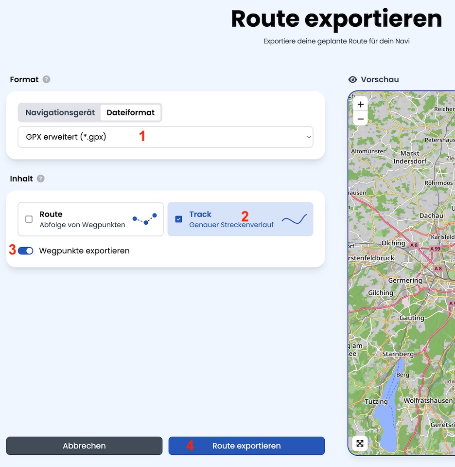

For file I have GPX (*.gpx).
In place of the Wegpunkte exportieren I have None, Intelligent and Interval choices. From reading the help screen, none of these choices sound like what I need?

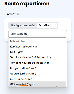

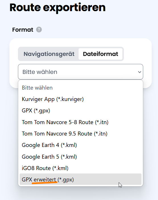

Double check at the end of the list. Here the Web-version, but should also be available in the app.
If not, it will be in the next release. In urgent cases use browser on the mobile device.
Found it in the browser, PC and mobile. FYI, in the Kurviger app the setting is not there. I just checked and there are no available updates.
The import looks good, will test ride it in a day or two. It looks perfect on the screen!
