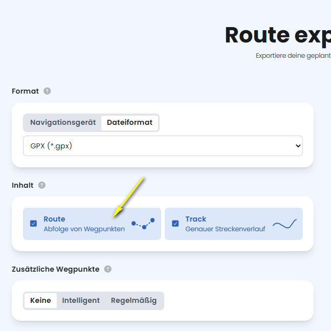

Did you perhaps just save the track by deselecting the route (click on Route, see arrow)?
In that case, your waypoints are no longer included in the GPX file.

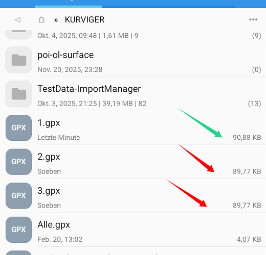

I can reliable reproduce. First export contains waypoints, in all consecutive exports the waypoints are missing.

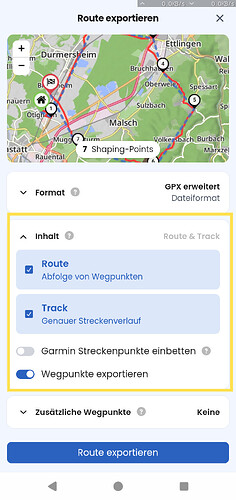

I used these settings.

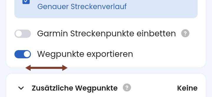

When you toggle Waypoints off an on, the next one works again.
@Eugenio: Nice find. :+1:
Thanks Toffel, I was just about to send a similar set of images, you came up with the same problem. Also liked that putting the switches back and forth is influential, probably that confused me the previous times. Overall I am satisfied with Kurviger, I am curious about the solution. Greetings, Eugenio Eijck
