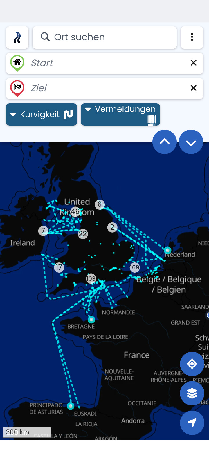

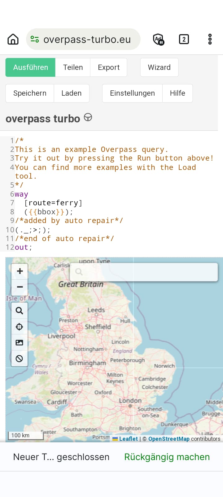

This is just a 5 minute test on a smartphone. Better on the PC due to perfirmance. It is just a rough query to search for all ways tagged with “Route=ferry”. Serms to include much rubbish, but could be enough.
Download!! and Import this file in the overlay manager (please don’t use the import function!!!). Not just open in Kurviger!!
OverpassTurboTestRouteFerries.gpx (344.5 KB)

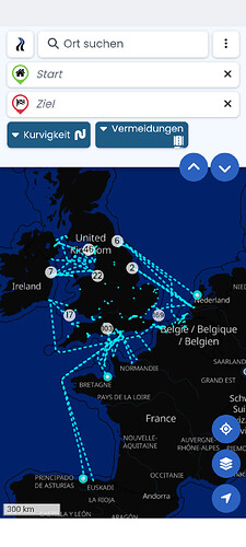

Okay it worked.
One question though, why does it only show ferries around the UK? And not Italy and Greece? Is it linked to the map showing on the screen or is there something else?
Exactly. The {{bbox}} takes the area which is visible on the map (bbox = bounding area) to avoid huge data processing.
