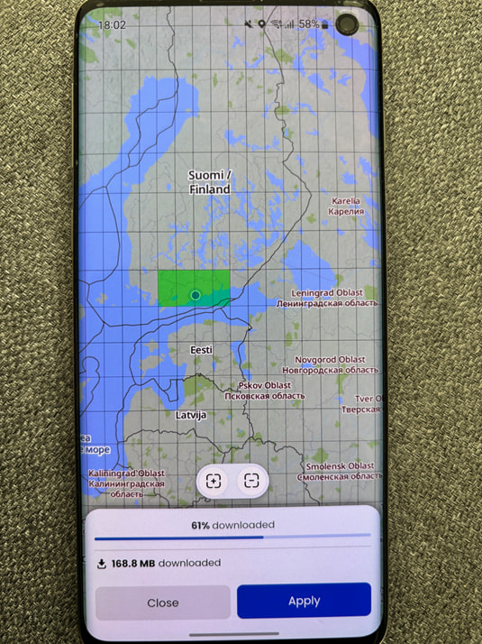

Hi i dont know this the right one but why does it take very long time to download offline maps?? Simple 150mb map takes for ever, if i try get lets say my route about 1600km it will take my life time to download :grin::grin:

What does “very long time” mean? I just downloaded 200MB (2 tiles) and it took around 30 seconds. Have you already tried restarting your device or deleting local data within the app? Did you receive any error message?
No error and yes try to delete cache and restart apps and device as well. Here is example video about 30s downloading only one block: https://photos.app.goo.gl/kmpUH5HHPsETGFWz8 and that one block did take something like 2min to get green but stil that download bar indicate that 61% is downloaded :slight_smile:
Sometimes it feels laggy, not as constant stream, as if there are pauses. Sometimes it helps, to close this view and open again, perhaps something with the update of the map
On my phone the four regions took about 2 minutes.
My experience is, that everything is reliable downloaded, so no need to watch. A cup of coffee shortens the time. Not very helpful, but it works for me.
Of course download rate also depends on your internet connection. You can just close the view and the maps will be downloaded in the background, while you can do something else in the app in the meantime.
That a tile is green and still shows a 61% Download progress sounds weird though. Did that happen just this one time or do you observe that regularly?
