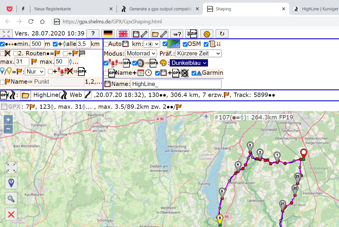

Take this kurviger route (https://kurv.gr/PHSpf) and the attached corresponding file and let GpsShaping do it’s work.
The result is perfect for my opinion.

As you mentioned you see the details in Notepad++.
Yes, but that only works for Garmin. The export format for the GarminShapingPoint is quite clear, as Garmin defines these already.
For a more general gpx export, we should think about an option. As I said, one option could be the type. Another option could be sym. For sym there seem to be different flags, it could be:
