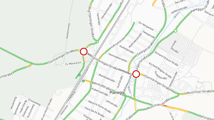

Today it happened again.
Kurviger told me to drive a street which is blocked (temporary for 1 week).
Is this a “live traffic” related problem or a blocked road problem?
As I can see on “ADAC” they have the blocked road listed (see appendix), so would it be possible to import the blocked roads from ADAC into kurviger to avoid such problems?

The route calculation of Kurviger is based on OSM data. These currently say that Germeringer Straße is accessible (how you reported the blocked road to OSM I don’t know - nothing has been changed yet).
The ADAC and many other websites may show closures - but kurviger can’t search the internet for such records. It would be nice if the ADAC would also incorporate its knowledge into OSM.

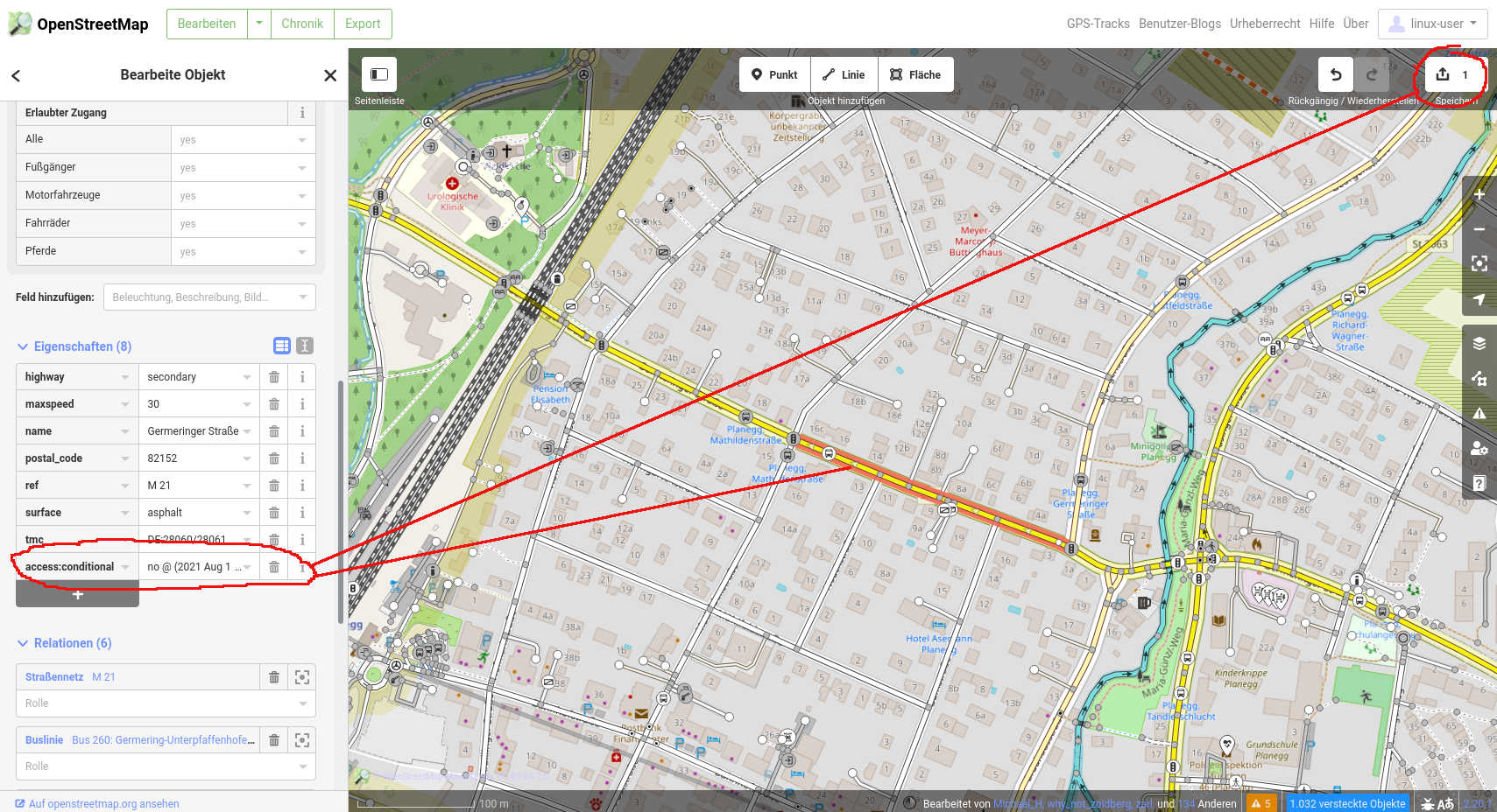

I think something like this would be right
“access:conditional = no @ (2021 Aug 16- 2021 Sep 03)”
This looks absolutely correct.
You would then need to add this information to OpenStreetMap, the easiest option would be to use the iD editor. Here is a video tutorial: https://www.youtube.com/watch?v=5q7ypL0Osqc&ab_channel=RyndoLabs
You would then need to go to the road on the map, click edit and click on the road, then add the tag.
Does this work?
Thanks for the video. The Tag is added.

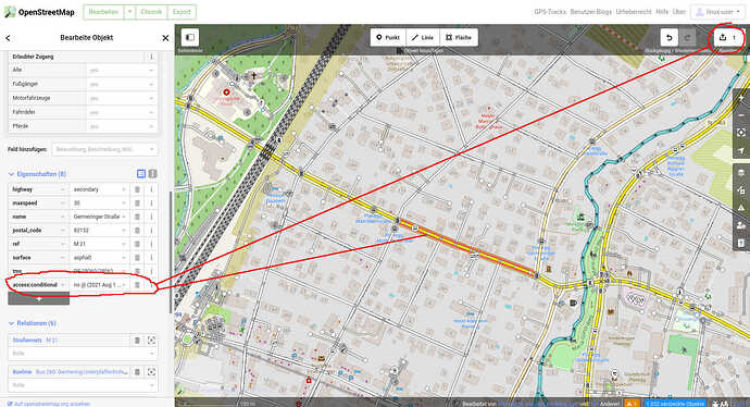

My fault, I’ve added the Tag “temporary access:conditional = no @ (2021 Aug 16- 2021 Sep 03)” which was denied because it’s only “access:conditional = no @ (2021 Aug 16- 2021 Sep 03)” .
I’ve added it again and waiting for approval.
You usually don’t need to wait for approval, I think this is only an option that you select optionally.
I really don’t know whats the problem.
When I go in the “edit mode” and select the road, I can see the Tag that I’ve added. But when I start calculating a route from Point A to Point B it still says that I should drive on the closed road.

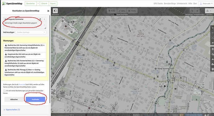

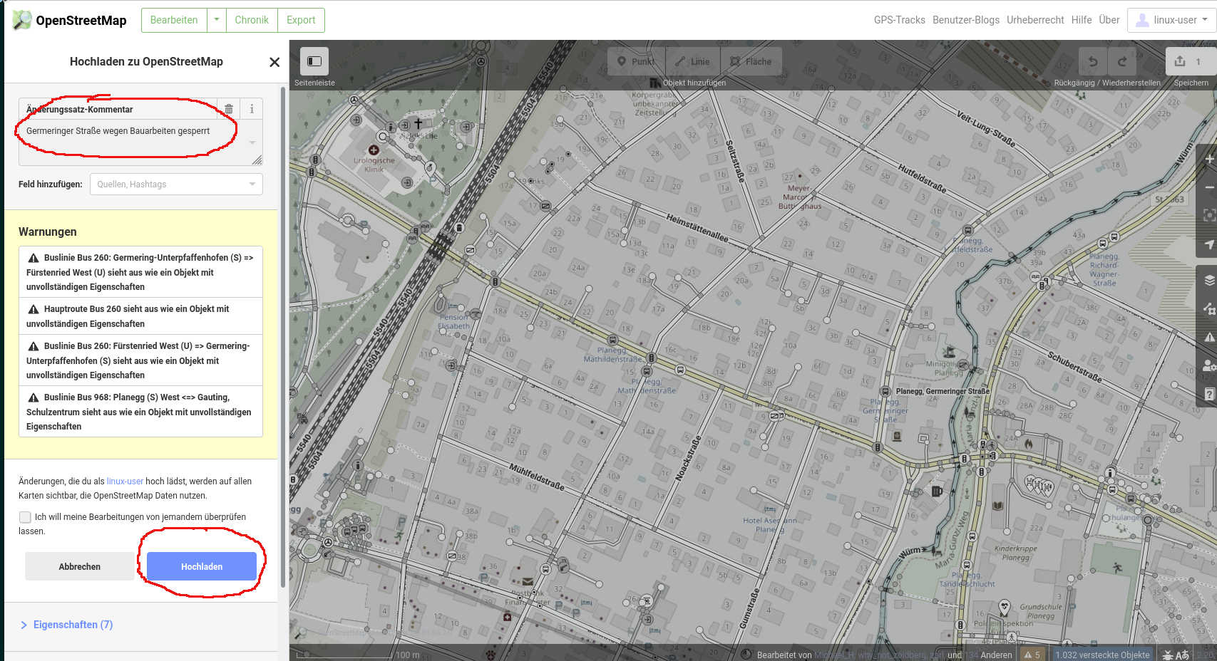

You need to upload your changes to OSM
I’ve done exactly the steps in your screenshots.

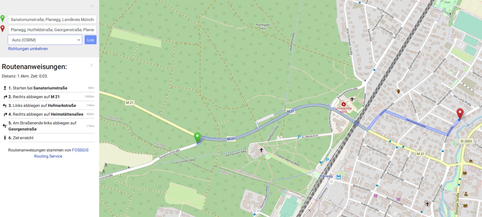

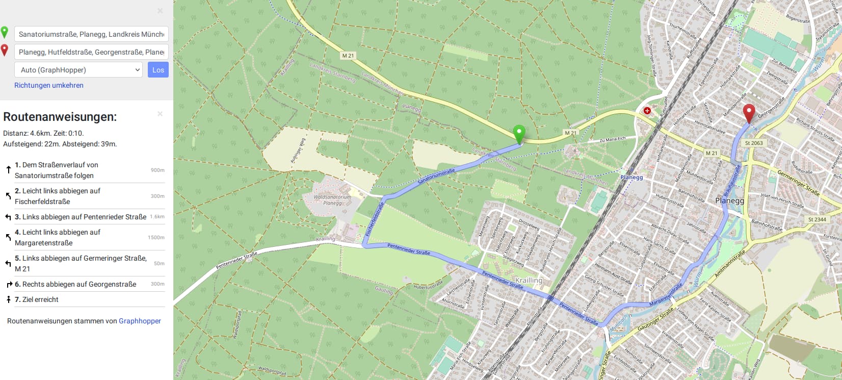

I’ve noticed that the blocked road will be avoided if I select Graphhopper in the drop down menu (See screenshot).
But if I’m selecting OSRM - it’s still navigating over the closed road.
Edit:
Someone in the OSM [Forum] (Marked route as closed, but's still available - OSM Help) told me that OSRM does not support the “access:conditional”, Graphhopper does - so is there a possibility to change from OSRM to Graphhopper in the Kurviger app?
