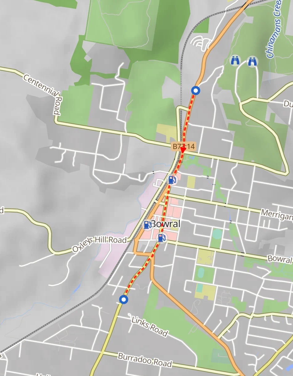

I am requesting some feedback on a routing issue. My mate uses Google Maps on his phone and I use Kurviger and a Garmin Zumo XT.
He is the lead for an upcoming 16 day :motorcycle::grin: and he has done all the routes in Google Maps. He sent me Google Maps links for each day and I use MapsToGPX to convert them for Kurviger and then export as Garmin Shaping Point files. My routes always end up much longer as they include different turns.
I understand mapping software is complex but I have become very comfortable with Kurviger and Garmin over the last 18 months.
In this case we can ignore MapsToGPX and also Garmin Zumo as I can reproduce the effect without those two elements.

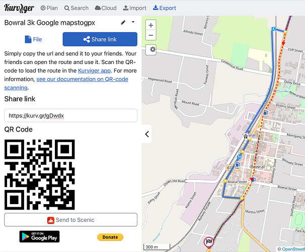

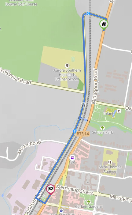

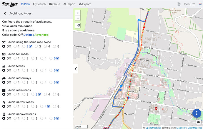

Attached are some images / screen shots to show the issue for a 3 kilometer section of the ride:

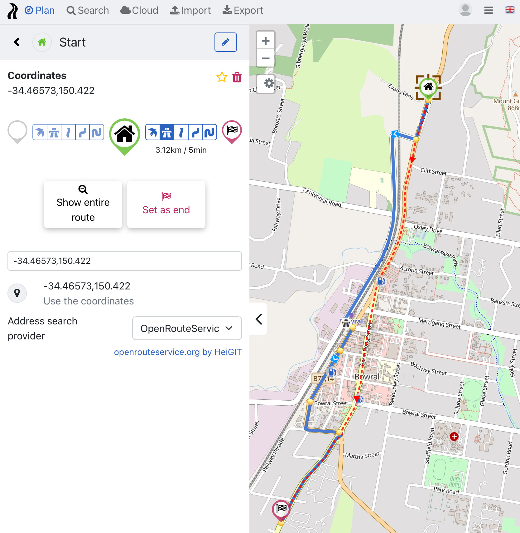

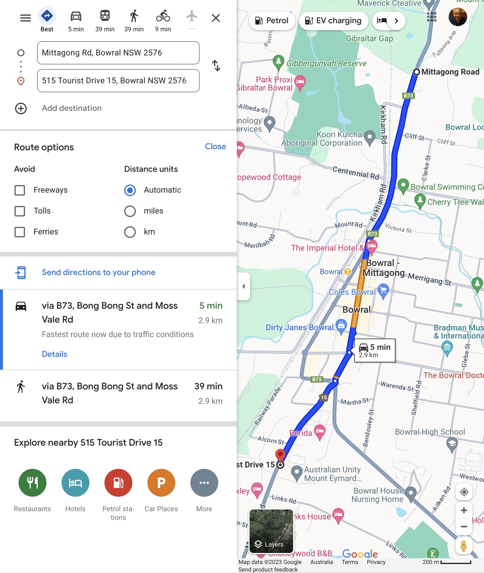

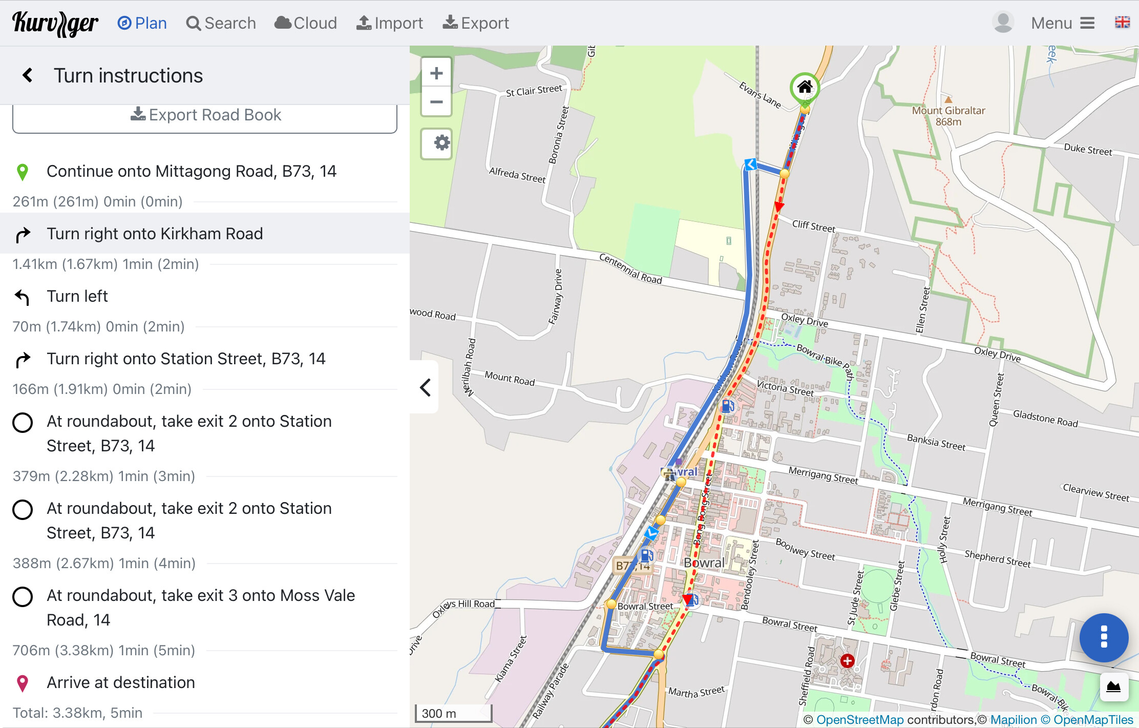

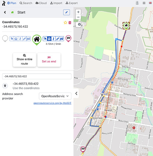

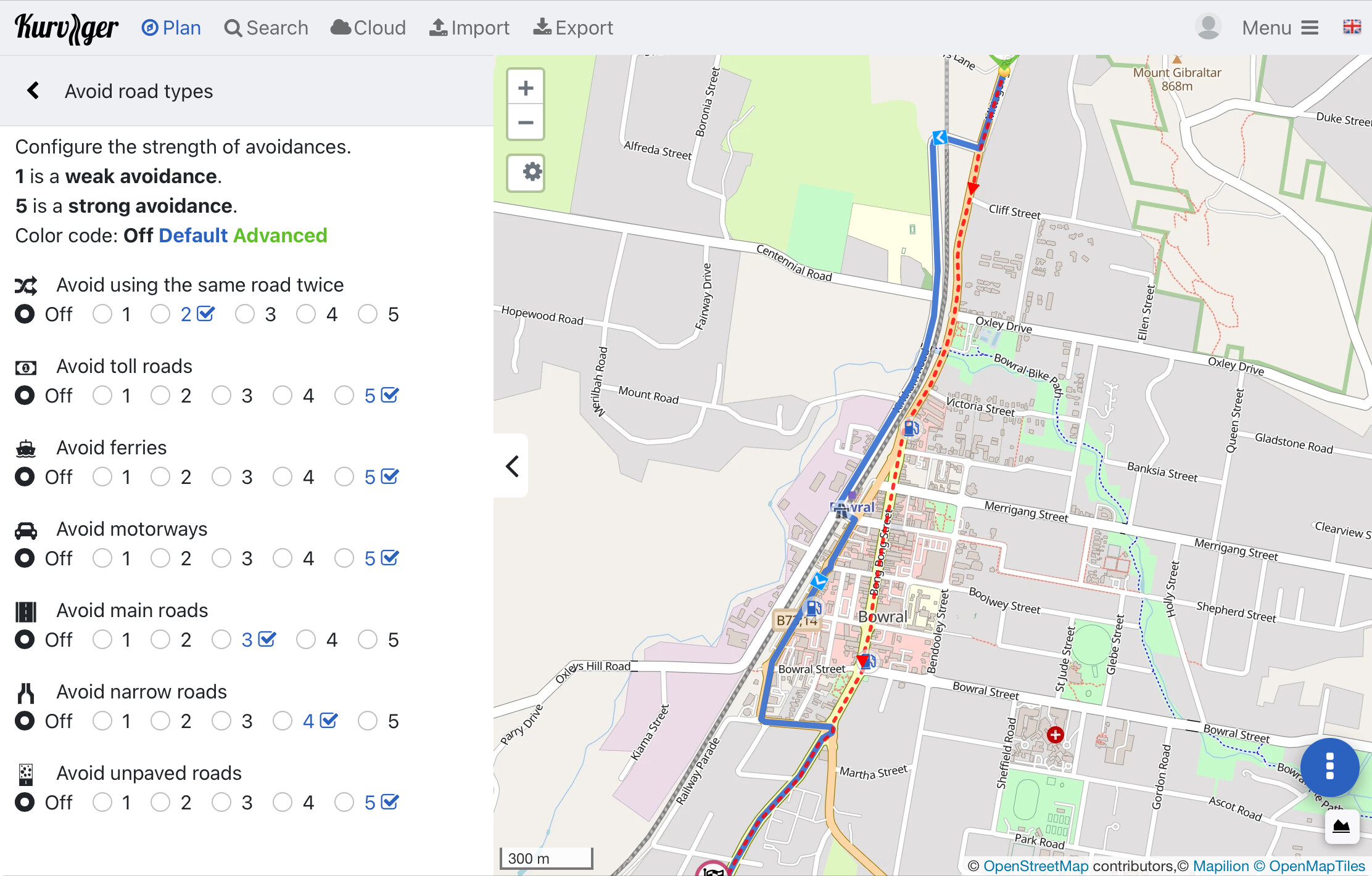

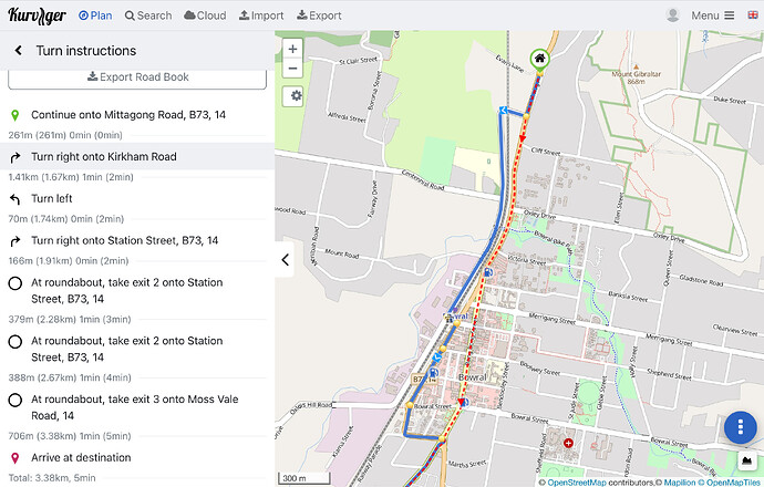

On Google Maps the route is straight through the town. If I choose the same start and end using Kurviger the route has a left turn off the main road and then right back on the main road after the town. I have all my filters turned OFF !

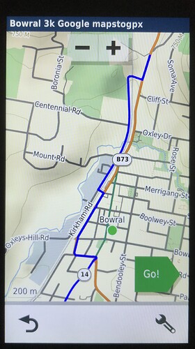

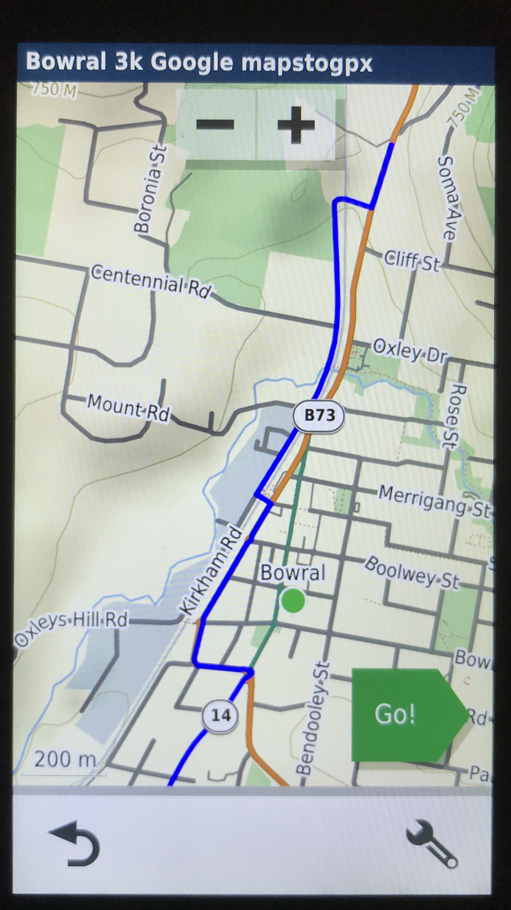

When I export as Garmin Shaping Points and import to my Garmin Zumo XT it shows the same route with the left and right additional turns BUT shows a RED track as per the Google Map straight through the town.

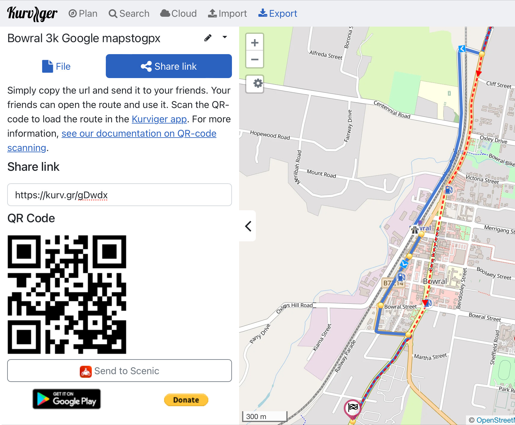

please share the short link to your example so we can take a look. You can then also see what curvature you have set.
https://kurv.gr/UcXub
And Google Maps
https://maps.app.goo.gl/jXjV47FBmg5aXCQf7

All curvature options avoid the road through town.
Google Maps does show heavy traffic.

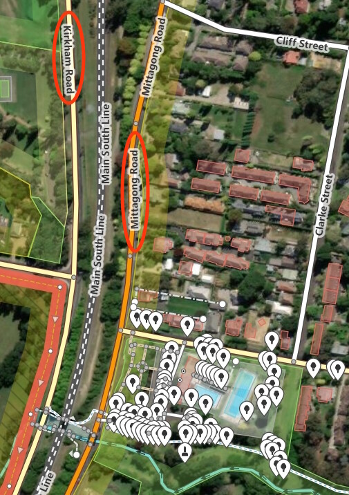

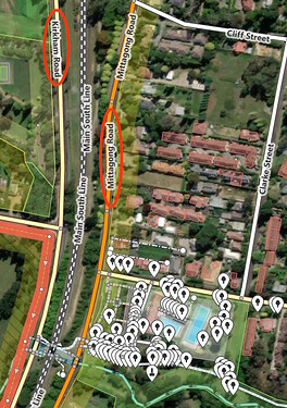

Kurviger mag die Bundestrasse dort nicht! Ist bei mir auch so, natürlich. Sogar, dass es lieber zurückroutet als den schnelleren, direkten Weg zu nehmen: :slight_smile:
Der vermeintlich schnellere Weg ist nach den OSM-Definitionen nicht der schnellere Weg!
Während die Mittagong Road mit maximal 70 km/h befahren werden darf, ist die Kirkham Road frei befahrbar. Siehe OpenStreetMap
Lustig ist übrigens die Definition einzelner Bäume im OSM … :laughing:
The supposedly faster way is not the faster way according to the OSM definitions!
While the Mittagong Road may be driven with a maximum of 70 km/h, the Kirkham Road is free. See OpenStreetMap
By the way, funny is the definition of individual trees in OSM … :laughing:

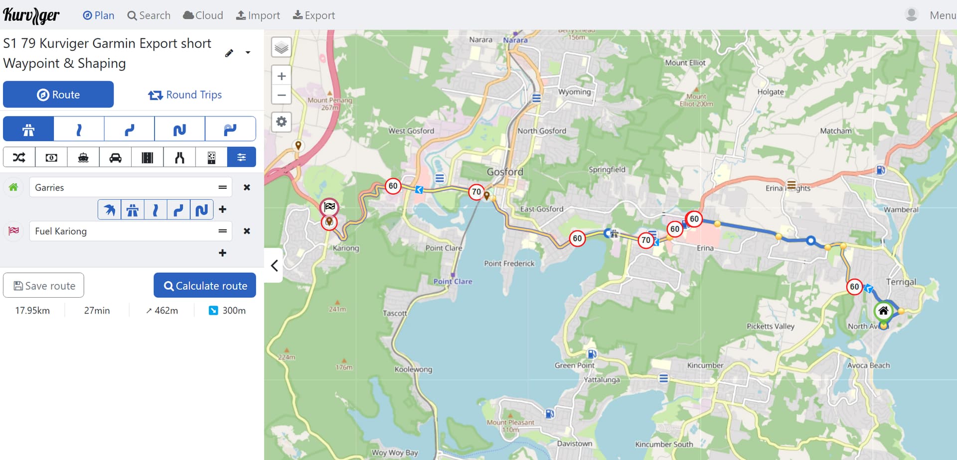

… and is there an issue in general at the moment - I cannot import any of my GPX files in to Kurviger - it will only provide Start and End points and gives me blue circles for all the Waypoints and shaping Points
The GPX text is;
<wpt lat=“-33.4565” lon=“151.4383”><name>Garries</name><desc>Continue onto Tramway Road</desc><sym>Flag, Green</sym><type>start</type></wpt>
<wpt lat=“-33.438413” lon=“151.419754”><name>Stop 1 is Waypoint 1 name</name><desc>Waypoint 1</desc><sym>Flag, Blue</sym><type>via</type></wpt>
<wpt lat=“-33.436833” lon=“151.368004”><name>Shaping Point 2 name 2222</name><desc>Waypoint 2</desc><sym>Waypoint</sym><type>shaping</type></wpt>
<wpt lat=“-33.434442” lon=“151.296771”><name>Fuel Kariong</name><desc>Arrive at destination</desc><sym>Flag, Red</sym><type>destination</type></wpt>

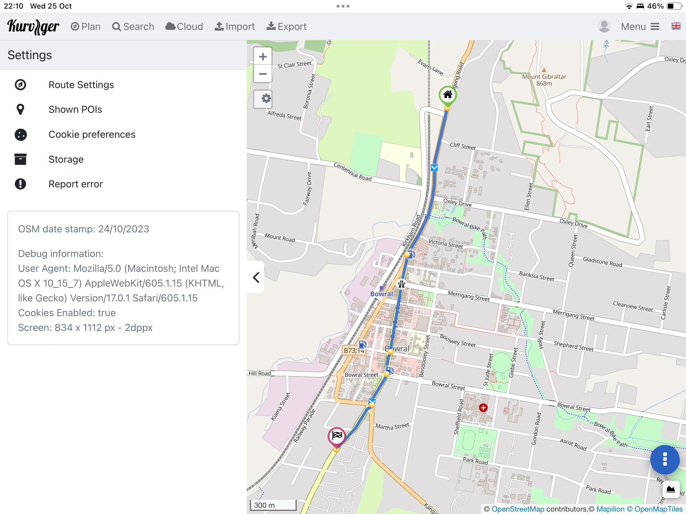

In Kurviger at the moment the OSM date stamp: 10/20/2023 so my edits are not being used.

On the 23rd of October I used OSM TO edit the speed limits on the side street to be 50 kph as per Google Street View speed signs that I saw.
Today Kurviger picked up those edits and has rerouted me straight through the town as per the original Google Maps route from my friend.
