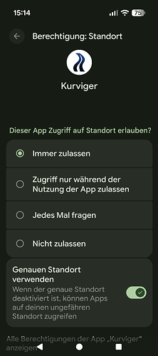

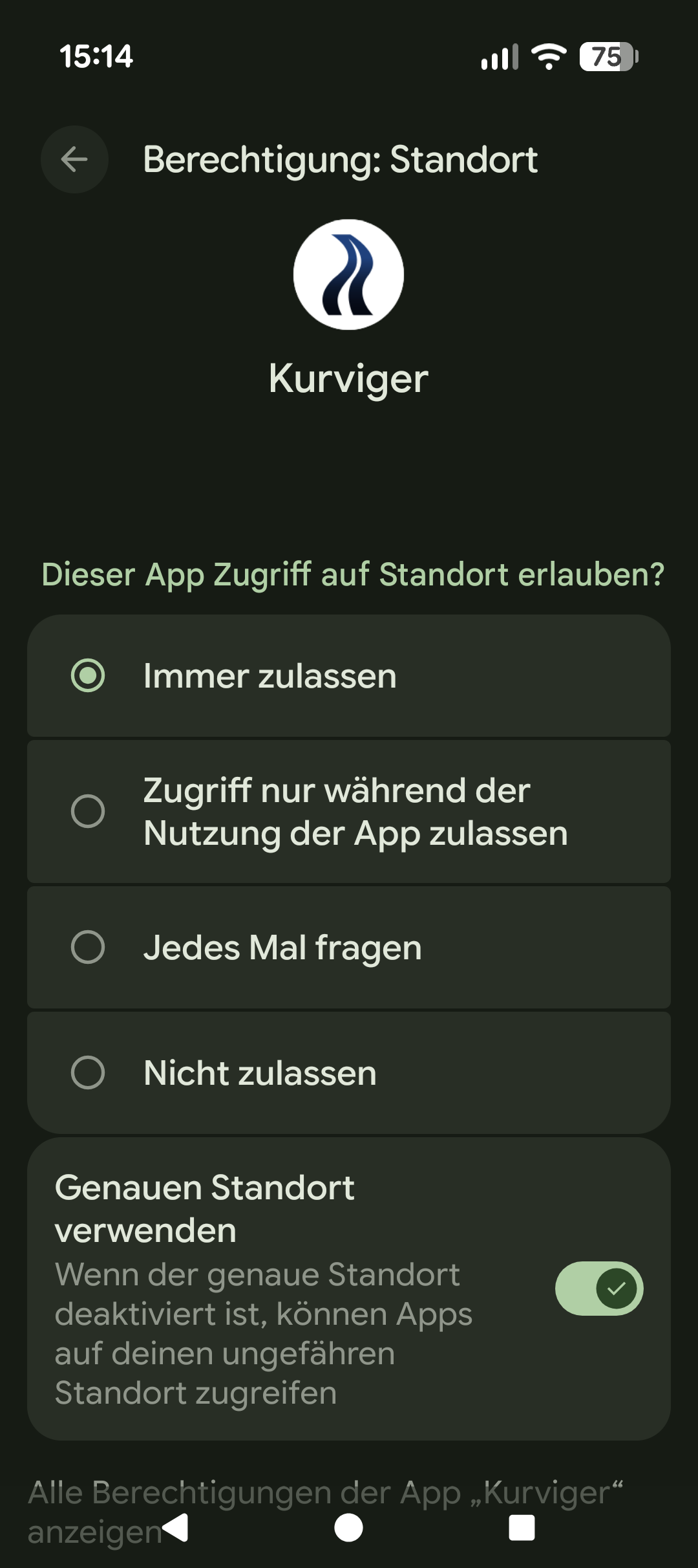

Hi Kira. Yes my location accuracy is set to high and there are no battery saving options applied to my phone or the app.
The accuracy and smoothness of the GPS tracking is fine, it’s just the position is consistently lagging behind the real location. Other navigation apps on the same phone don’t experience this problem.
For my next journey I am will try:
Location Permission = Always (rather than “while active”)
Enhanced Processing (phone settings) = On
But there’s no reason these should cause GPS position lag.
