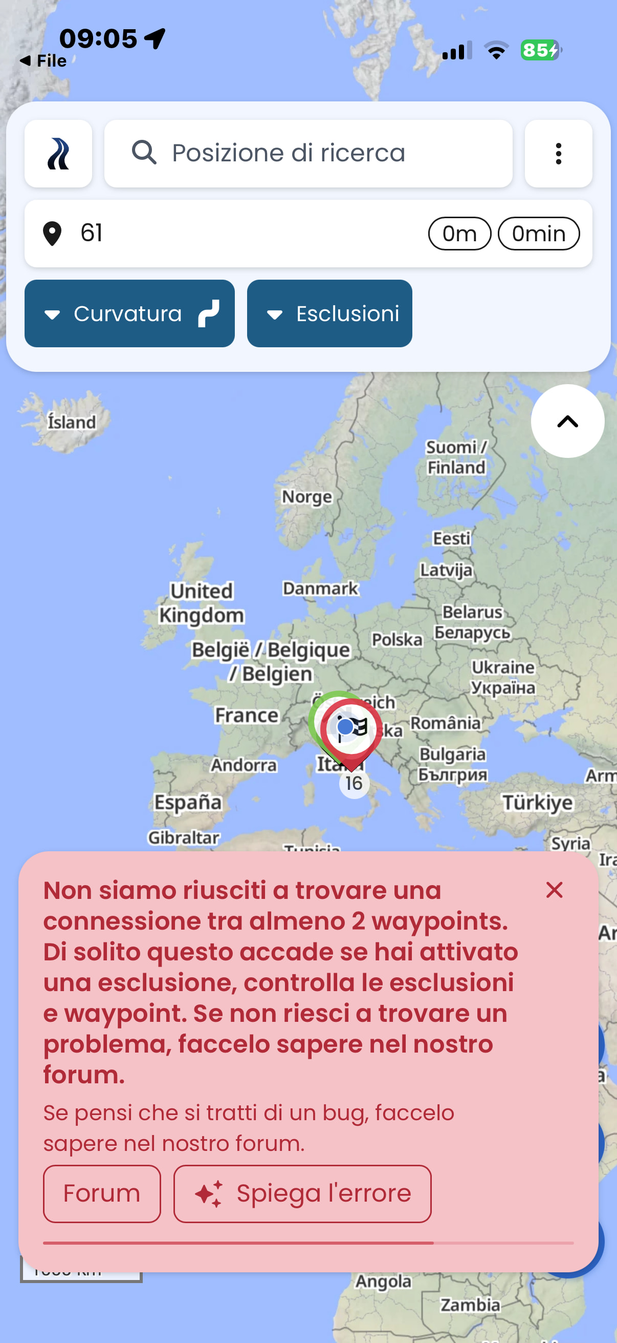

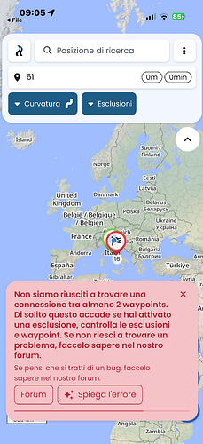

Gpx created with Kurviger does not open with Kurviger
While planning a trip, I tracked this stage with Kurviger and exported it as a GPX file to share with my fellow travelers. The problem is that this GPX file doesn’t open with Kurviger; the attached screenshot appears. All other Tracks don’t have this problem. I’ve tried various solutions, changing the parameters and recreating the route. The only way to make it compatible is to save it with both options enabled—route and track—but in this case, both are displayed in other devices. It’s not a problem because the offending file works with other programs.

After Export GPX Track only. I get the same Error :thinking:
