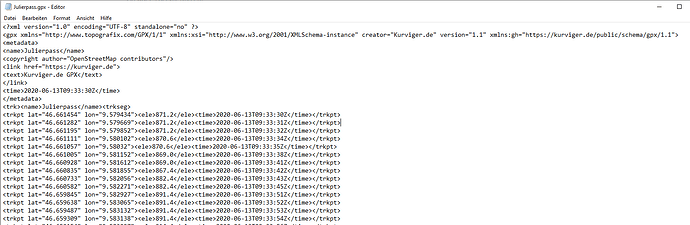

So war es bis vor Kurzem:

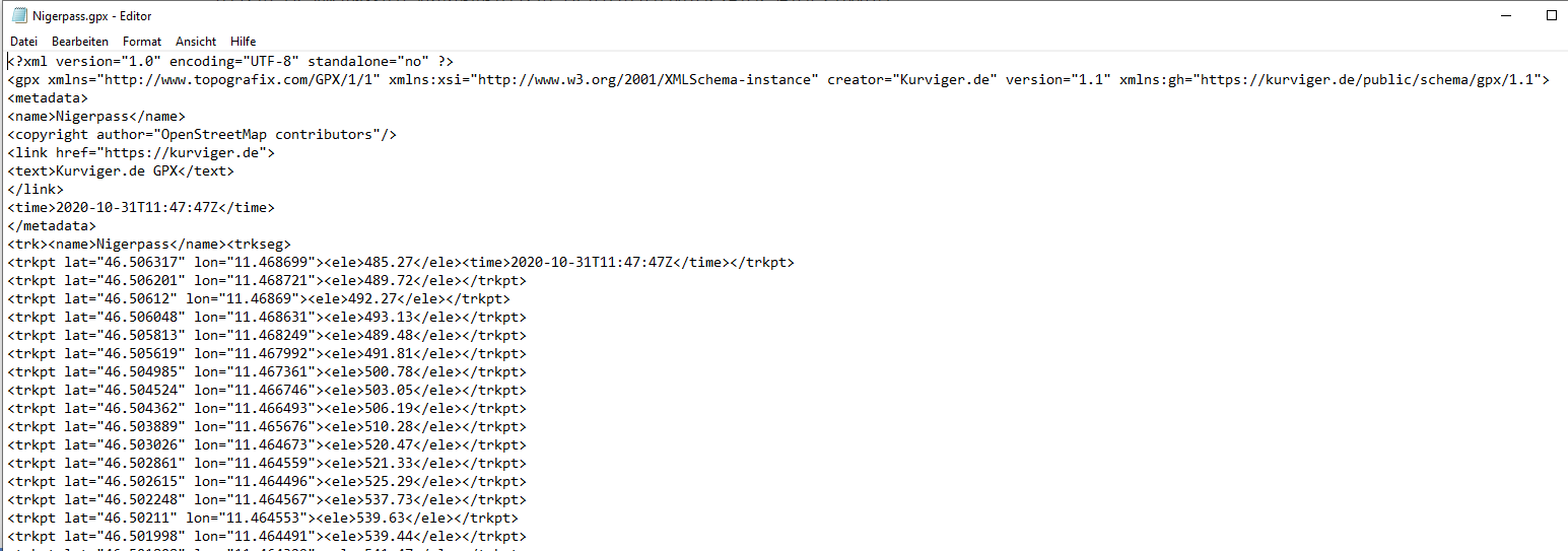

so ist es jetzt:

In July (may be August) kurviger exported a timestamp für every coordinate. Now it exports timestamps only at start and end.
For relive a timestamp is a “must have” für every coordinate.
“So war es bis vor Kurzem”.
According to the picture the attached timestamps did represent a certain speed.

In August the export was this: https://www.1000roadstodrive.com/wp-content/uploads/download/gpxl/Jaufenpass-082020.gpx
Now, October, the export is this: https://www.1000roadstodrive.com/wp-content/uploads/download/gpxl/Jaufenpass-102020.gpx
Basis for both is (and was) the same link: https://kurv.gr/CXA5F
I did more then 200 of this exports and all of them include this timestamps, generated by kurviger
