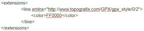

Let’s not complicate things too much.
Colors contain the transparency (#AARRGGBB).
GPX 0.2 is deprecated, like the 1.0 with the “speed”.
We need a simple implementation like above.
If users need different % scale (there is no absolute width) for each track,
please create a new topic.
“Like above”
Validation error.
No validation, Garmin rejected
Validation check by Notepad ++ plugin.
Validates

http://www.topografix.com/GPX/gpx_style/0/2/
Just checked. So it’s about gpx_style. I don’t see anywhere that this would be abandoned. And it is in use in some apps and web. Often limited to color only though.
line-styling
Extensions are extensions, it depends on readers to support them.
