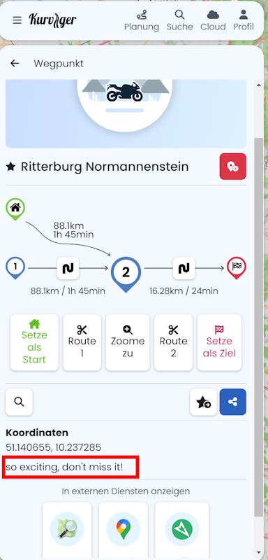

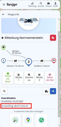

@devisdonati suggestion is probably to have a way to enter an individual text for the description.

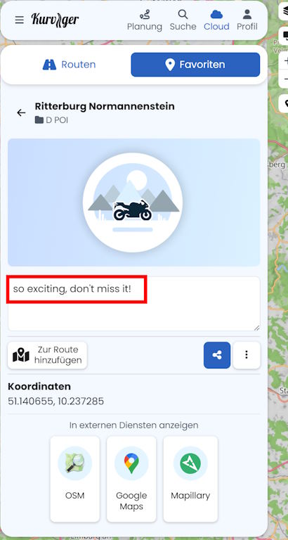

With favourites, you can enter such a text
which is even displayed when you add the favourite as a waypoint
but it’s also not exported to the description of the routepoint.
One idea is to have a new entry field at this place that can be filled/edited and becomes the description when exporting.
