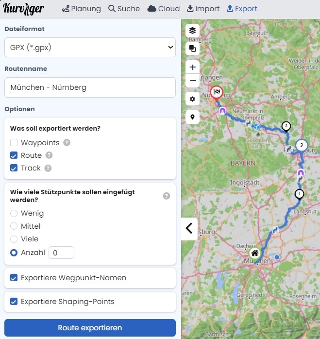

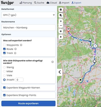

If you name your waypoints (mostly Via-Points I guess) in Kurviger the exported gpx-file will contain this information. Take this example: https://kurv.gr/SsuvH and export it with this specification:

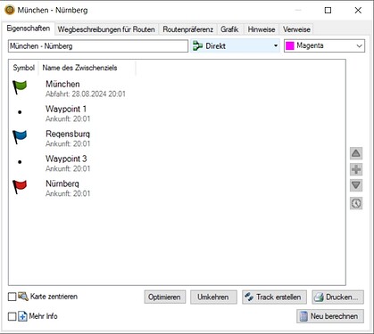

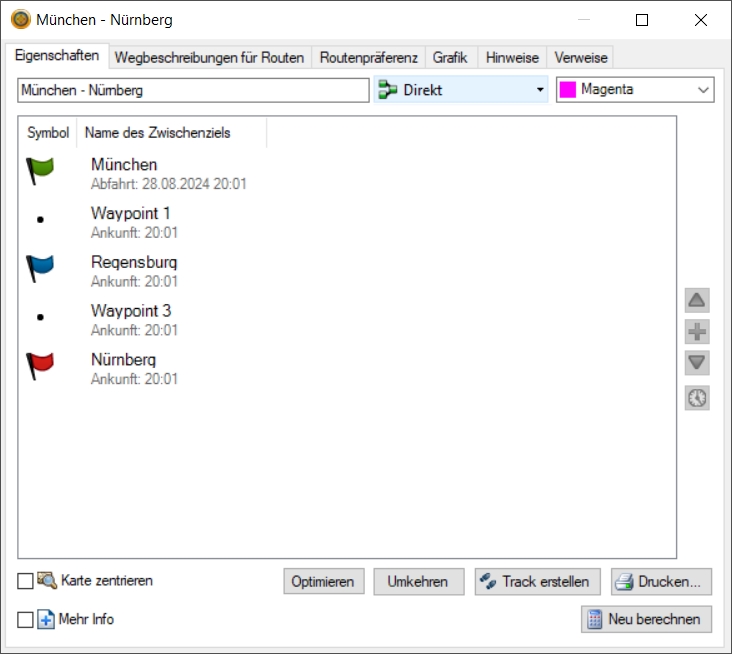

I named Start, WP2 and End by “München”, “Regensburg” and “Nürnberg” and if I import the corresponding gpx-file into BaseCamp these names are there - proven by the export out of BaseCamp: München - Nürnberg bc.gpx (539,3 KB) or by this screenshot:
Don’t know what MRA does and I’m not interested to learn it.

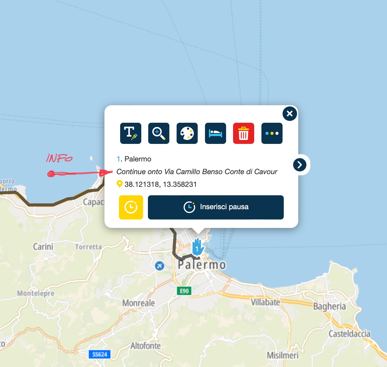

the problem is that when you go to import the gpx into the gps device, in my case a BMW CRN, in the name of the waypoint is added below what you see in red in the photo, these would be the notes that with professional software you can fill in at will that are used to help you on the route, especially if you use the tracks, go offroad etc… unfortunately here it is not clear why this field is automatically generated by Kurviger and cannot be modified, unless you import it into another software and then modify it. Some gps devices do not take this data into account and you do not notice it, others instead take this into account and therefore it is annoying to see your own WP with personalized names the addition of other names not wanted by the user. I know that for many this thing does not matter, but I assure you that it is annoying
