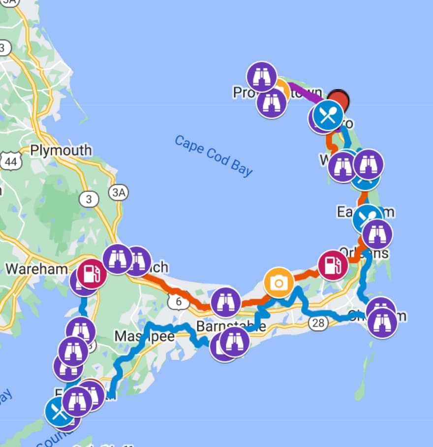

I imported a tour from a GPX file with three legs.
-Cape Loop Leg1
-Cape Loop Leg2
-P-Town Loop Option
Only the first leg with all its waypoints is displayed.
The complete tour should look like this:
How can I see the complete tour?

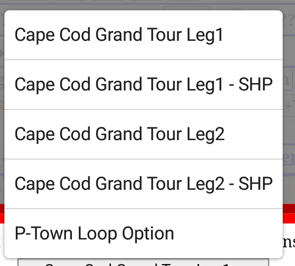

This are the routes I see with gpxshaping.de:

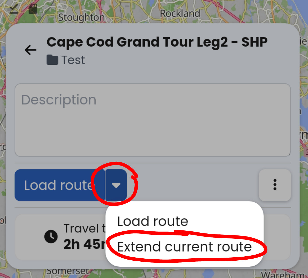

Do following for the routes “xxx Leg1 -SHP”, “xxx Leg2 -SHP”, “P-Town loop option”:
Then open the first route from Kurviger cloud. After that open the following routes with the “extend route” option:

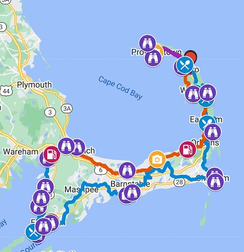

Thank you for the tip. This was very helpful.
