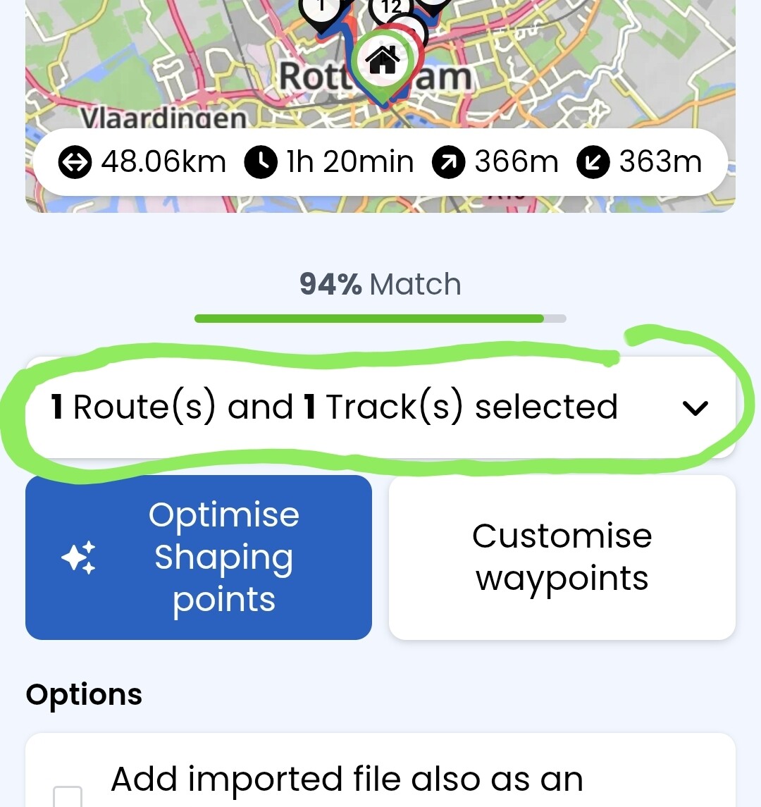

How many routes and how many tracks are there in the GPX os indicated here:
If you expand this field by pressing the “v” the right side, you will see the exact content and be able to select what you want to import - in case of your file you can inport only track, only route or both at the same time:

    Track consists of hundreds or even thousands of waypoints which are very close to each other and describe the path very precisely. To make the route out of the track, the import algorithm selects a couple of waypoints and applies the routing algorithm to them. The resulting route usually does not match the track 100% and this is the percentage that is displayed. When you press “Optimize Shaping points”, the algorithm tries to find a set of shaping points that will better match the track, when the routing algorithm is applied. Usually the percentage goes up, but I had cases where it went down, so a bit of homework is still there for developers. Downside of importing only track is that the POIs from the route are not imported and may need to be placed manually.
