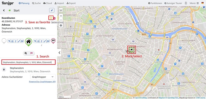

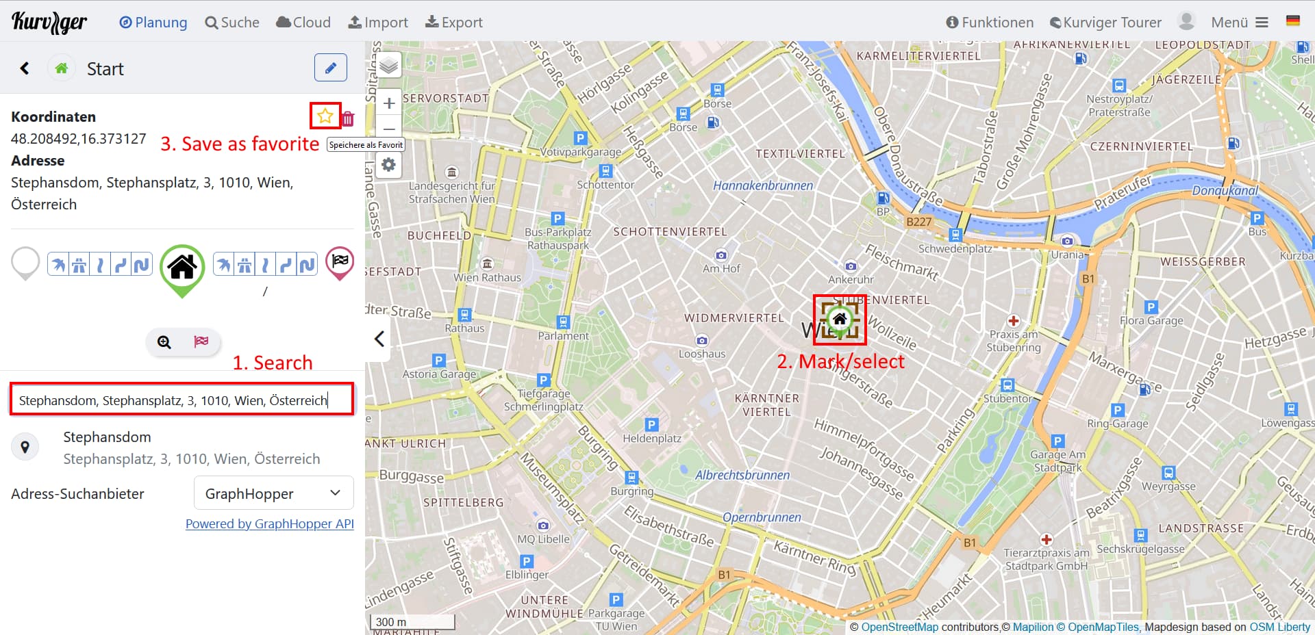

Enter either the address of your POI or its coordinate in the search box → hit [Enter] (1)
The location is shown/marked on the map → mark/select it (2)
Add it to your cloud (personal favorites) using the yellow star in the left panel (3)

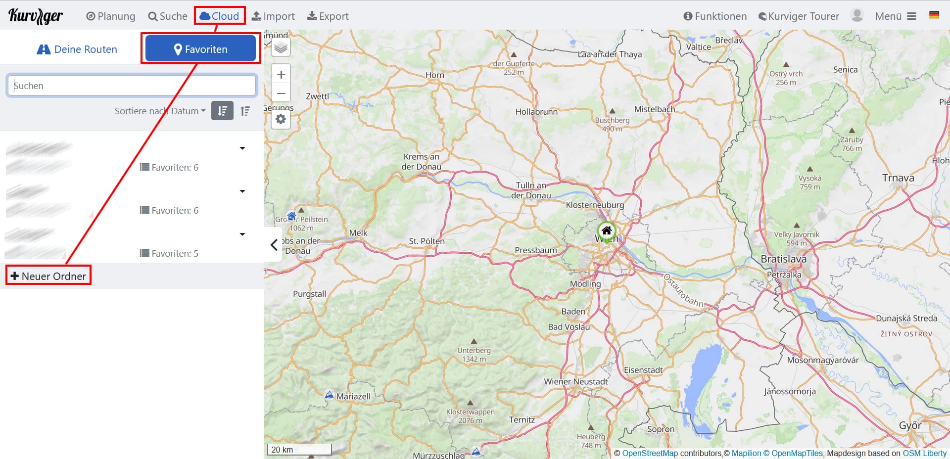

You are then asked in which folder of your cloud it should be saved.
If required, add/create (a) folder(s) in your favorites list first:
Thank you for the repsonse.
THis is what I would do for a few POI/Favorits… Now, I a have a list (in Excel) of 290+ POI which I would like to add… How do I do that in a lesse cumbersome way? :wink:
Thanky you

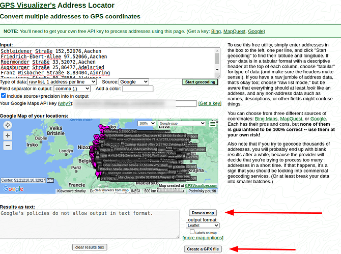

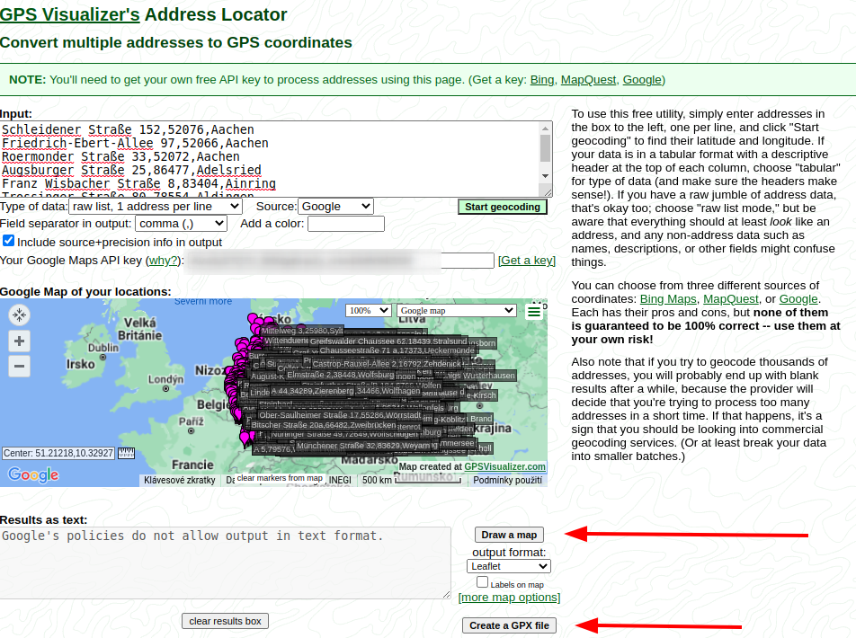

Hi @SPKELLER
maybe this might help
https://www.gpsvisualizer.com/geocoder/
I was playing with that about 5 years ago and regrettably, I did not create a kind of tutorial for myself, thus, I do not know anymore in detail…
after some exercise
:running_man: :dancer: :person_cartwheeling: :people_wrestling: :person_juggling:
… I was actually able to get my API Google code somehow
roughly according this
giving my credit card and letting brother Google charging me “0” for the trial and believing “we will not charge you” anything, until explicitly allowed…
then, I was able to use the API code in
… then made some successful trial with some addresses …
first impression trial
…you have to go for “Create a GPX file” then…
…and/or “Draw a Map” for visualisation

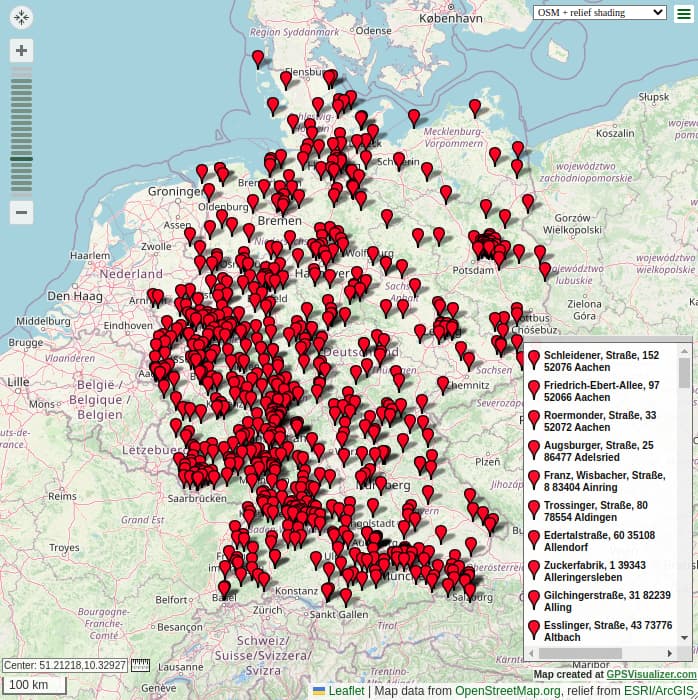

… furthermore, I took as a sample (as “A” for Aral is quite at the very beginning :slight_smile:…)
https://mein.aral.de/tankstellenfinder/tankstellenlisten
https://dccdn.de/mein.aral.de/download/201002_SuperPlus_Liste.pdf
… so, the input for gpsvisualizer.com/geocoder is as follows
aral_stations_super_plus.csv
Schleidener Straße 152,52076,Aachen

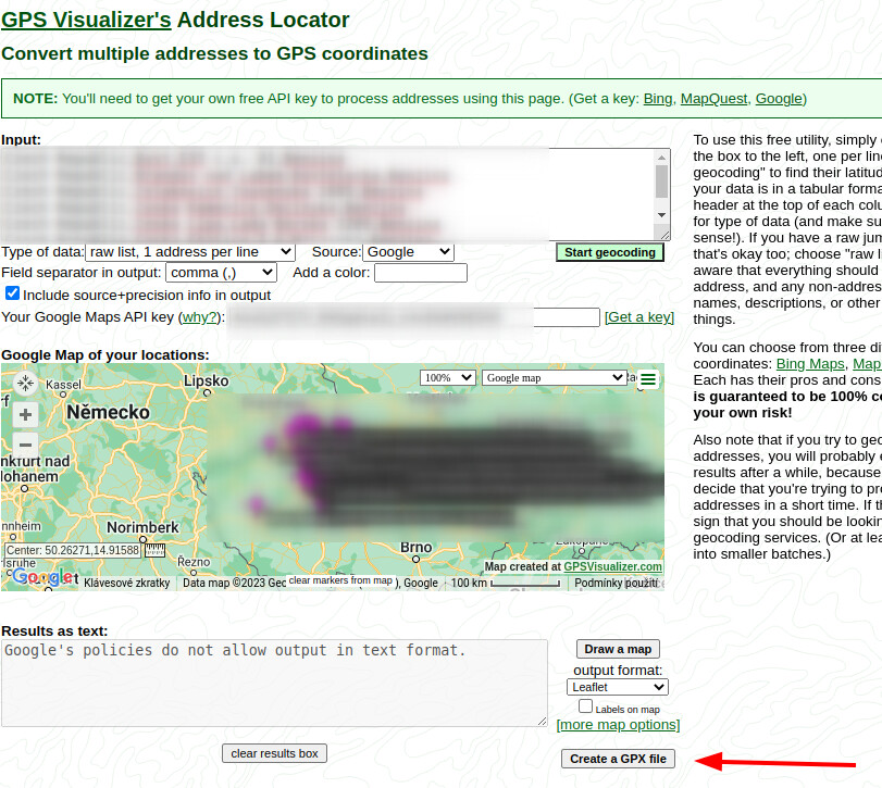

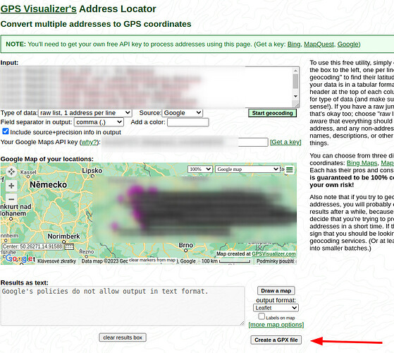

the processing in gpsvisualizer.com/geocoder took a while (minutes, actually tens of minutes)…
then, the result is
and the map-view here, just to have an idea...
… here the result on maps.cz…
and here as a gpx-file to download (102.2 KB)
… without having checked the results in depth, I think, it works quite well…

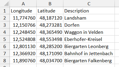

Mit routeconverter.com
Option Datei > Öffnen Excel-Datei im XLS-oder XLSX-Format importieren.
In GPX-Format zu konvertieren, Option Datei > Speichern unter - Ausgabeformat als GPX.
True!
But for this the XLS file must look like this:
TestPOI_k.xls (26,5 KB)
@zaphod_42

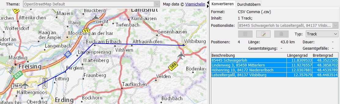

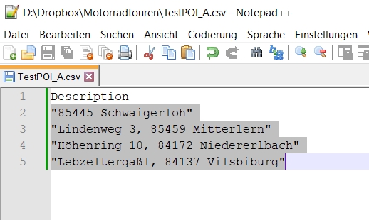

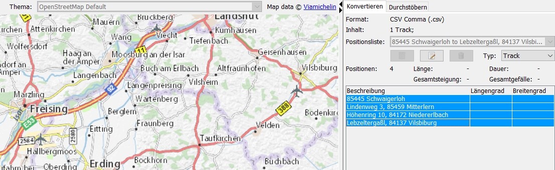

Siegfried, also here the RouteConverter can help you. Just create a .csv or .xls file with a simple structure:
Open in RouteConverter, select all:
and then let complete via Position/Complete/Coordinates:
Now you may export it .gpx file.
Klasse, wusste ich gar nicht, daß RouteConverter so etwas auch kann, obwohl auch Nutzer bin…
…erheblich einfacher als mit Google API zu spielen… :+1:
