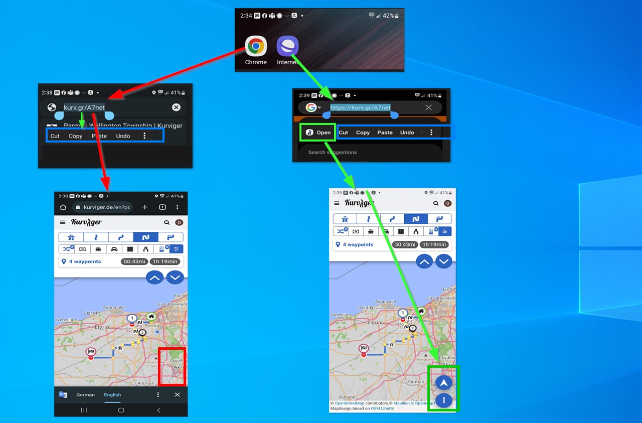

In the attached screen capture you can see my Samsung s22 ultra phone has two browsers installed “chrome” and “internet”
the chrome path is a black hole, if you launch chrome, and data entry the URL, then “Highlight” the URL by clicking it, you are only presented with “cut”/“copy”/“paste”/“undo” options. This means you have no choice but to surf to the URL and you end up simply within the website and no apparent mechanism to start turn by turn navigation.
however if one uses browser “internet”, , and data entry the URL, then “Highlight” the URL by clicking it, then you are correctly presented with an icon to “open kurviger app” as well as all the “cut”/“copy”/“paste”/“undo” menu choices. If one correctly choose the “open” option then the kurviger app DOES launch and one’s route IS presented and one DOES get the buttons to start turn by turn navigation.

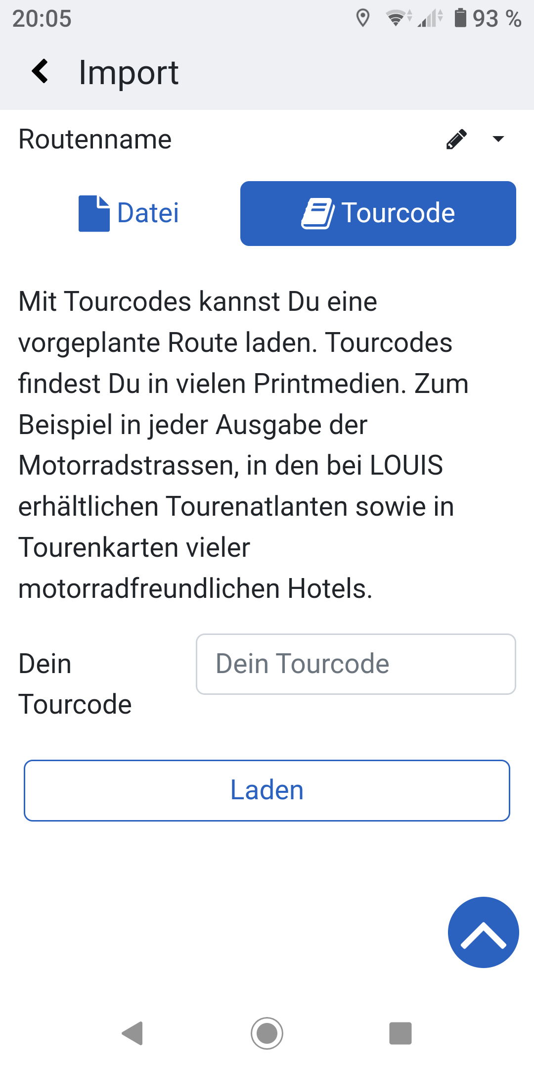

The old app used to have a panel wherein one would data entry the 5 char code, the new app lacks that feature, I have heard that it is on the low priority todo list but its been in that state since the day new app was released. As for the what is common use case I guess that depends on the circle of people riding together. For my set of people someone creates a route and produces a code. we meet up somewhere and someone yells out what today’s route is going to be at best the author printed the 5 chars on some sheet of paper affixed to a post/table so he doesn’t have to repeat himself. so for the most part I can’t count on an electronic message to click on nor a QR code to scan. in this situation the old app shined and the new app disappoints. It is also why I keep coming back to where /how do I data entry the code as to get faithful turn by turn navigation of author’s route. I am thankful that there is a path to success one just needs to know to use the correct browser to reach success. It just shouldn’t be this well hidden.

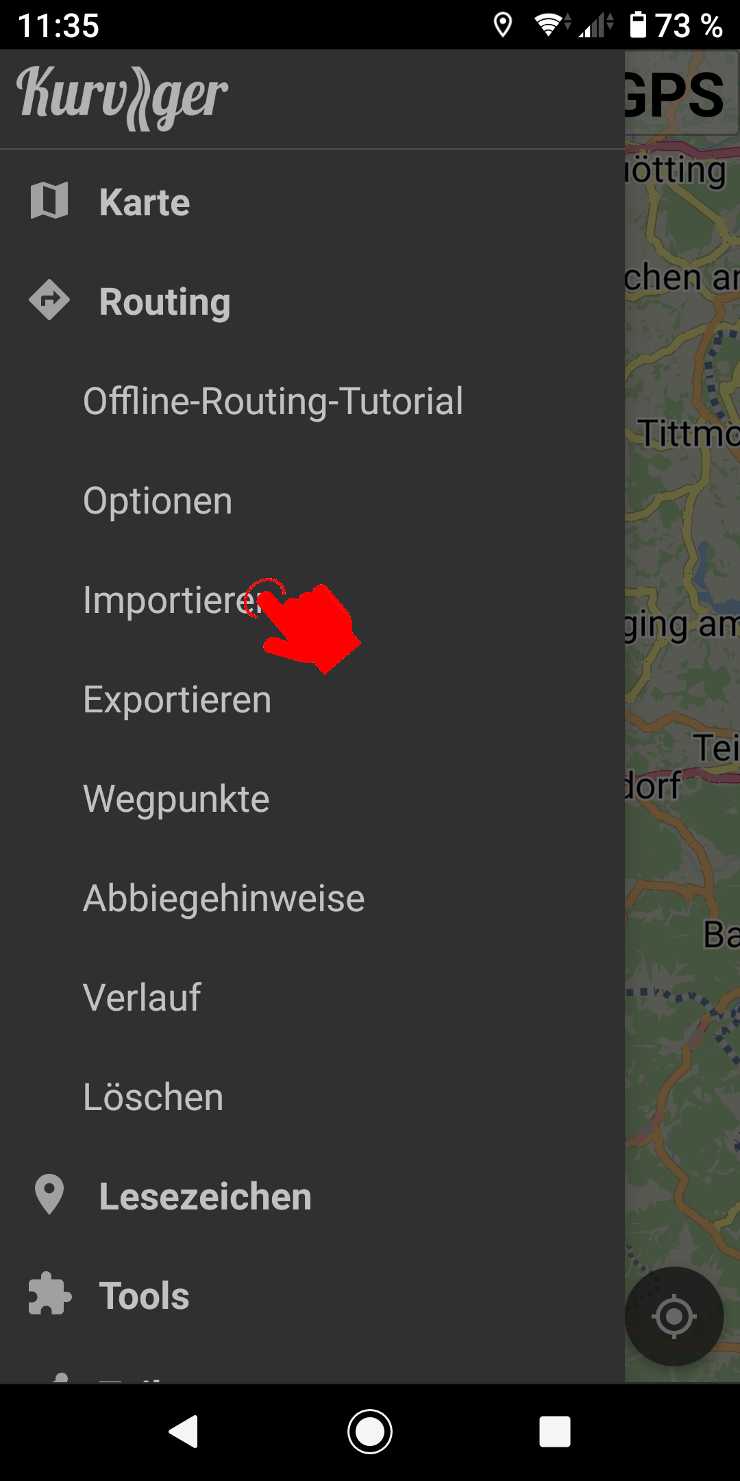

There is an option to import Tourcodes, which are published, but this is not this 5 digit code.
Left upper menu - Import - Tourcodes.
You are sharing a link, not a tourcode. I used the old app not not very long, I am not aware, that this was a feature or is a planned feature. Perhaps I am wrong?! Also nothing in the docs Route Transfer within Kurviger [Kurviger Knowledgebase]

Your screenshots - one browser opens in web, the other opens the app: As far as I know a browser opens a link always in the browser - unless the programmers of the browser give you this option. In the Samsung browser there is indeed an option for this (open link in other apps).
I sometimes post the link in messenger app to myself and open the link from there, the app opens.

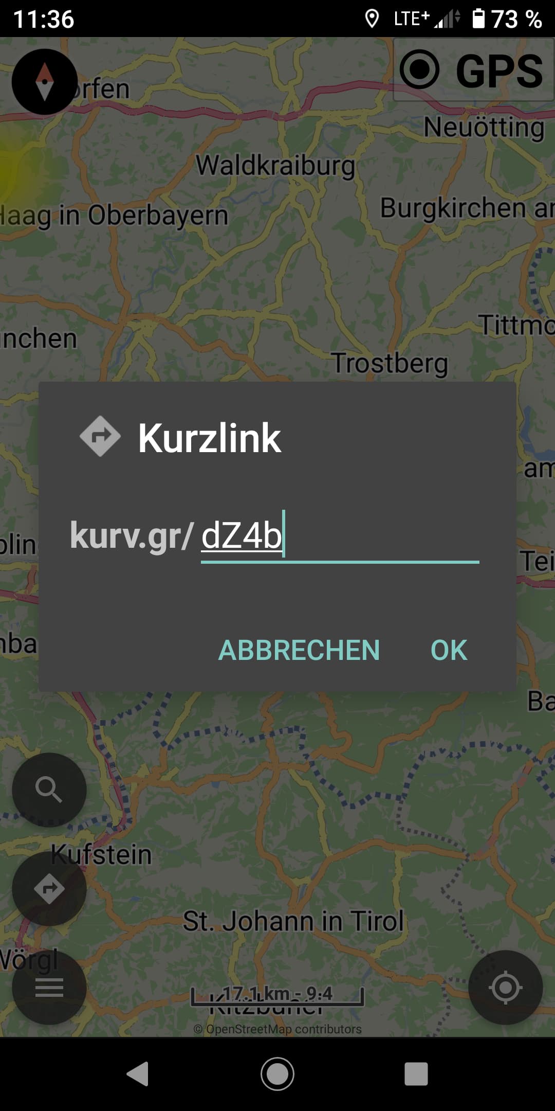

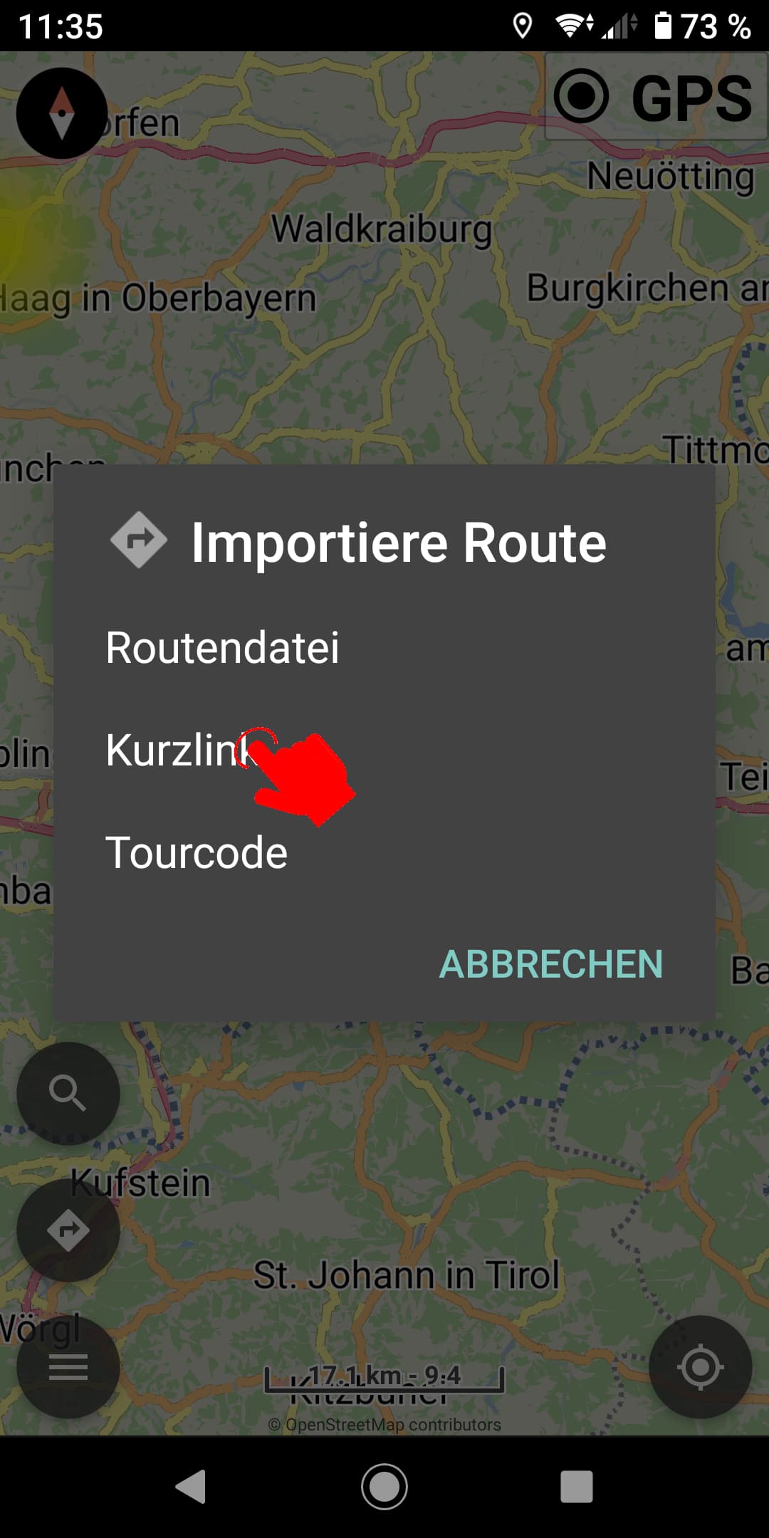

I agree and we are not planning on removing these. BUT, these are short links, and not 5 char codes :wink:
I fully agree that we need a way to enter a short url on a mobile device and make it easy to navigate this route with the app. And right now this is not fully supported, only through workarounds (like saving in the cloud or exporting .kurviger file).
My main concern is, if it should be in the app or if this should be a browser workflow. As it is, I still believe a browser workflow (like a button showing that you can open this also in the app) would be the approach that solves most cases perfectly fine.

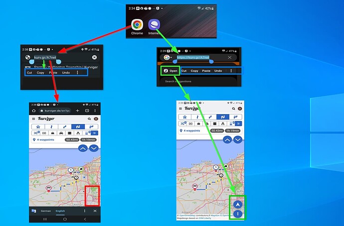

I do understand that some of you have really strong feelings about this feature. Maybe you could explain how you are using it and why. For example why did you enter the short link the last few times yourself?
But you would like to type the 5 characters?
Thanks for providing this use case. For random routes, that you only want to open for testing, using the cloud would indeed not be the right option. So in this case, having the option to only enter 5 characters vs. kurv.gr/ + 5 characters (so 13 in total) + pressing a button to open the app would be indeed better.

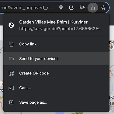

An alternative would be still to send the link electronically to your device, for example Google Chrome can share links to other devices.
You are staking a valid position and I commend the thought.
However back in March 2020 you completely understood that the short link was designed for human consumption before it reached the level of machine consumption.
You understood this so well that you went out of your way to change the code base as to make sure that 5 characters generated did not stress the eyesight of your user community.
Because of your efforts the short link correctly does not contain…
I1l
O0o
ij
Here is a link to the above effort…
Within this thread several forum users have provided examples how they use 5 char short codes.
These examples are how your user community are actually using the codes. Some of us have log books where 5 chars describe what we did today.
Maybe all of us are using short links wrong. You are correct there exists electronic paths to avoid writing down 5 chars or speaking 5 chars but sadly some of your user community still touches paper or heaven forbid talk to each other vs texting. For us, we appreciated the codes both being short and containing characters our eyesight can discern.
I kinda feel you have seen how the codes are being used even if that use not the way you use them
Implement this how you want, I and others are trainable rats.
you might as well simplify the website even further and eliminate the logic on code generation to avoid certain characters, in fact why restrict links to just 5 chars eventually you will run out of name space might as well just generate a 128 bit GUIDs instead and end users will be forced to abandon our paper, our log books and 1-on-1 conversations with others.
