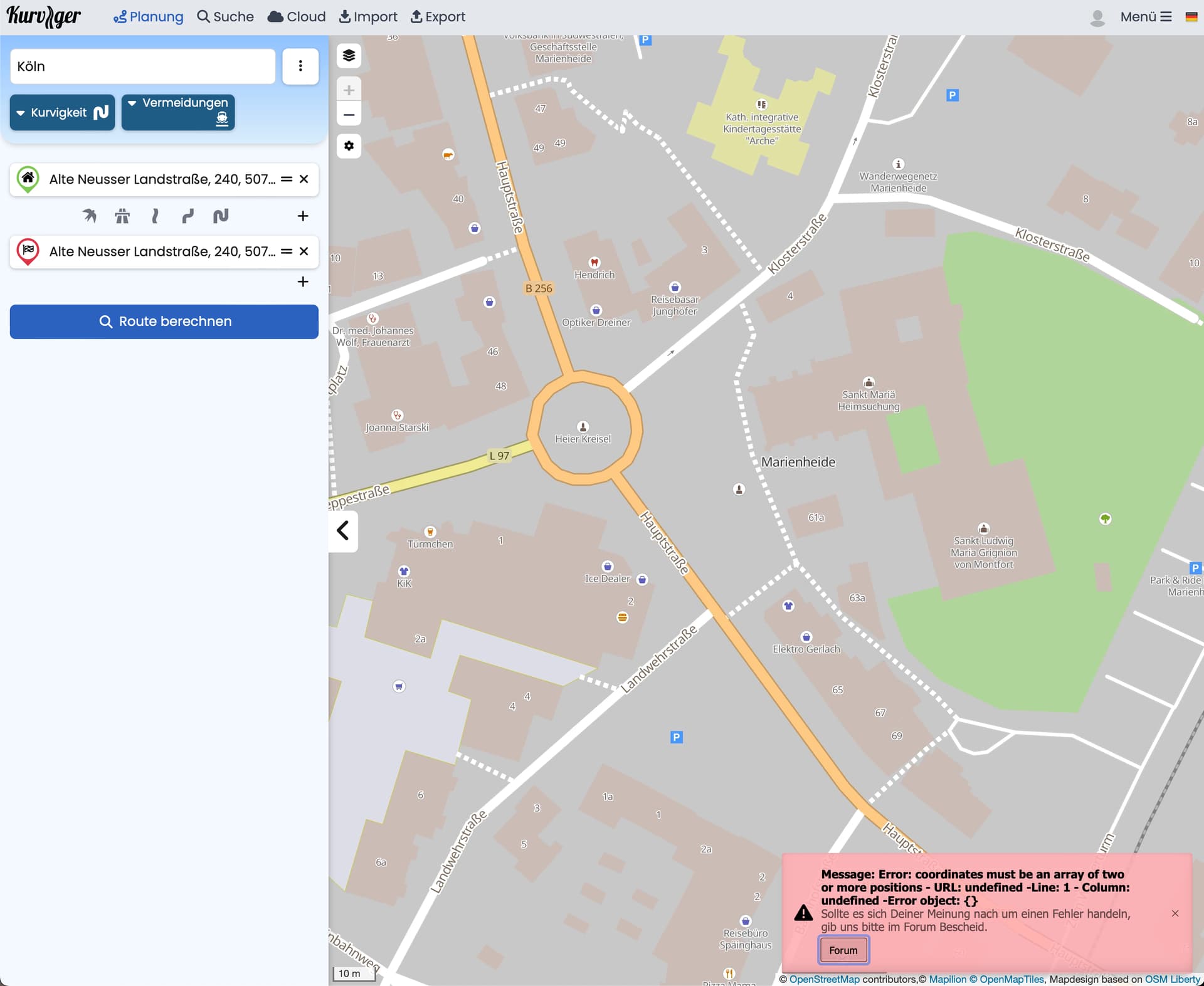

I'm not able to add points to a route
Message: Uncaught Error: coordinates must be an array of two or more positions - URL: undefined -Line: 1 - Column: undefined -Error object: {}

sure - easy: create a new route with a start and an endpoint. klick on a point in the map and tried to add a shaping point.

yes - right click - I can reproduce the error everytime - switch the Browser for the test, this time Safari:
P.S.: I deleted all local data in the browser (Cookies…) - no change
P.P.S.: you need to set an identical start and finish location and then add the shaping point. Since there is no route so far, this will cause the error
That is the cause.
If start and end are identical you don’t have a route at the beginning.
In this case you may want to start with the round trip option.
