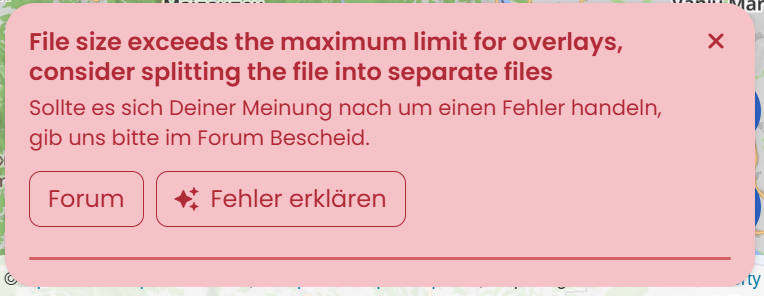

Import Campsites Overlay from Campgrounds web site fails
File size exceeds the maximum limit for overlays, consider splitting the file into separate files

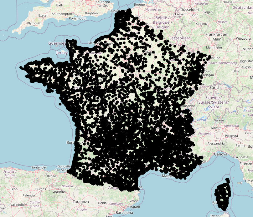

It appears that there are well over 9000 campsites (worldwide, even in French territories overseas) in this GPX file.
In GPXsee, it looks like this:
I am not sure how you can manage and use this amount of data efficiently in Kurviger. You would have to split it in over 30 favourites folders to have them all imported (one folder is limited to 300 favorites).
Using overlays also does not work as one file:
The exact file size limit is not stated in the error message, but when I split it into two, I could load them as overlays.
