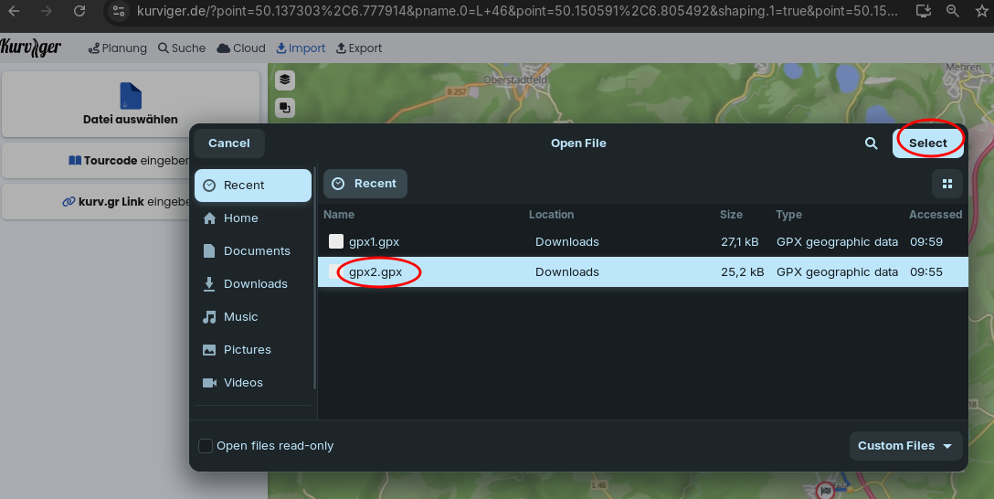

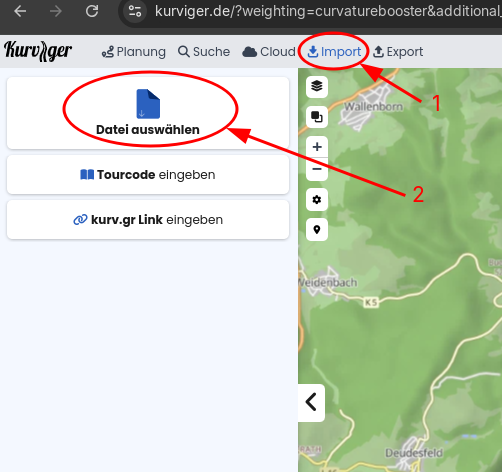

You may import the first GPX and get then the route ready to ride in Kurviger. If you want to enhance the first GPX with the second GPX to merge both files this is possible, but not automatically. Here is how it works:
Then you see a preview of the 1st gpx file to be imported

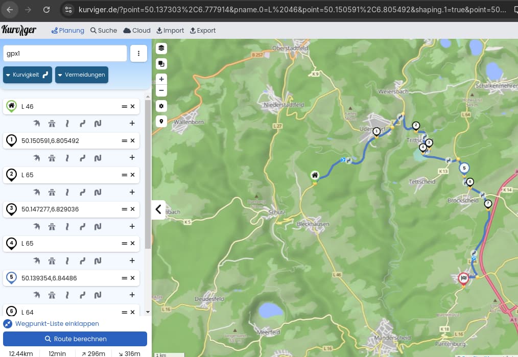

Click on import and you have the first part loaded in Kurviger
Now you want to extend the loaded gpx1 with the gpx2. You click again on import

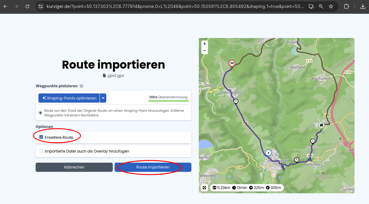

and chose option ‘extend route’:
Then you have merged both routes and can use the new route for navigation:

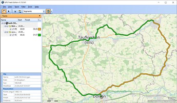

This indicates that it is one GPX file that contains two TRK sections.
I have created a test file that illustrates the situation: both (50,8 km).gpx (108,8 KB)
In GPS Track Editor it looks like this:
GPS Track Editor, BaseCamp, Calimoto and Cruiser have no problem with this file. However, the import into kurviger.de does not work, although the entire track is displayed in the overlay - try it out.
