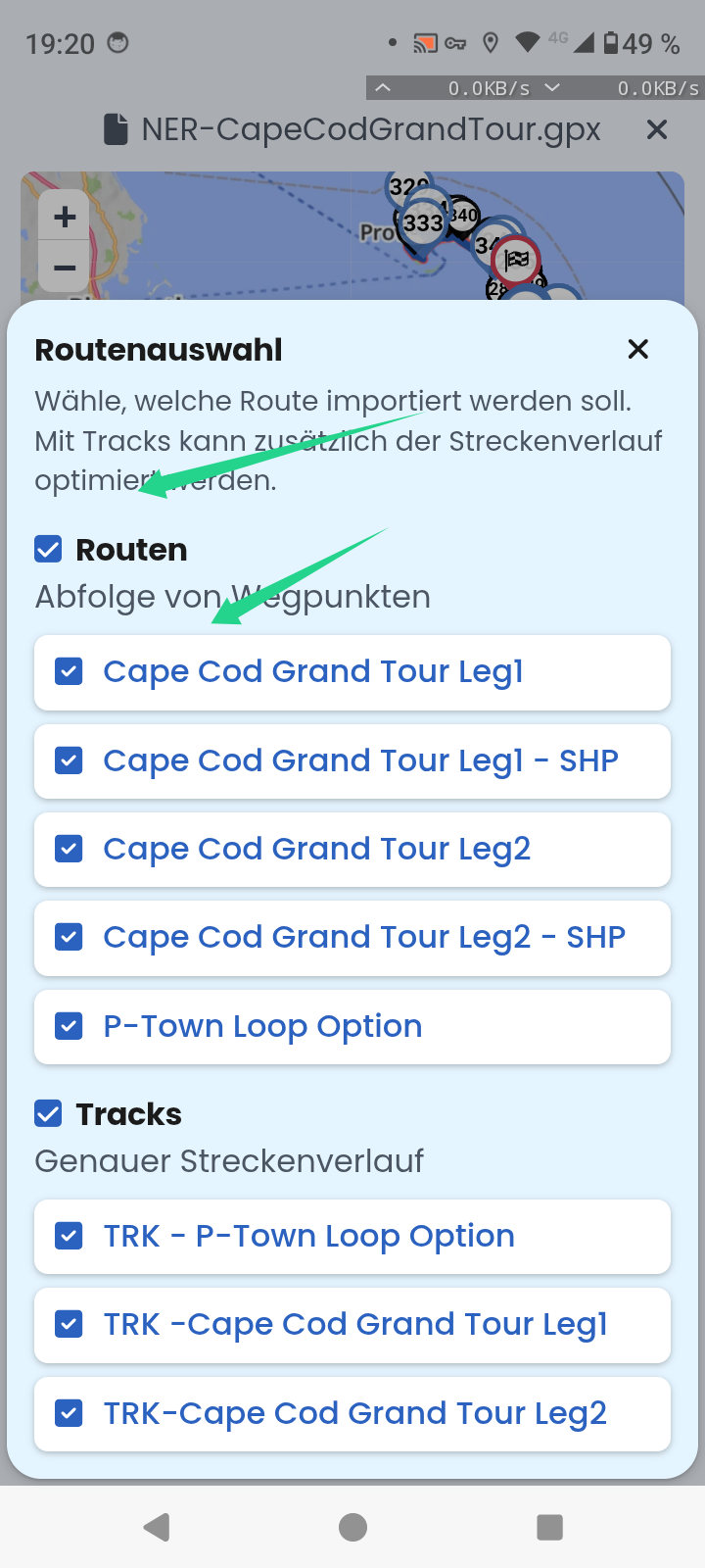

You should see this. Click.
A list of included waypoints, routes and tracks are shown. De-select / select what you need.

I do not know how other software are handling auch packages. You see in my screenshot, that the numbers of routes and tracks are not equal, some want only the tracks, others routes. If you have an idea, always welcome.

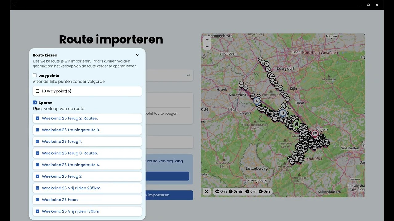

I created a little screen recording.
I had been experimenting with another file last week.
With the two first routes of the file I used today the conversion is perfect. So no complaints there.
But as you can See I need to do it one by one.
I would like to see that you select multiple tracks, a folder where they need to go and settings like optimisation. And the import is then done for all selected content.
Just Noticed that the name for the individual tracks are lost in the process as well.
So in addition to do it in one run the original names of content should be used as ‘Name’ field in the folder
