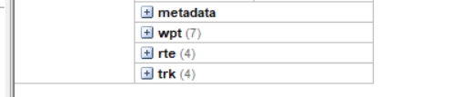

Its a file who is working by Komoot.
Buurse Weekend 2024(2).gpx (3.5 MB)

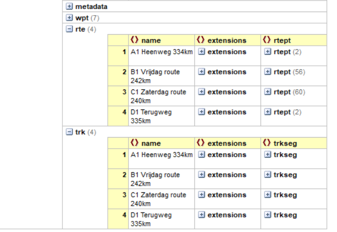

The file contains 4 routes and 4 tracks. This could be the issue.
That GPX is in Garmin format. Workaround: Open it on gpxshaping.de, select desired route, save it as GPX only with track and import it in Kurviger.
Result for 1st route: https://kurv.gr/TudEM
Man kann auch direkt von Basecamp die GPX Dateien einzeln exportieren.
