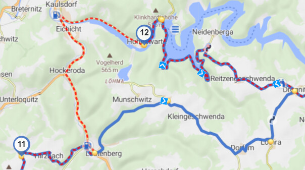

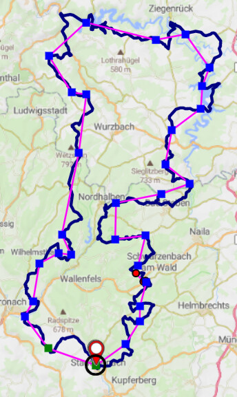

If you import it in Kurviger, only the route points (tag <rtept>) of the GPX are used (as kurviger waypoints) - to show that, I imported the GPX only as overlay in Kurviger (1st picture). But there is much more info in the GPX, you can see that if you open that GPX in gpxshaping.de (2nd picture): The magenta line shows only the connection between the route points, the blue line shows the additional info contained in Garmin specific extensions:
You can export a new GPX from gpxshaping.de (it contains the blue line as track) and import that in kurviger, so you can see also the “track” hidden in Garmin GPX extension before:

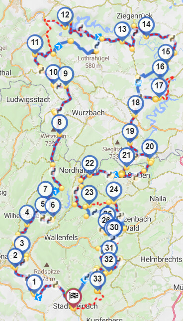

As you can see, there are several differences between the Garmin route and the Kurviger route - you can fix that by adding further waypoints, for example between #11 and #12:
