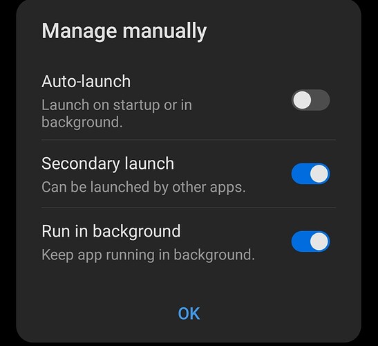

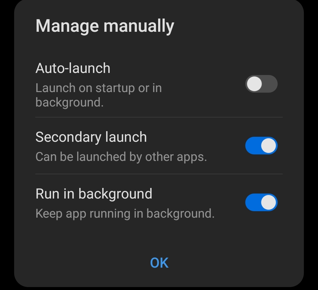

Yes, the location marker changes position, but no longer stays centered on the screen.
Current settings for the app.
I can try to set it manually then see if that fixes it next time I use the app.
Was out driving yesterday and setting battery optimization manually fixed the problem :slight_smile:
