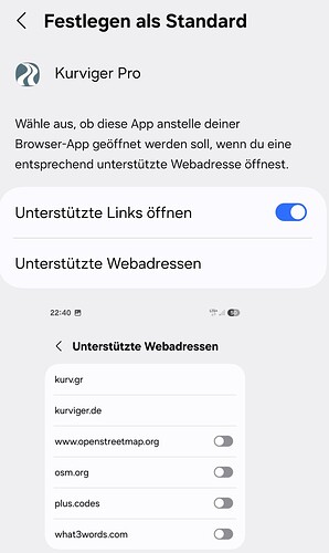

Gehe auf deinen Home-Screen.
Klicke lange auf die Kurviger Pro App.
Klicke auf das Info Symbol / App Informationen.
Scrolle runter zu Standardmäßig öffnen.
Aktiviere den Schalter Unterstützte Links öffnen.

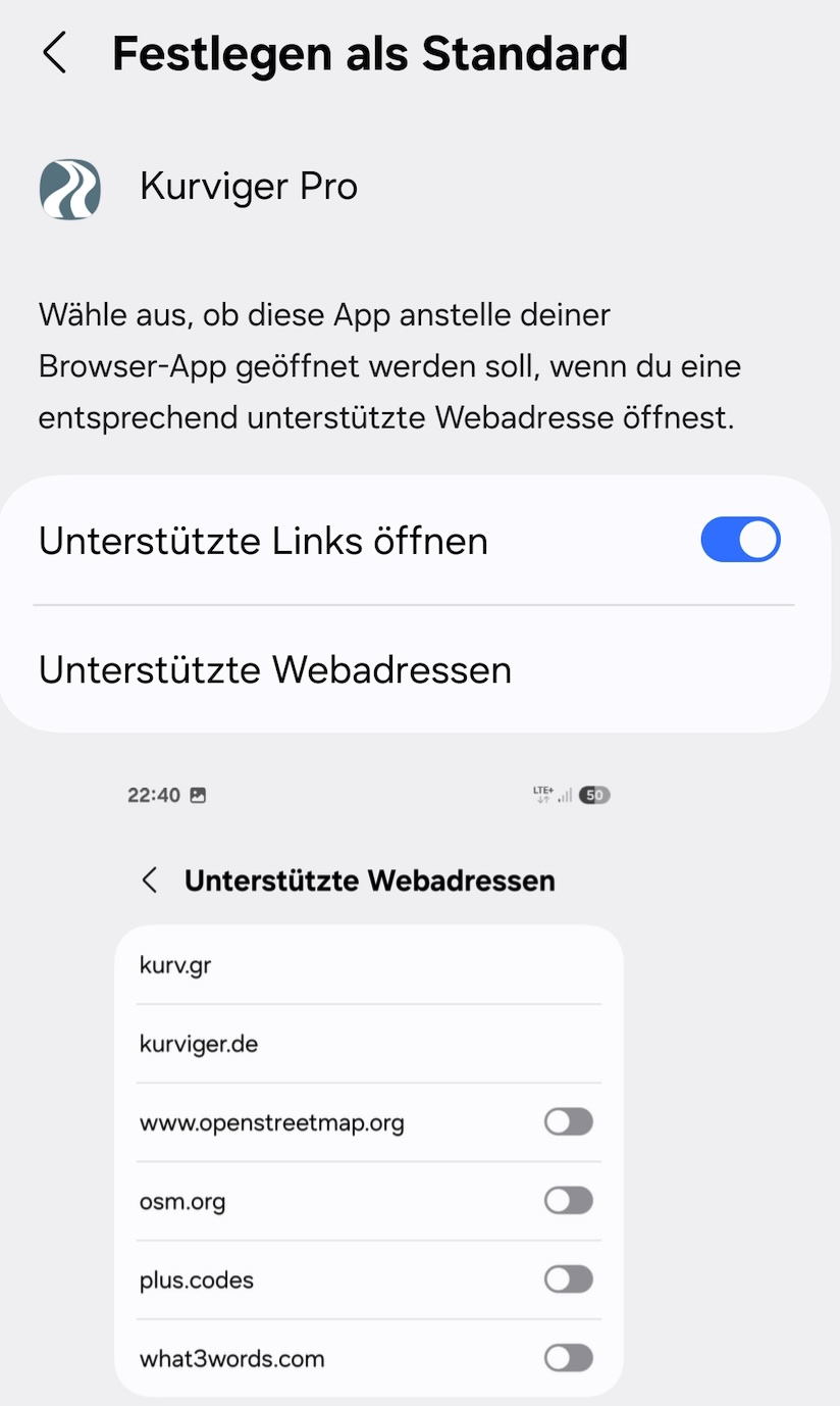

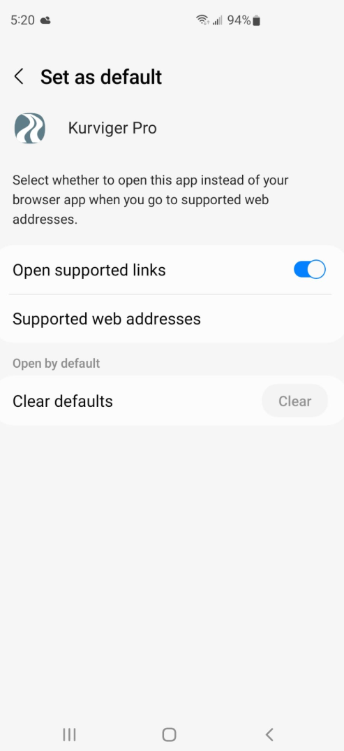

As I mentioned, this issue only occurs with new routes—they open in the browser, while all my older routes open correctly in the Kurviger app. See the attached screenshot; “Open supported links” is enabled.

The old Kurviger App (Version 1.xxx) probably only automatically opens kurviger.de Links.
Kurviger recently switched from kurviger.de to kurviger.com.
So old Kurviger App probably will not open automatically new links pointing to kurviger.com.
But you can open them using the “import shortlink” function in K1.

Yes, you’ve correctly identified the cause of the issue. Older versions of Kurviger do not recognize kurviger.com and instead open links in the browser rather than the Kurviger application.
