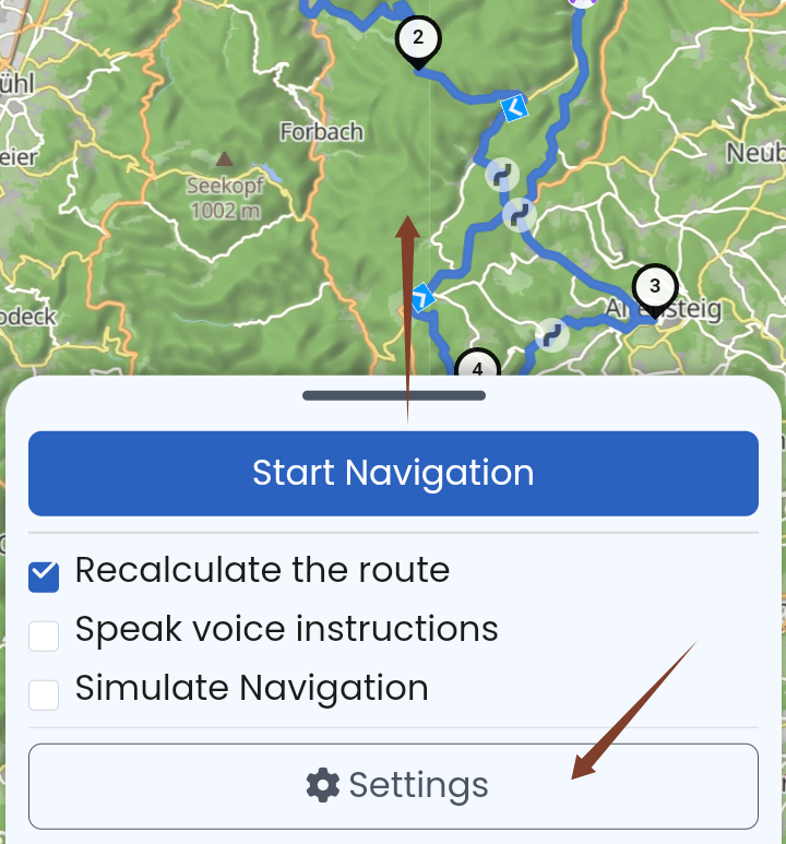

Just as hint. I think it is extremely useful and I check this nearly every time.
When you start the navigation and pull the drawer you see some often used settings and a shortcut to the settings menu.
