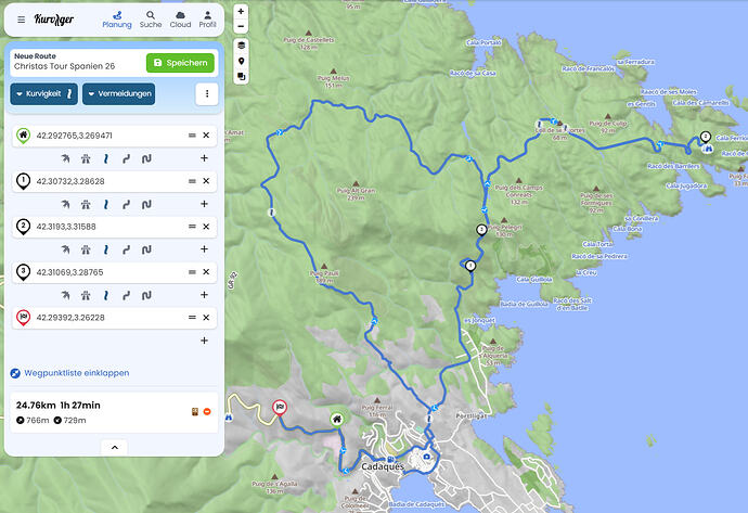

Kurviger doesn’t want to take the same road back and forth to Cap de Creus! It’s dead set on taking an off-road route on the left that is blocked off at the top by a barrier. Even shaping points don’t help. Even when I set unpaved roads avoidance to 5, it doesn’t care at all.
Can anyone find an explanation?

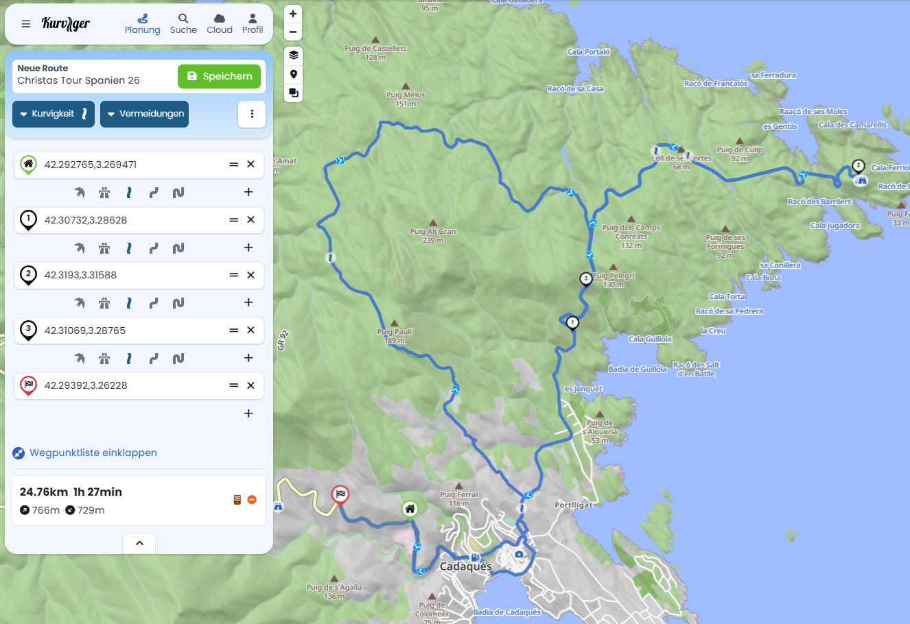

In the browser, it looks like this:
No indication of a closure, no off-road label. I’ve cleared the cache.

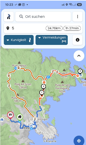

On mobile, it looks completely different:
btw: The road was still being driven on yesterday, in both directions.

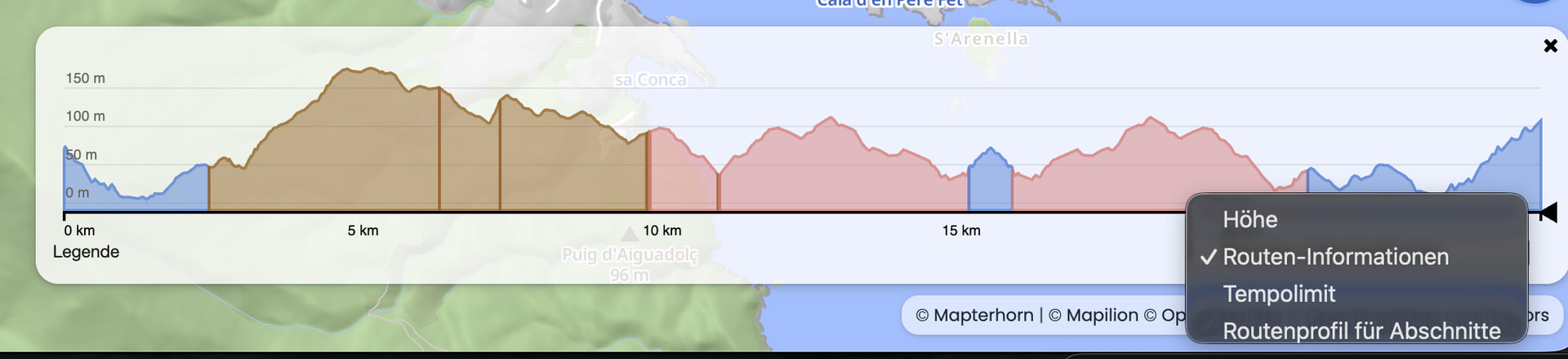

Do you perhaps have route information turned off?

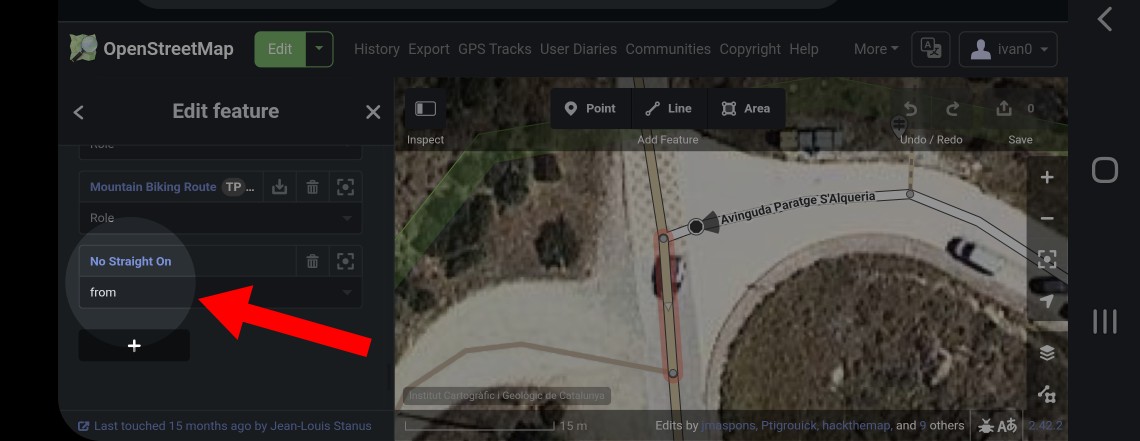

„no straight on“ seems to be the cause – even in BRouter.

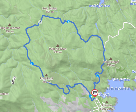

But the real problem is this:
So, park the motorcycle and walk. It’s only 3.2 miles (or 3.0 miles on what’s presumably the tougher hiking trail). :wink:
MAN! Yeah, I had it set to “Elevation” because I changed it for another forum post and forgot to change it back! Thanks for pointing that out!
